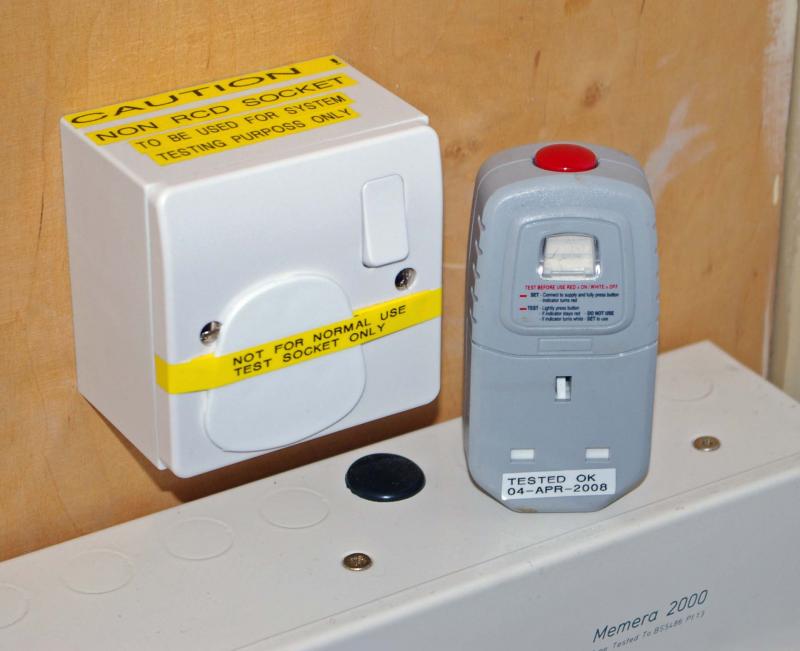

I would like to have a single Non RCD protected socket in my house. This will be use purely for testing purposes, predominantly periodic testing of RCD plug type adaptors.
All of the socket outlets in my household are currently RCD protected from a split load CU.

I have two (blanked) spare ways on the non RCD side of the main CU.
Obviosly the easiest and most straightforward method is to fit a new MCB and create a short radial circuit with a single surface mount socket outlet at the end, this socket would be located right next to the main CU in the electrical cupboard.
Any other safe and practical suggestions ?
Can i use any of the existing cicuits or MCB's ?
I'd just stick a new MCB in and a short radial to the socket. Is it likely to be used to supply portable equipment outdoors? If so, label it not suitable for this purpose.

New MCB & Short radial does seem like the most 'proper' option.
This won't be getting used for portable or outside equpment . It will be purely used as a test socket.

I would suggest a seperate circuit put through a key switch (MK Fish Key type) and suitably labelled.
If you want you could use a double grid plate with a key AND a momentary push to make 20A DP switch in series. Then you could only have power when both the key switch and the push button is operated.

I decided to fit a very short 4mm T&E radial connected to its own dedicted B16 MCB at one end and a standard MK socket outlet at the other.
With the MCB selected off, a kiddy proof socket blank fitted, and a couple of warning labels stuck on, plus the fact that the socket is near the floor in the electrical cupboard hopefully folk will get the message not to touch.
I will keep an RCD plug adaptor nearby just incase anyway, i can use this as my Calibration checker too, which was mostly the idea behind this thread anyway.
