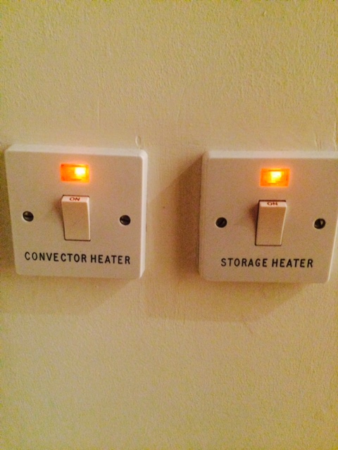

Can you help please? I have moved to a flat which has three Creda storage heaters - model CNT24FW - which also have fan heaters at the bottom (and the only button on the heaters themselves is the boost button for these). I have programmed the Credanet controller which has 3 zones and I have programmed the temperature for each day and on/off times. Unfortunately the storage heaters are not storing heat and are stone cold. The fan heaters however are working. All wiring/connections in the electrics cupboard looks fine. There are two switches next to each heater - one for storage and one for fan. At the times the heating is not programmed to be on, both of these are lit with a neon light. When the heating should be on, the storage light goes out. I have no technical knowledge but am sure I have followed the programming instructions to the letter. What am I missing please? The only thing that was not right was that all the switches next to each heater were turned off by the previous tenant (whereas in the Credanet manual it says these should never be switched off to keep the circuit intact).

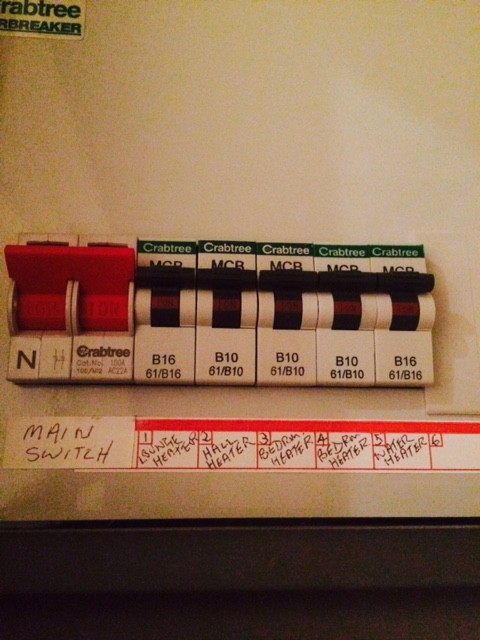

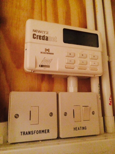

As to the neons on the switches, that is a little strange, maybe some photos might help? Of your fuse board & meter and the switches by your heaters
Thanks - will try that. I know it sounds terrible but I don't know my tariff! I will find out tomorrow. But I thought, regardless of that, the settings for the timer are supposed to be the settings for when you want heat. They are not supposed to be settings for when you want heat to be stored. Or at least that is what the manual said! It doesn't say anything about setting the timer at off peak times. I have attached photos for info - I hope they are visible!

Without knowing for certain if you are on E7, it's hard to be definitive, but from the first picture you posted, it's likely that either the flat was at one point, or probably still is on E7.
The idea behind it, is that because demand is lower at night, the utility company charges you less for your electricity for 7 hours overnight (times can vary due to BST). And the idea behind storage heaters, is, to utilise this cheap electricity, by heating up a big ole pile of bricks inside them overnight, and because bricks retain heat (reasonably) well, they stay warm for most of the next day.
I imagine the idea behind your boost button supplying the fan is to give you a quick blast of warm air from inside the heater, which is why this is wired to a separate supply.
Set the timers to 24/7, and then report back if you're nice and toasty in the morning
