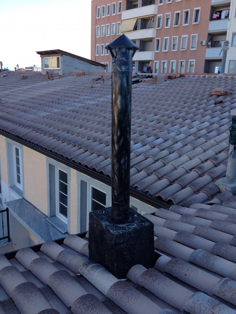

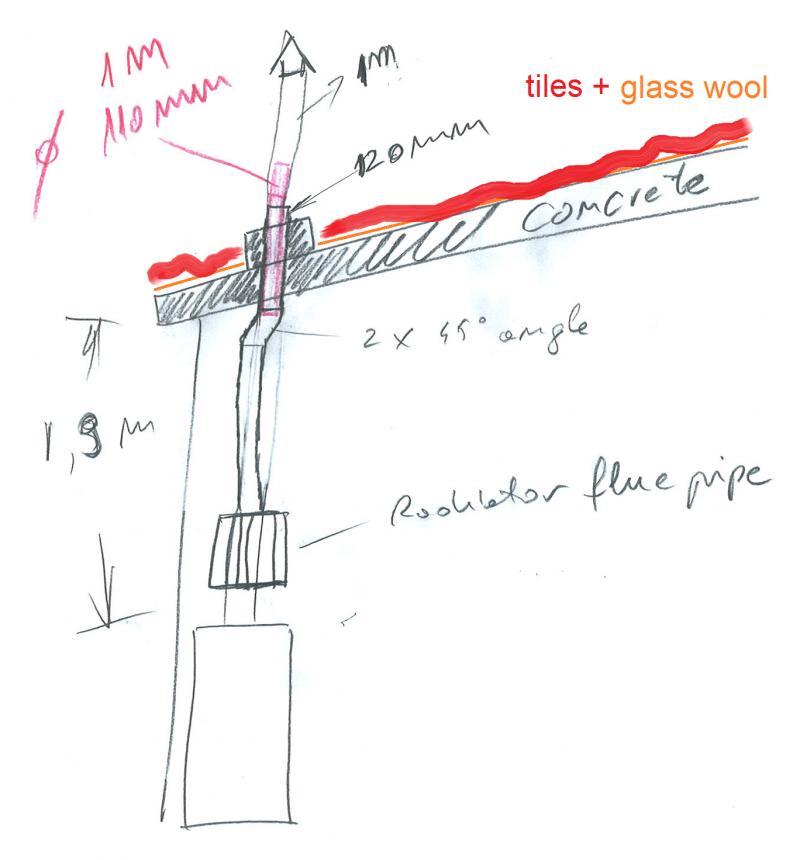

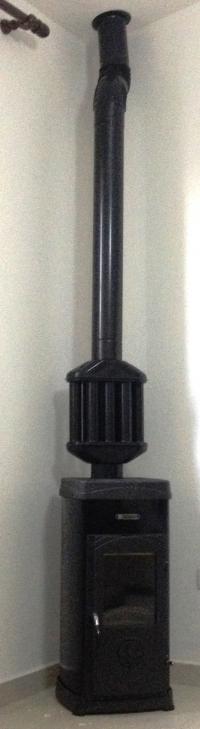

hello
I installed a wooden stove 6 kw with a vertical 1,9 m stove pipe (120mm diameter) directly to the roof (concrete+roof tiles) + 1,5 stove pipe above the roof. (La Nordica Max 6 kw panoramica)
30 minutes after starting to burn it is condensing and getting creosote inside everywhere like liquid.
i tried to insert another 110mm pipe inside the outer part of the pipe (starting from the concrete part to avoid the cold )
now it is normalized somehow but still has some minor leakages
[/img]
I cannot thermoisolate hte pipes because it is fixed with concrete and it is 120 mm diameter.
any advice will help me
thanks
I was going to point you to Part J of the building regulations, but realised you are in Albania ;-)
The part of the flue outside the building ought to be be twin-wall insulated pipe, to avoid the very problem you describe...

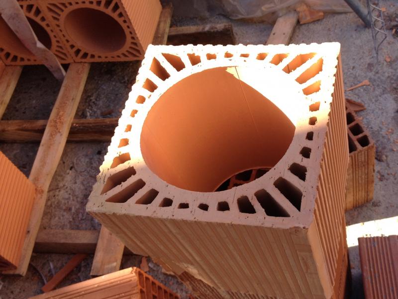

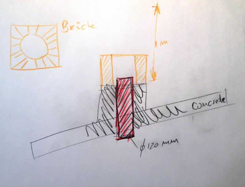

I will add also these tiles to ensure better weather insulation
maybe if I add a spinning cowl it will suck more smoke ??[/img]
can i remove the 120 mm diammeter pipe outside and build a new chimney with tiles (bricks ) 150mm diammeter ??
or it is not helping me with the condensation ??
