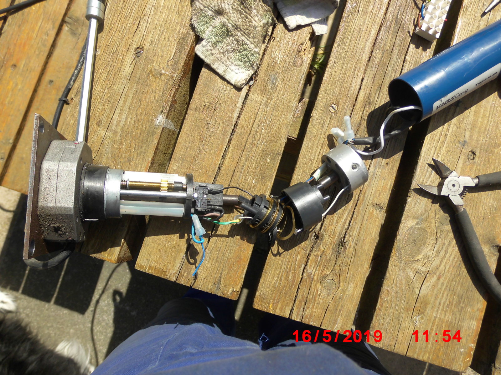

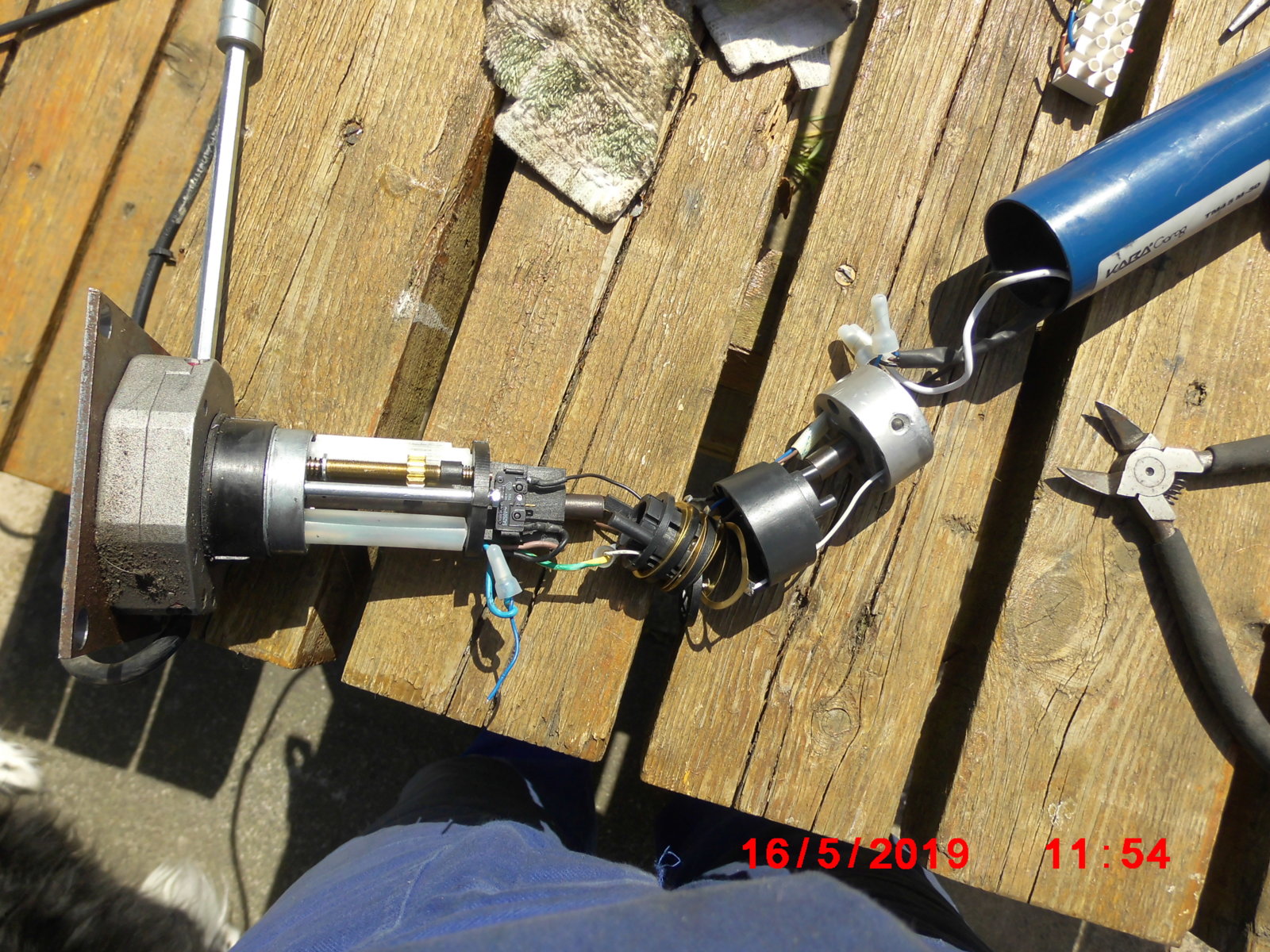

First image is the manual crank and its gearbox on the left, followed by the limit switch section, then 'slip rings' feeding through to the motor and capacitor still in the hidden in the blue tube section. The broken shaft is down the middle, half in the left half on the right through the brass washer 'slip rings'.

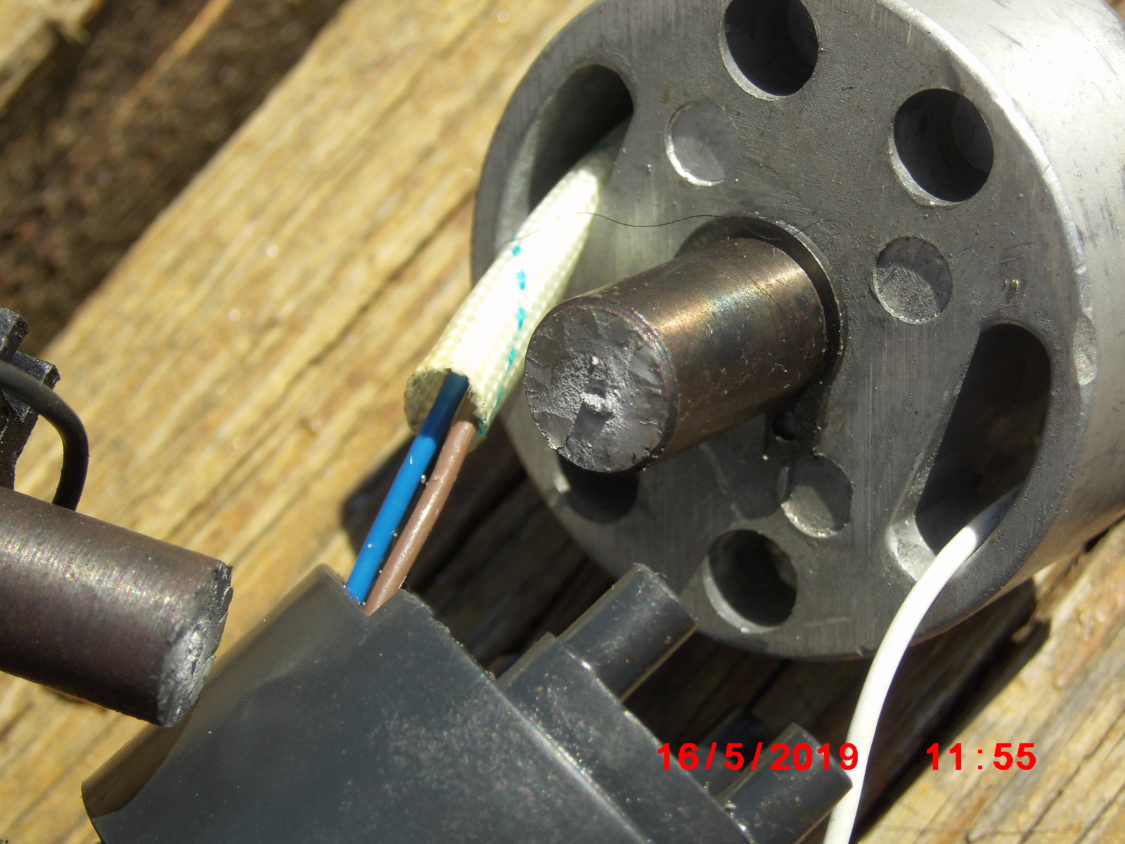

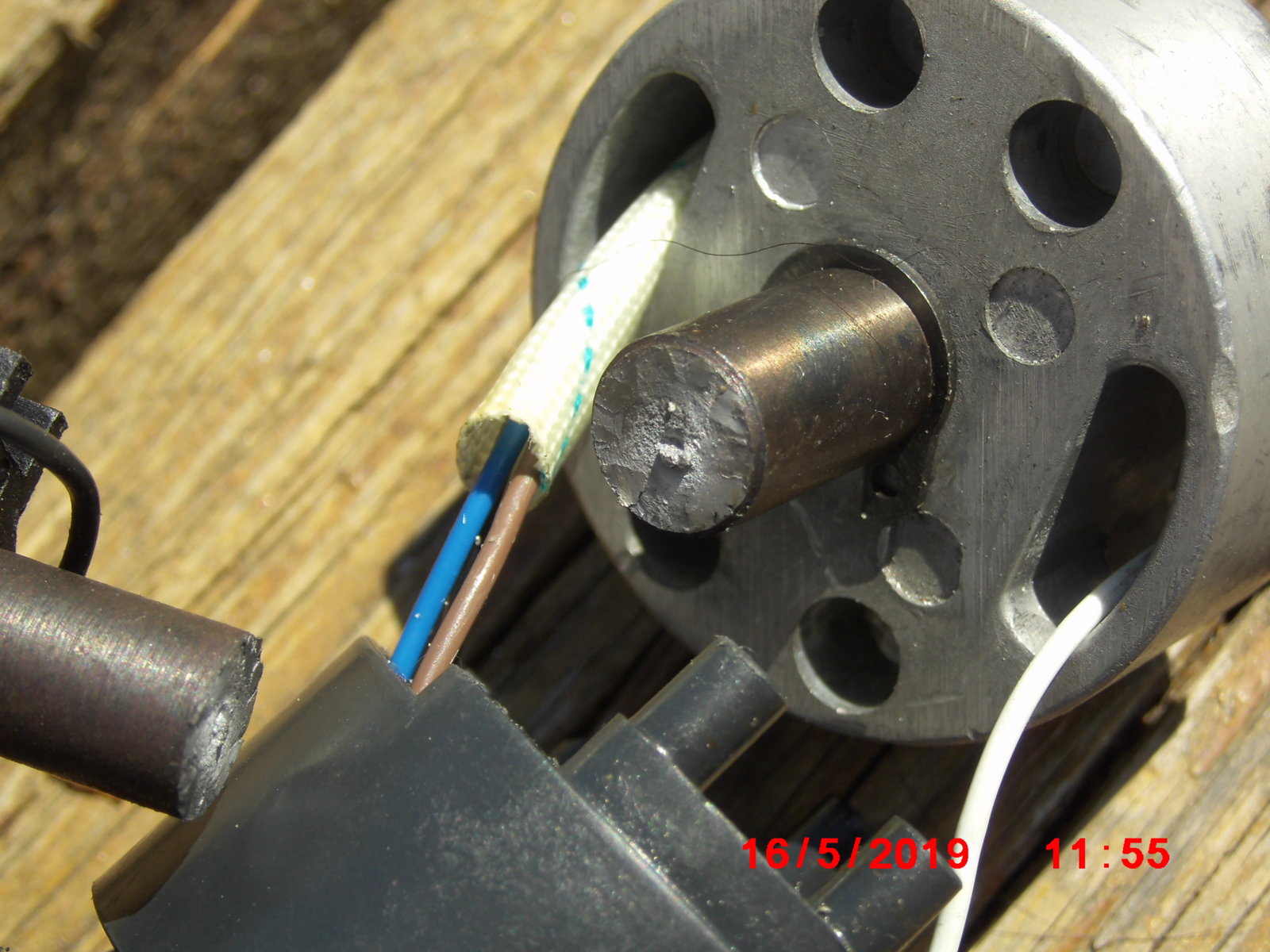

Second image shows the two halves of the snapped shaft, which is around 3/8th" diameter yet it appears to have been turned down to around 1/16th of an inch to act as a 'sheer pin'.

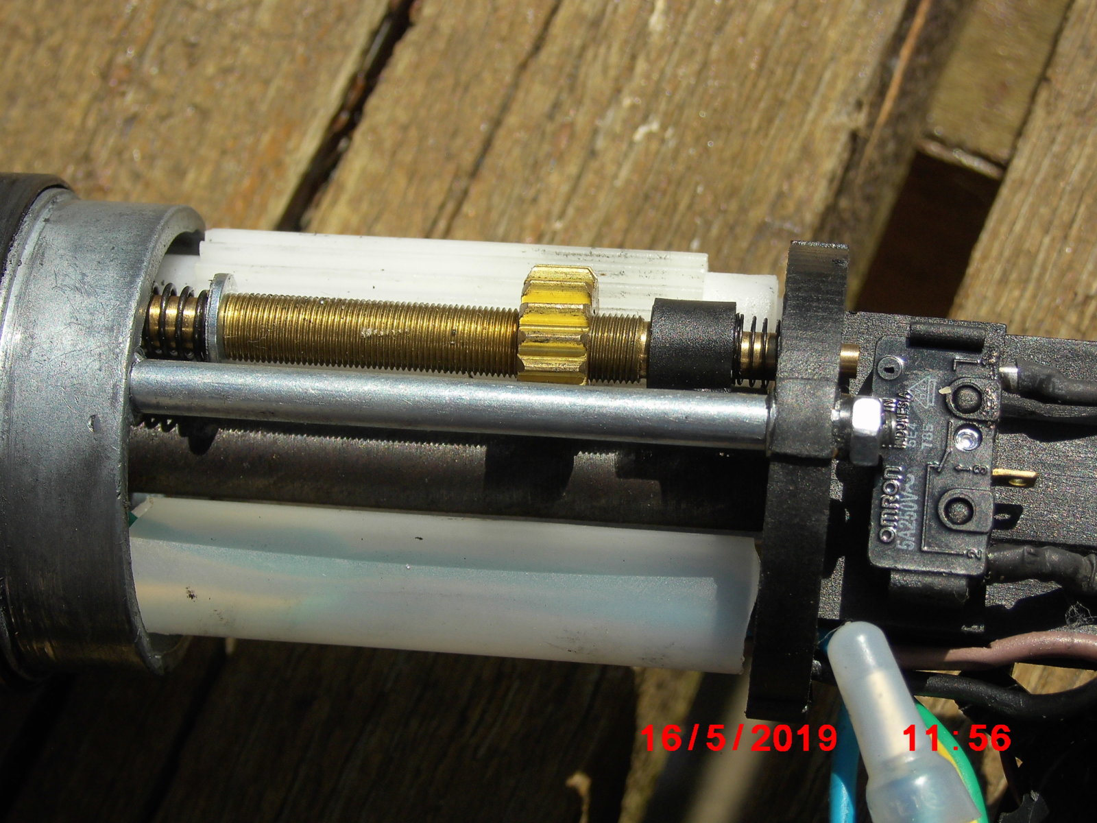

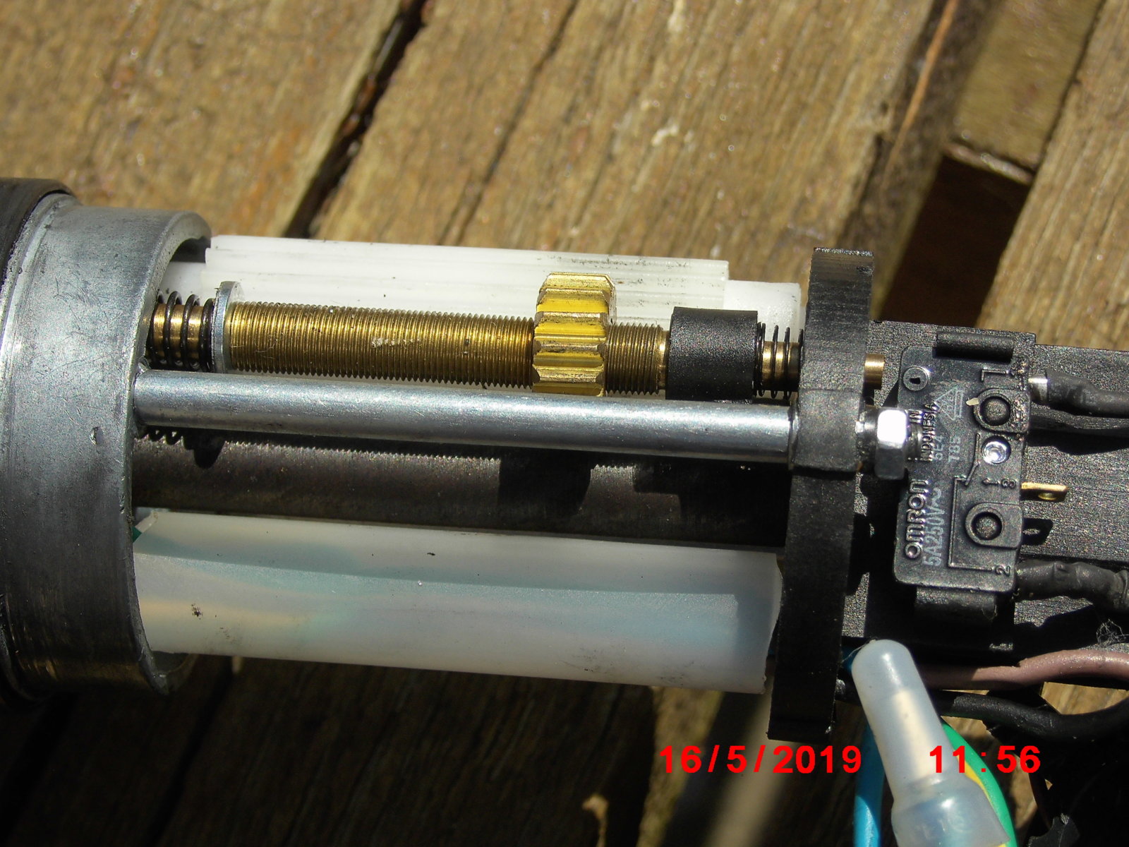

Third image is a close-up of the limit switches, top and bottom. Manual gearbox remains stationary and blue tube rotates, driving the limit switch cog system around.
