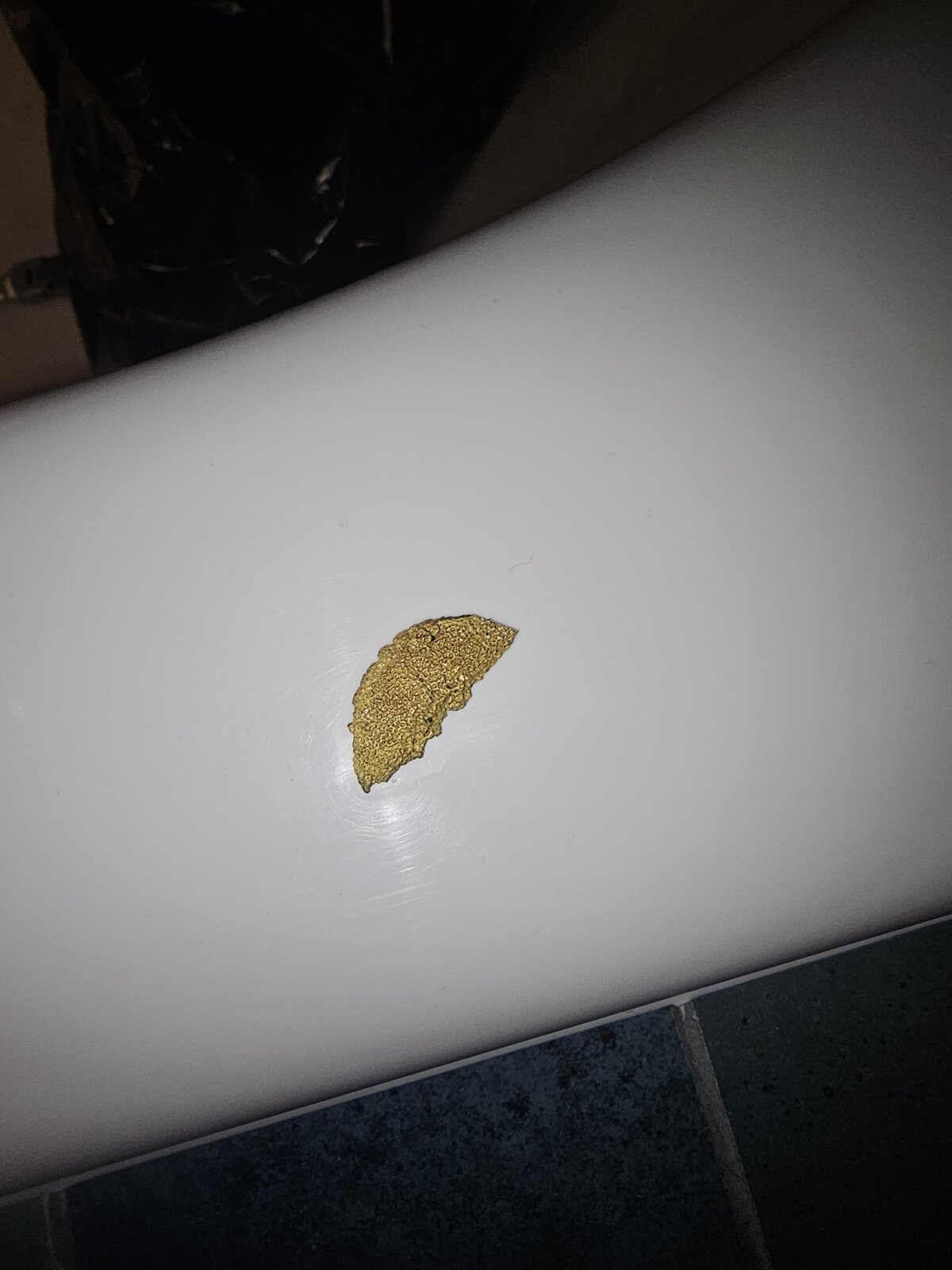

I have installed a Crosswater shower
like this item
Customer called tonite saying she turned the hot water on and it wouldn't turn off, I was just setting g off to go and look at it then she called and said her son had turned the mains stoptap off and then she was able to turn off the hot tap,
Very strange, has anyone had this or have an idea of what the problem is?
Cheers
Hi,

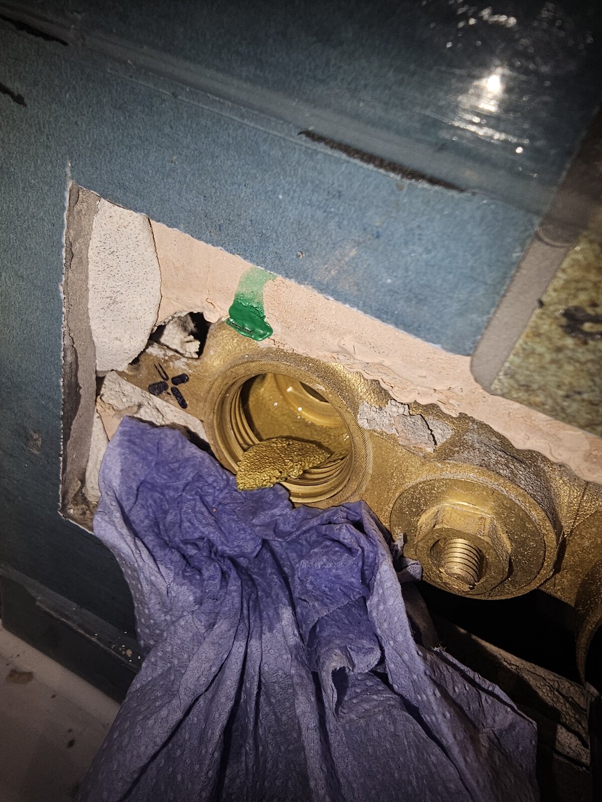

Detritus in the ceramic cartridge or on/off selector?
Hi,

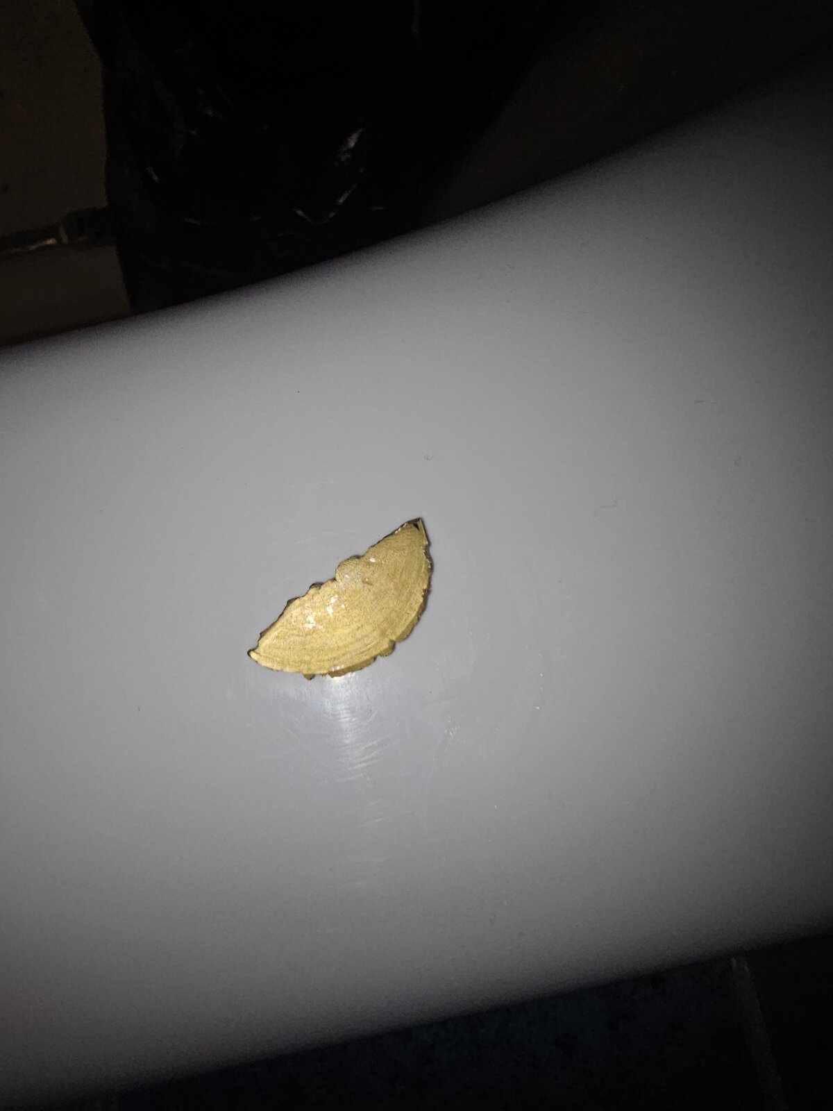

Yes, you are correct, I went out and removed the on / off cartridge and found the debris in the photo behind the cartridge, it's a large piece of brass. I removed the lump of brass and refitted the cartridge, valve worked OK and the following day customer messaged saying that the valve is passing and there's a drip coming out of the bath filler, obviously the debris has caused damage to the ceramic disk. Returning Thursday hopefully with replacement cartridge to put it to bed.
I wonder where that piece of large brass came from? Good to know it should be sorted.
Thanks for sharing this. It was a timely reminder for me to thoroughly flush my pipes through before fitting my new shower bar. :)
Yeah, it's good to flush the pipes but in this case it was brass trapped inside the valve, about the size of half a 1p coin so no amount of flushing of pipes would have removed it.
It was from the casting or machining of the valve body. Bloody annoying that it will have cost me two extra visits over what I priced for.
