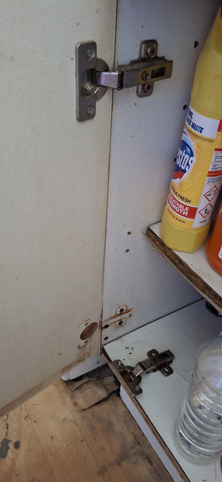

I have a cupboard door in the kitchen that's been wonky for a long time (gap at the top getting bigger towards the outside of the door).
I had to take the full hinge off because those inner screws that you undo to change this have been fully rusted in. It's very old.
How can I replace this please whilst making sure that this time the door hangs straight? Any advice?
Thank you.
This video is a quick summary of the adjustments to make
You can get replacement hinges from screw fix, they are probably Blum but check the part you have.
Ok so just get new hinges and hinge repair plates. Thank you.
