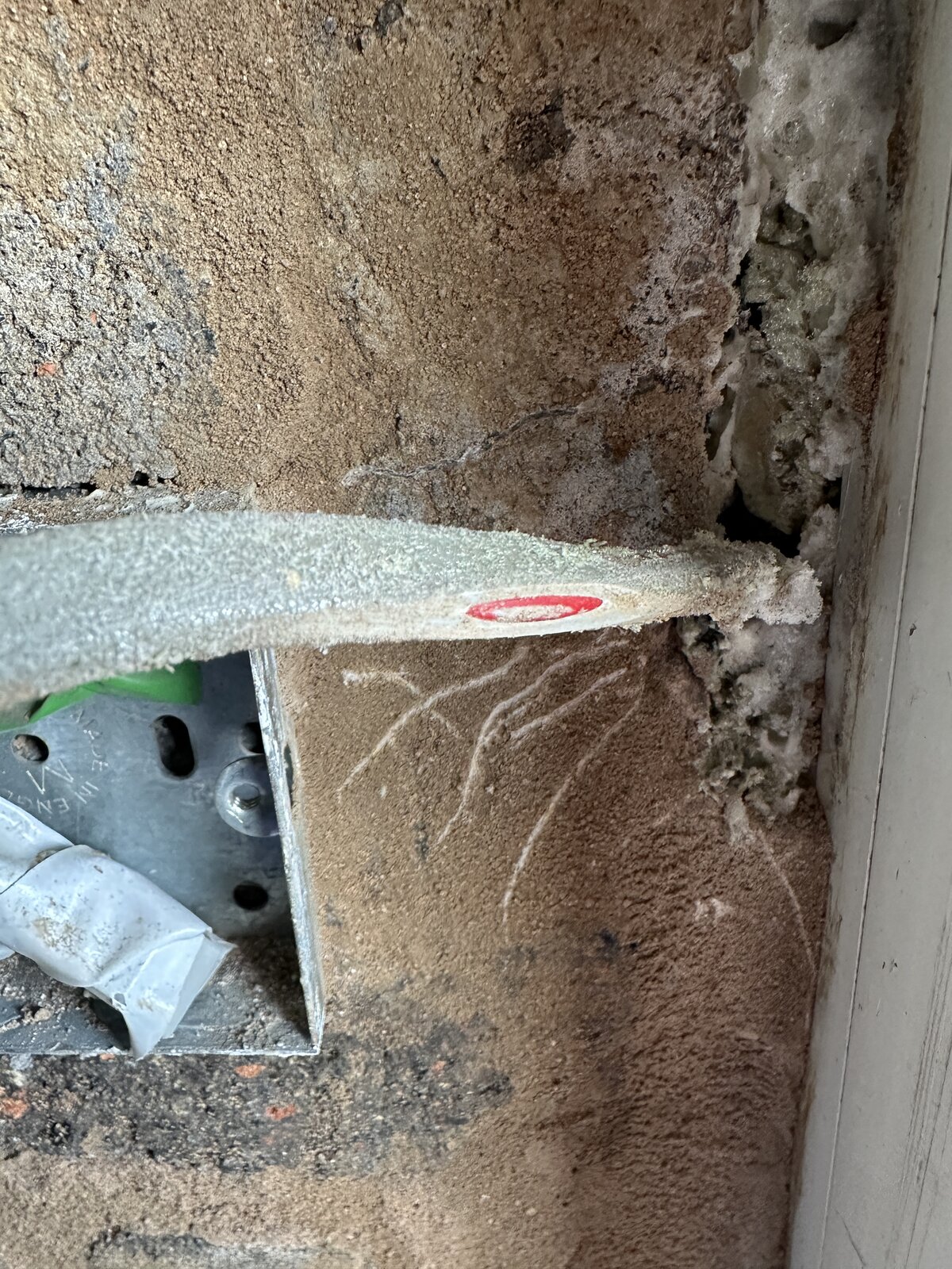

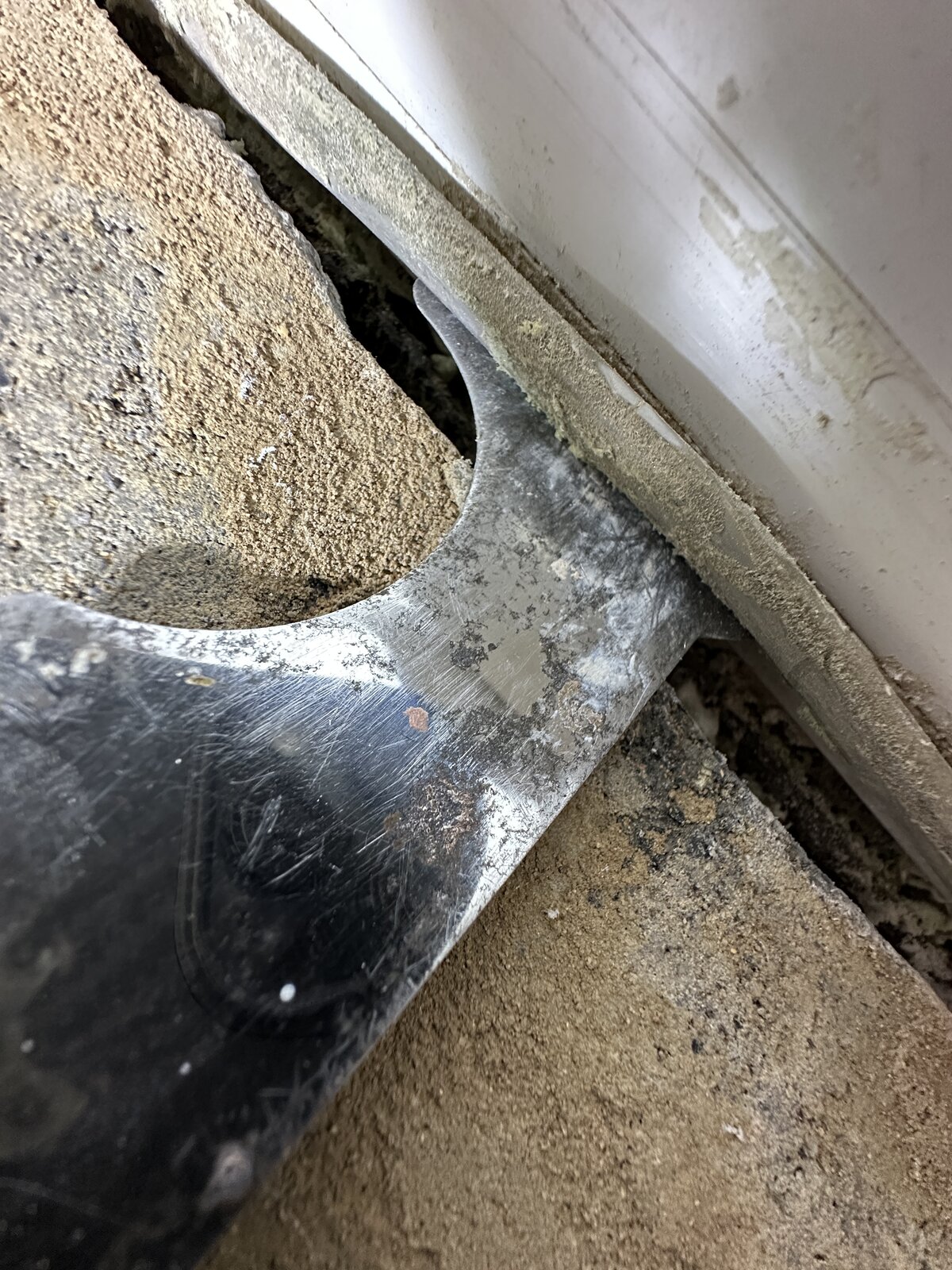

It was all going so well! :ROFLMAO: I've removed the old plaster in my hallway back to the brick in places, and filled all round the edges with foam, mortared the old brickwork and I was just trimming the excess foam off and bzzzzzzt, right up my arm. I feel OK, index finger is a bit hot, and no sign of anything else going on, but that was close!
Whoever wired this up (Wasn't me), has wedged the cable between the front door frame and the plaster/brickwork so only the very edge is visible. There's some kind of thick rubberised (might be tar) sheet and I thought this cable was that, and just trimmed it, as I have done a few times this week .I'm going to need to fix this length of cable before my plasterboard goes on. Should be OK with a simple low profile junction box and remove the damage and joint back together? Any recommendations for a flat as possible junction box, or other ways to rejoin the cable safely, long term, that are low profile, as in under 20mm if possible?

Not unless an electrical safe zone is stuffed between the upvc front door frame and the top layer of plaster? This is a 70+ year old house and the wiring is probably late 80s, so there are no zones that fit with today's regs, as far as I'm aware? Plug sockets are low to the floor, wiring is all the old colours, electricity meter is from the 70s, an old Feranti one that spins. As I said in the OP, the cable was just below the surface, mostly, with a very small amount, occasionally appearing for a few mm at a time, it had been painted many times over the years, had plaster on and more, so was well camouflaged, but the thing that got me, was that there was also a thick, bitumen type membrane in there, too, and I thought that I was trimming that.

For joints within plaster I believe heatshrinked crimps are a regs-compliant solution.
