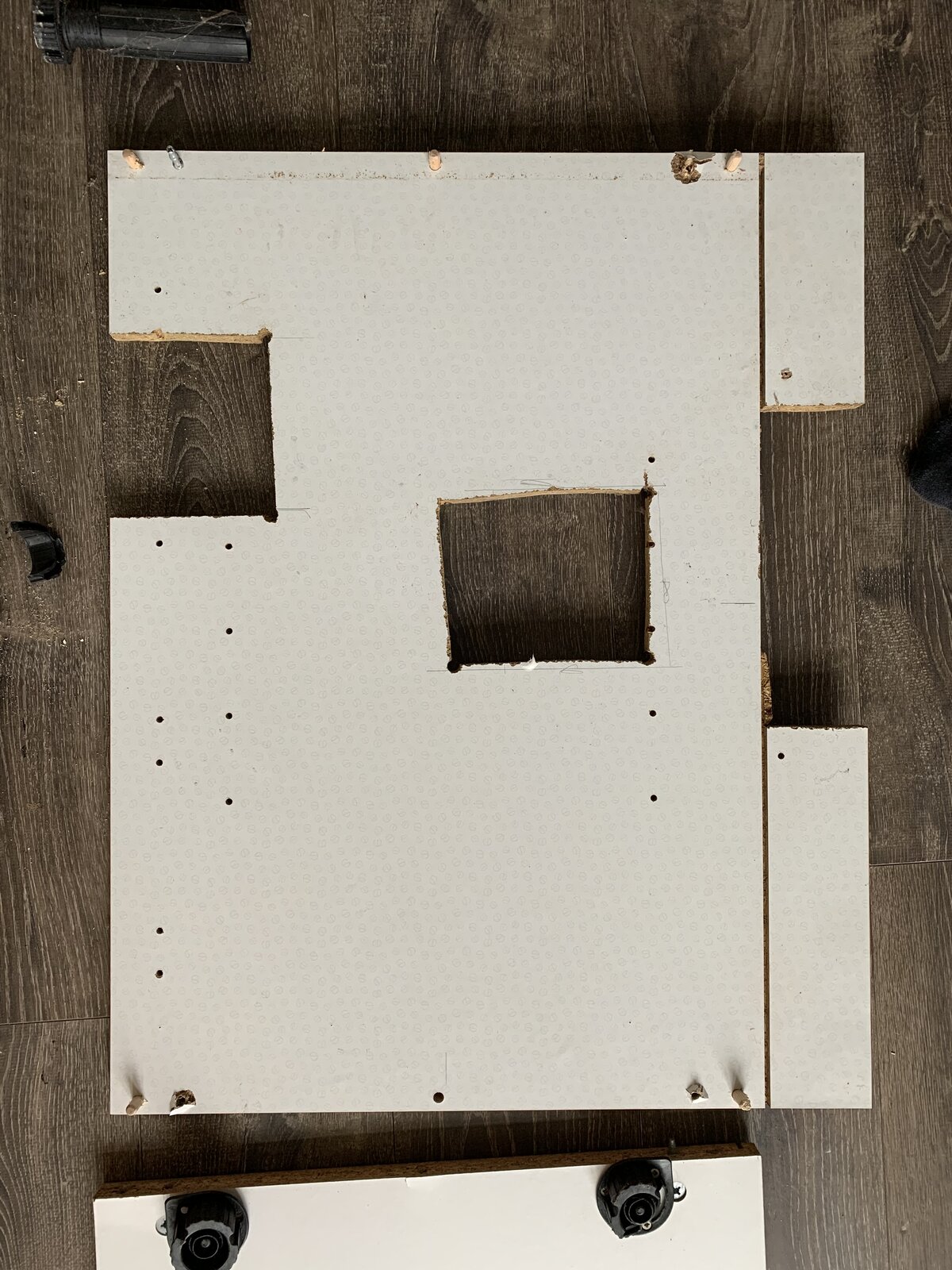

Hi all,
I'm trying to replace a panel from the base unit under the kitchen sink. Some parts were rotten, so I'm just replacing a board like-for-like.
It's melamine-faced chipboard, and I've managed to get 'furniture board' from B&Q to match it. But does anyone have any creative ideas on where I can go to get the square cut-outs in the board (see image)? I don't really have any tools and I'm seeing if I have any options, before buying a jigsaw and learning to use it etc.
I just keep thinking- surely there are places (workshops, businesses?), where I can just ask to pay for this small job. I've googled all sorts of things, even looking at CNC machines. B&Q's timber service couldn't do cut-out's of course. The cut-outs are holes for pipes and I suppose plumbers/kitchen installers just have their own tools...
Thanks in advance,
John

Those cut outs are truly horrible, but very easy to do....
The left one could be done with a coping saw, the centre one really needs a jigsaw as the coping saw throat probably wouldn’t be deep enough - back to the coping saw for the right hand one.
Do you know someone who’s ‘handy’? 20 minutes work there!
John :)
As a joiner it is the sort of thing I could do in a few minutes with my tool kit, although I'm reasonably sure that I would be a bit neater than that. You could try local handyman services, or if you see a plumber or a chippy or a kitchen fitter working on your street why not just ask them. They might do it for free, or for the price of a drink. After all, it's only a 10 minute task. Failing that ask a local joinery shop.
For such a small amount of work you could use a padsaw.
After drawing the lines for the cuts, drill a hole in each corner of each cutout.
A jigsaw would be less effort.
Cor thats butchering of the first order.
Multimaster would be my tool of choice .
A deep throat coping saw would do even the middle one,cut from outside the cabinet to minimise chipping.
For the panel I think for the price they are I maybe would have looked at b q type base unit and used just one side as it has the grove for rear panel if that was needed
Idealy the cuts between corner holes should be to the outer circumference so one has a nice square hole with a radius in the corners...oh says im too fussy:)
If you have a drill I would probably look at a holesaw?

You can make a hole by twisting a flat screwdriver and then hold a hacksaw or a reciprocating saw wood blade in a cloth, poke it through and cut the shape out.
I've done these with a Leatherman when I've had to. But it depends what you really want.
Best option is to find someone in the street who has the tools. Watch out for a tradesmans van parked up, and ask. Or neighbours.
