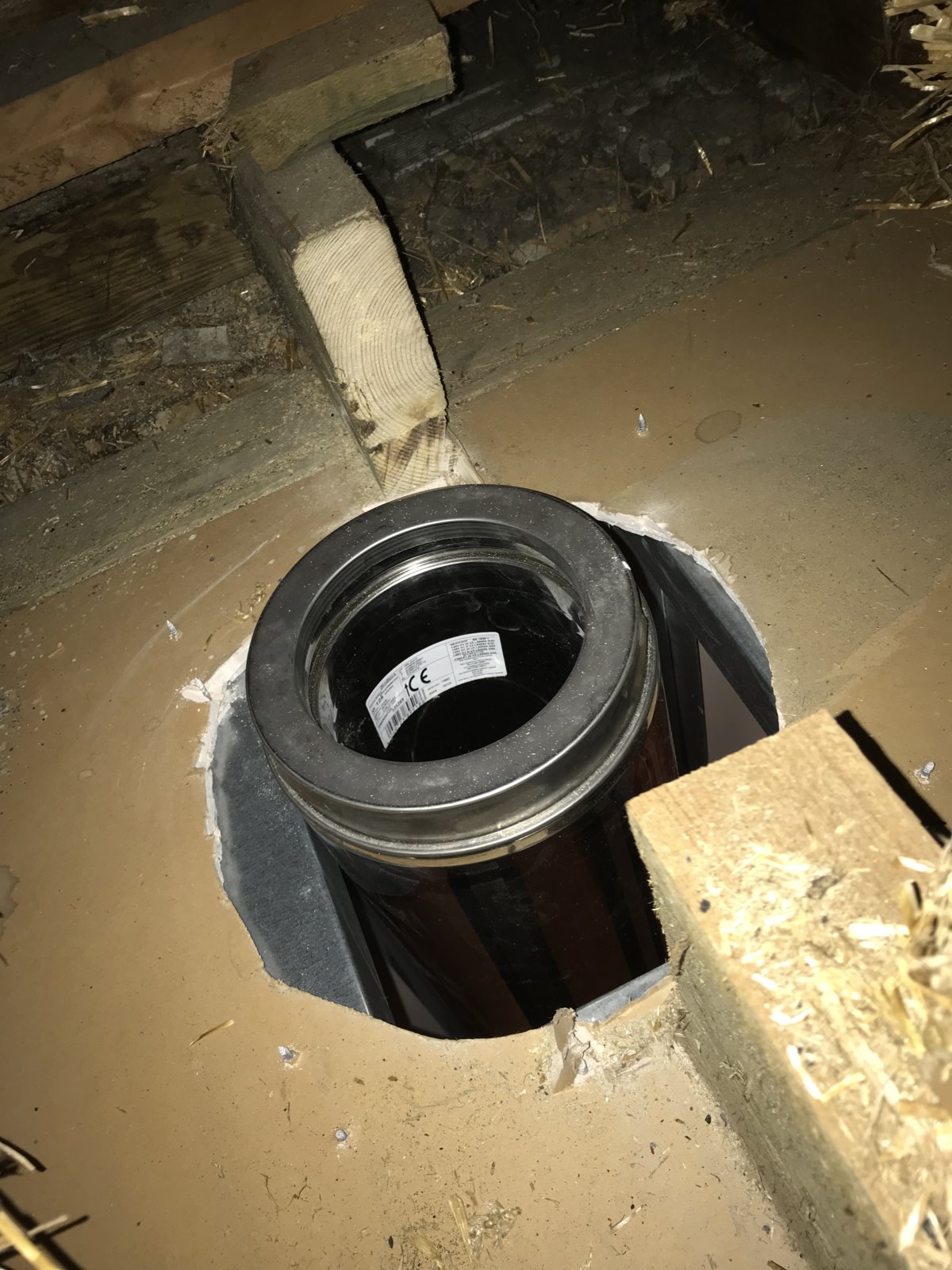

Hello,
I'll try to keep it brief: we are having a wood stove installed, and the HETAS approved installer has cut through a joist in the first floor, and a joist in the roof to allow the flue to run up and through the roof (it has an angle in to avoid rafter).

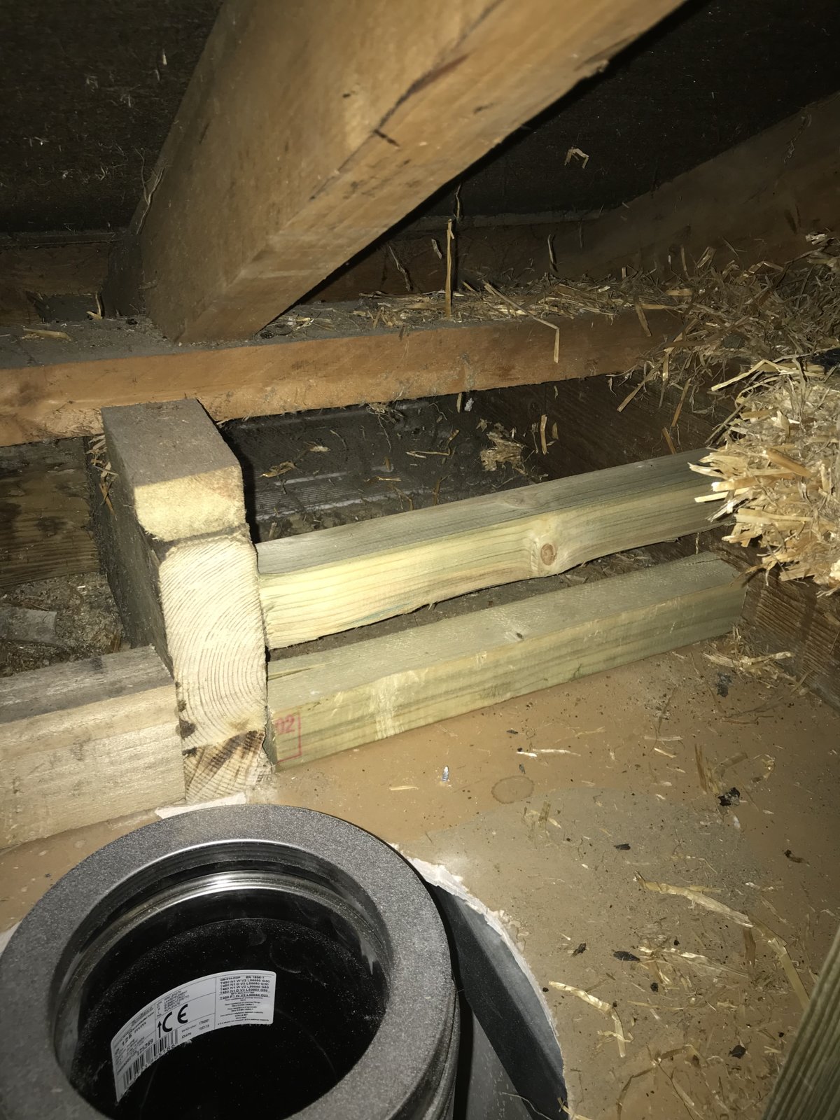

There are now two joists (circa 200x40mm) which are only supported at one end, which is circa 3m from where they have been cut near the wall. The stove chaps are installing some timber blocking... but I always thought that double trimmers were required to take the load to the nearest joist either side?
I'd be really grateful for anyone's thoughts on this: is is standard/acceptable practice to cut through one joist with no issue? If so, can anyone point me in direction of regs/guidance for this?
Thanks so much
M

Depending on the load, it generally is. I've lost count of the number of joist replacements/repairs I've done over the years where "other trades" had cut away or cut-out sections of "non safety critical" joists. I'd also suggest posting a couple of pics of their handywork
Thanks so much bobasd and JobAndKnock ... They are being pretty defensive about their work, and whilst I'm sure its fine in 99% of cases, it does feel like cowboy work as they just don't expect people to inspect what they are doing in floor voids! I dread to think how often this happens.

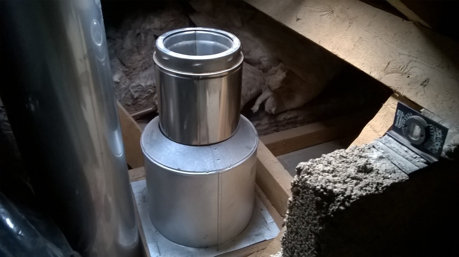

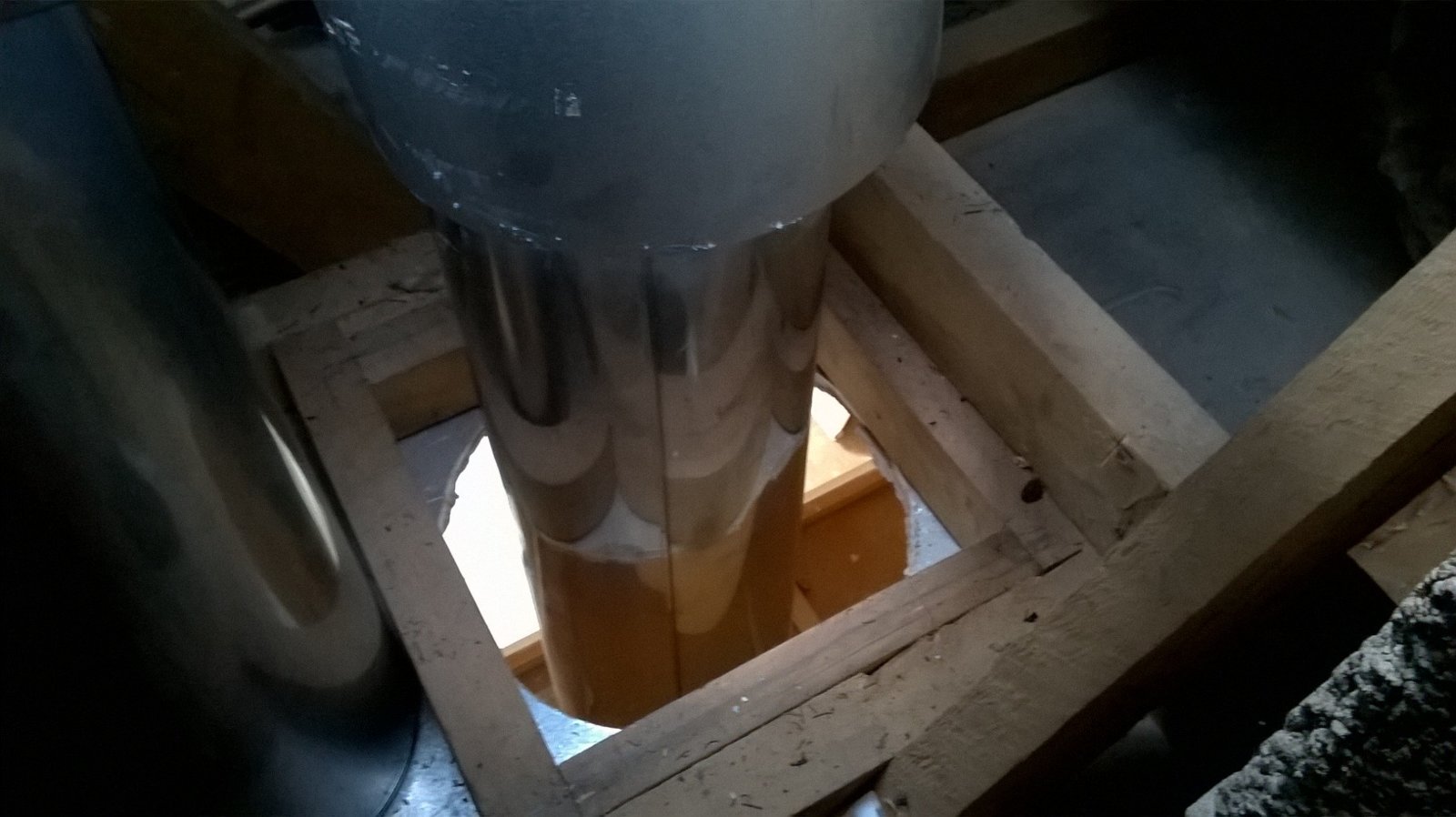

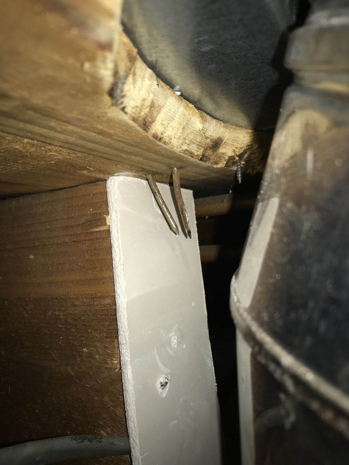

They are now packing out either side of the cut joist, but, as I have explained to them - this still doesn't pick up the load of the unsupported joist. Hopefully some photos are attached. In the roof there's one before I grumbled, one after I grumbled and timber packing got installed, and then one of the first floor void where there is no packing at all, but they've stuck a bit of fireline board on the end of the joist so it doesnt get too toasty. Great work.

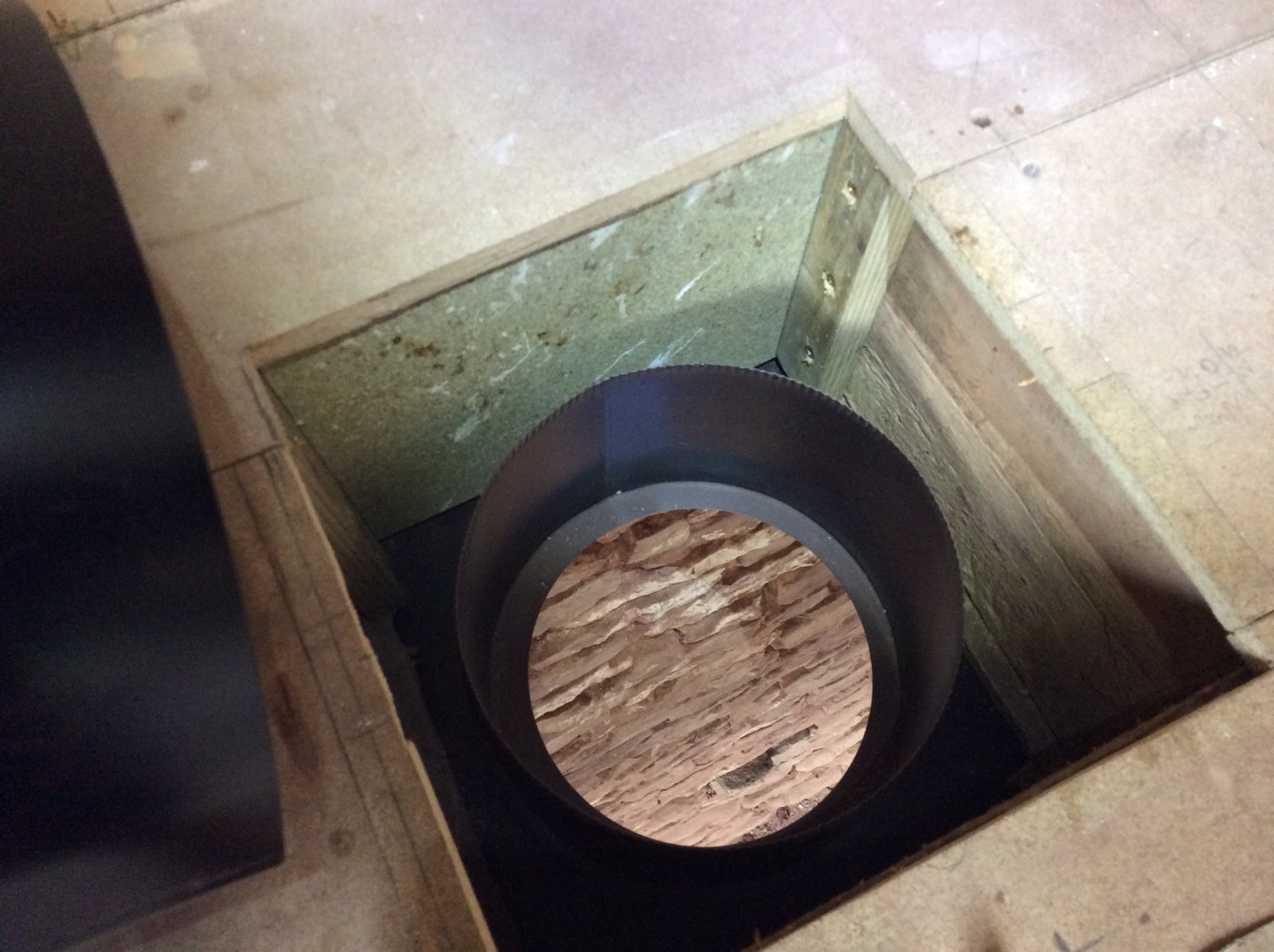

Where is the flue supported/ suspended from . Out of interest Could you post a picture from below the ceiling of picture one , I cant figure out why there looks like self tappers into plasterboard
Flue looks like 5” flue?
They are complete and utter cowboys. Adding in what they call packing isn't structural and makes little or no difference to the strength. Surely the gap around the flue should be sealed with some form of fireboard or collar? If they don't know how to do the carpentry work safely, they should employ a carpenter to do it for them. In fact are they actually HETAS certified, or are they just saying they are? Have you checked with HETAS? If they are legit I'd report them to HETAS for incompetence. I'd also have a word with Trading Standards. These guys are going to cause someone major problems sooner or later

ps - lost in the light - the screws are from the metal section frame around the flue on lower floor, which was then boxed out with fire board. The flue is a Schiedel twin wall flue, and at the point it goes through any floors/roof structure it is 180mm/7'' wide as insulated.
