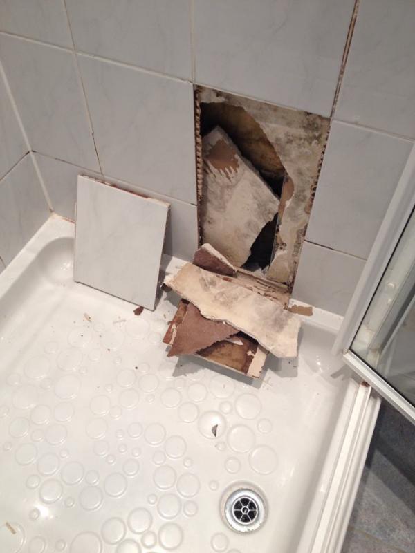

If you need to see what can happen with plasterboard take at look at the picture below.
Doesn't surprise me that builders specs are plasterboard - it's cheap. Best is to use waterproof tile backer boards like Wedi, Marmox etc, next is to tank it.
Any movement that opens a crack in the grout or silicone will let water in that will then lead to more damage.

You should tank it, many don't but then many have problems.
Site specs often cut it out because of costs, but if (and when) water gets behind the tiles, the pb will fall apart. Lots get away with it because the shower head isn't facing the tiled area.
Priming won't make the PB stand up to water, acrylic priming is just to help the addy stick.
although actually, the best spec is to use a backer-board. no need to tank then.
