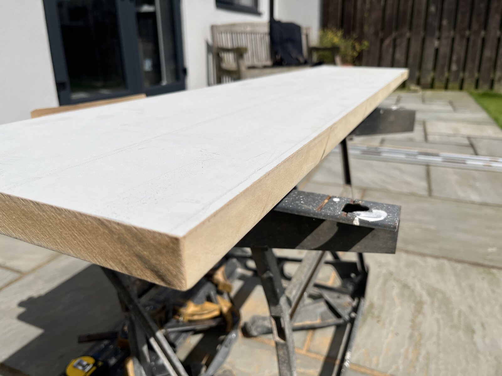

Bugger….yes I have, I couldn’t find any square edge locally :cry: . That would have been perfect !!
Update…..
The circular saw worked a treat, gave a clean cut, saved lots of time, and saved my hand saw blade :)
Thanks for the advice folks (y):)
Well played. For what it is worth a high quality plunge saw on a track (eg Festool, Mafele, etc) will give a quality of cut that only needs very slight sanding prior to painting. The tracks minimise the chipping on the surface face, but you can set the depth of cut to about 0.5mm (or less) on the first pass which should leave virtually no chipping.
The quality of cut is, in most cases, vastly superior to a saw with a fence.

Thanks for the tip….it wasn’t the best of cuts, as you can see :(
But with a bit of sanding, a couple of coats of MDF primer, then another sanding. It looked ok
Cheers :)
I think I can see a couple of places where you may of stopped moving to re position yourself. I find it best to try and do the cut in one continuous smooth run
Yeah, you’re right. I couldn’t think of a way of doing a continuous cut the way I was doing it on my workbench, and I was doing it freehand. The saw motor housing would have hit the clamps if I’d used a straight edge. :oops:.
I’ve got one more to do, I might put a bit more thought into this one, see if I can do it in a continuous cut (y):)
When attempting such tasks in the past, I've found myself screwing the straight into the workpiece for the same reason. There is an underside to your window board, so a few screw holes wouldn't make any difference.
But then you may get a breakout rough edge on your top but yes that is an idea

If aiming to do it in one move - plan ahead making sure you can reach and can walk along and that the lead will not get snagged, do a dry run with no power, get someone to perhaps support the first bit you cut .

I don't own a table saw, but I do have a Festool track saw. I can see the value of a small table saw, but, with respect, if cutting (up to 2.4m) the track saw will be easier and more accurate (assuming that you can elevate it high enough to screw up the track clamps).
The downside to the track saw is that, ideally the stock will be wider that the track, but there are ways to get around that. A small table saw is difficult to work with wide stock.
Horses for courses, but if I only had access to a decent portable table saw or a decent track saw, I would go for the latter, that said, your requirements might well be different to mine. I can use mine to trim, for example, doors. I would not want to try run a door over a portable table saw.

Yeah, the way I had it set up I was stretching right over my work bench with the circular saw, doing it freehand on a board 1.8m long !! :oops:. Not ideal, and I couldn’t do it without changing position. No doubt the pro’s will be cringing, lol :LOL:
A table saw would be ideal, but not worth the investment for the times I would use it :cry:
The next board is 2.3m long…..can’t wait for that one :(

None of the clamps I linked are long enough for that. Find a straight piece of wood and screw or clamp it.
I have thought about this for a straight edge as finding a perfect long straight piece of wood is not easy

Yes you will struggle with a door. and for long stuff you need a feed in and a feed out table. Or at least a feed out table.
