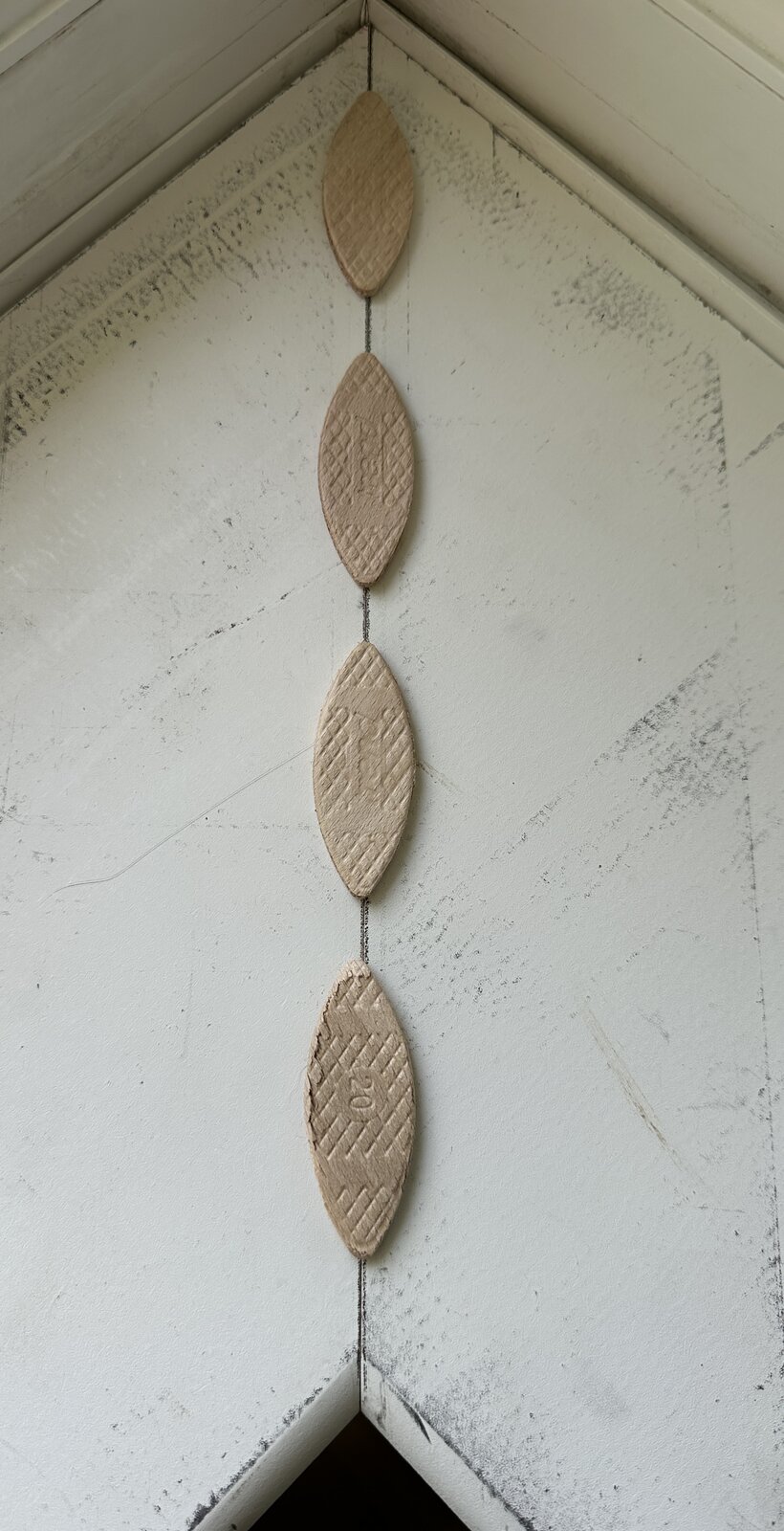

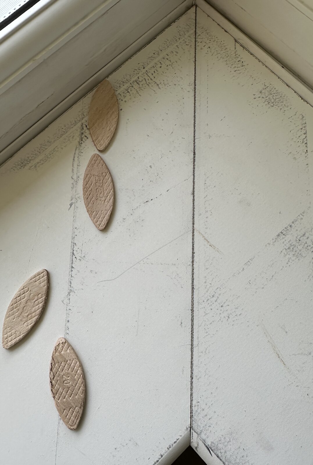

Just doing this today, mitres are cut and I'm going to attempt the biscuit jointing, but I wanted to ask how many joints would you recommend in a 350mm mitre joint in 25mm thick moisture resistant MDF window board? I'm guessing 4, but wanted to check if that's OK in this MDF. Thanks (y) IMG_9849.jpgIMG_9850.jpg
A biscuit every 96mm should be enough, last biscuit centres about 48mm in from the ends (that's all based on System32, but you don't need to be that exact). So that makes 4 biscuits.

Looks like a couple of layers of masking tape have saved the day. Did a test cut with mitres and 3 biscuits along it and it lines up ok. Not as tight as I thought it'd be, but seems to align perfectly so far.

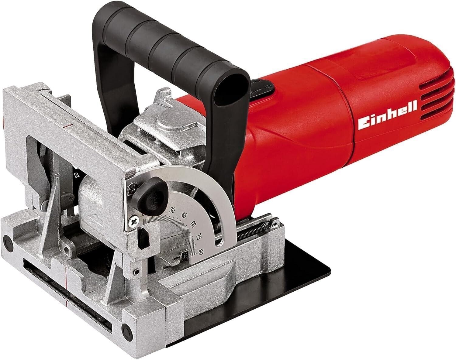

I did take a look at the Einhell TC-BJ900. Certainly seems reasonable for £65, and at least you can hoy it back if it turns out to be pants
The front end looks pretty similar to the Erbauer - and they both have front ends which remind me of the DW (Elu MBR100), so at least they've copied a known design

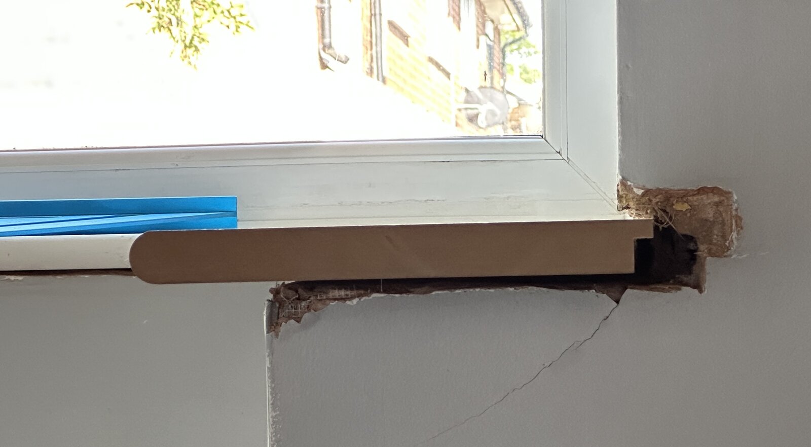

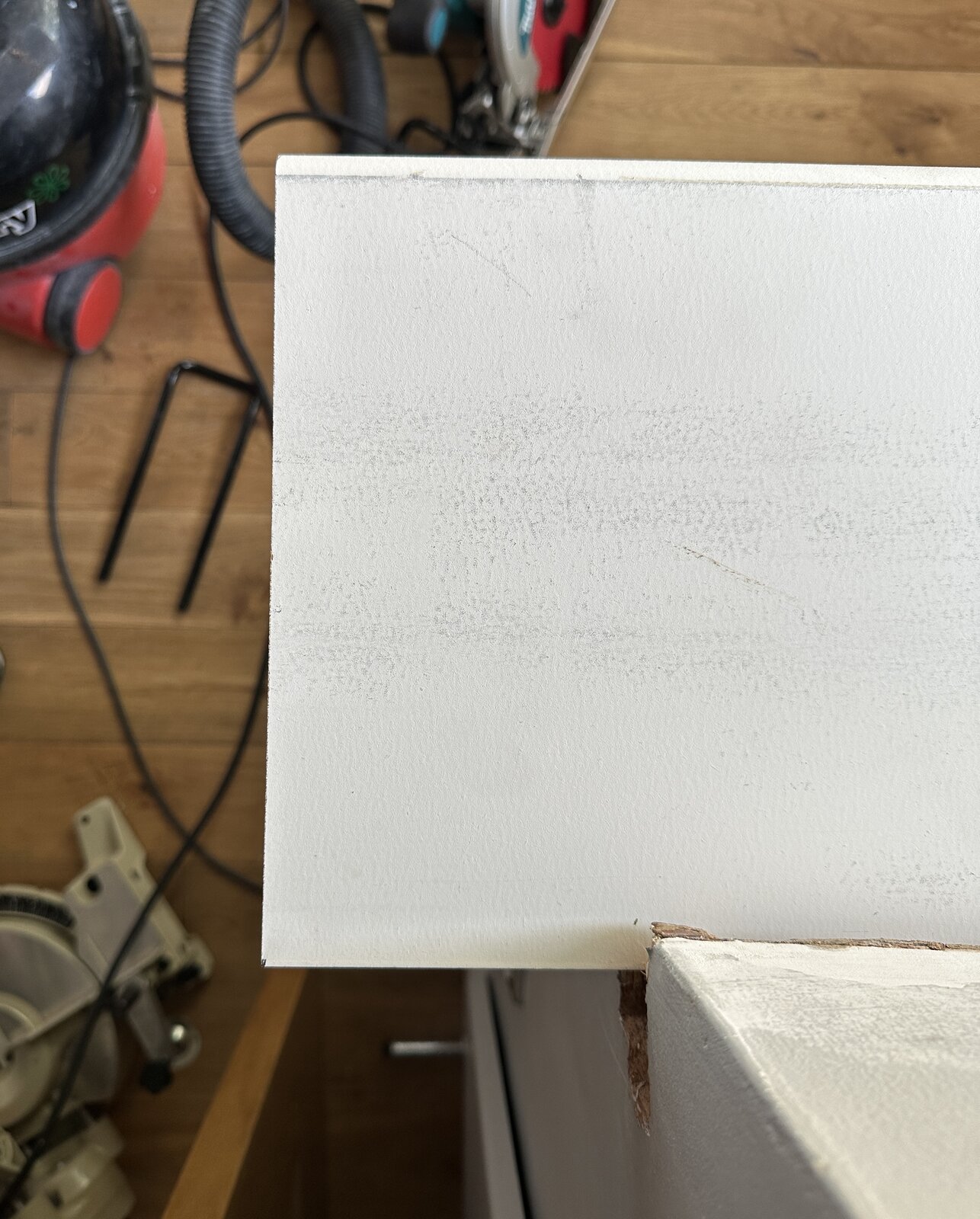

Thanks. I have managed to complete the jointing with the masking tape, taking up the slack on the Erbauer. The joints don't seem particularly tight, in fact some of the biscuits are quite loose, but the alignment seems to be ok on both joints, so that's ok for now. There's a couple of things I'm not so sure about, and I'm not sure of the name of it, so I'll try and explain it. On a window board, typically, you see the board look as if it was wider than the window return, by 3 or 4cm each side, so it's a kind of T shape? Well as this is a square bay, you see the ends of the window boards and I wanted to do that, but I couldn't work out how to do it, because I have already gone with a wider than needed board, because we have shutters and they take up most of it, so an extra couple of CM overhang is fine (5 in total). See photo.
As you can see, the side profile of this board has a lip, so that's not going to look any good, so I was thinking, could I take off the lip so it is a nice straight edge and then biscuit joint another piece onto it to create this bit that I'm missing? Or just be happy with the 1cm or so in the wall and fill it and move on?
I'd also cut the side pieces extra long, in case I messed up the cuts as I was doing it with a circular saw, so they need trimming, so thought I'd ask before I trim them if the thing I mentioned above is doable. Thanks.
