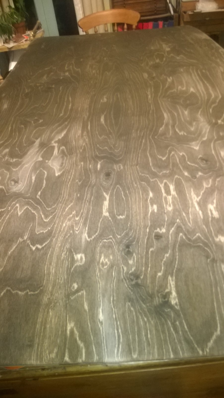

I am lining a ceiling with birch ply that I have stained and sealed with matt finish hard wax oil
The sheets ,which are full size, need to be cut to fit so what is the best way of cutting the 4mm sheets without damaging them or the wax/oil finish.
In case anyone asks I cannot water stain the sheets after fitting as I needed to mix different oil waxes to get the finish I want This would be impossible working on a ceiling as I need to sponge as well as roll them. Any advice ?

Its going to be a grey ceiling so I am using black headed screws. I have used similar boards on walls without any problems but,yes, it might be an idea to glue the boards to the battens as well because of the weight.
A decent track saw will minimise tear out on the top. The finish would be mostly unaffected although if you've sealed the edges you'll need to redo. Support spacing is going to be critical for the fixing as 4mm is very thin and is likely to sag over time. I doubt the spacing between existing joists would be close enough to prevent this. I'd be tempted to use a sort of lattice work behind the boards if possible to give the face board some support.
