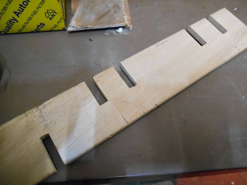

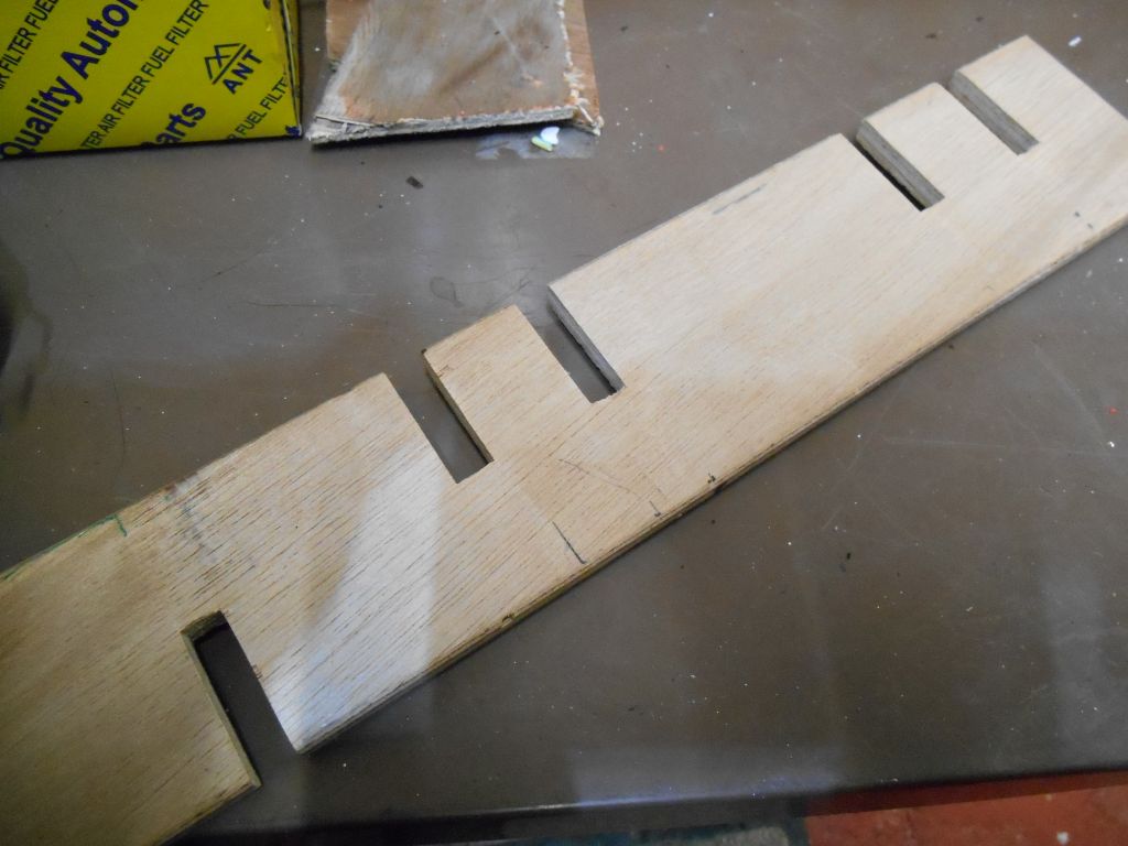

Hi folks,
I have been kind of roped in to making pieces of a wooden puzzle, consisting of strips of 9mm plywood with slots cut in. The slots are approx. 10mmx35mm, see pic
Looking for suggestions (hand or power tools) for cutting the slots out? Needs to be a fairly neat cut. And ideally quite fast as there would be nearly 100 slots to cut :confused:

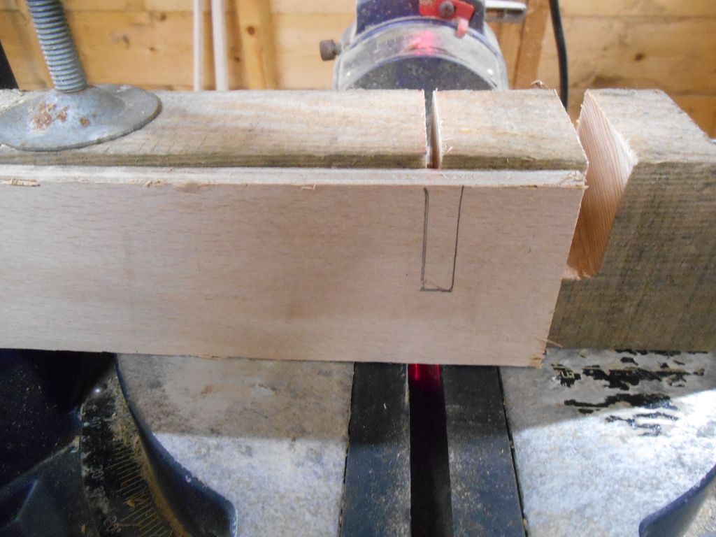

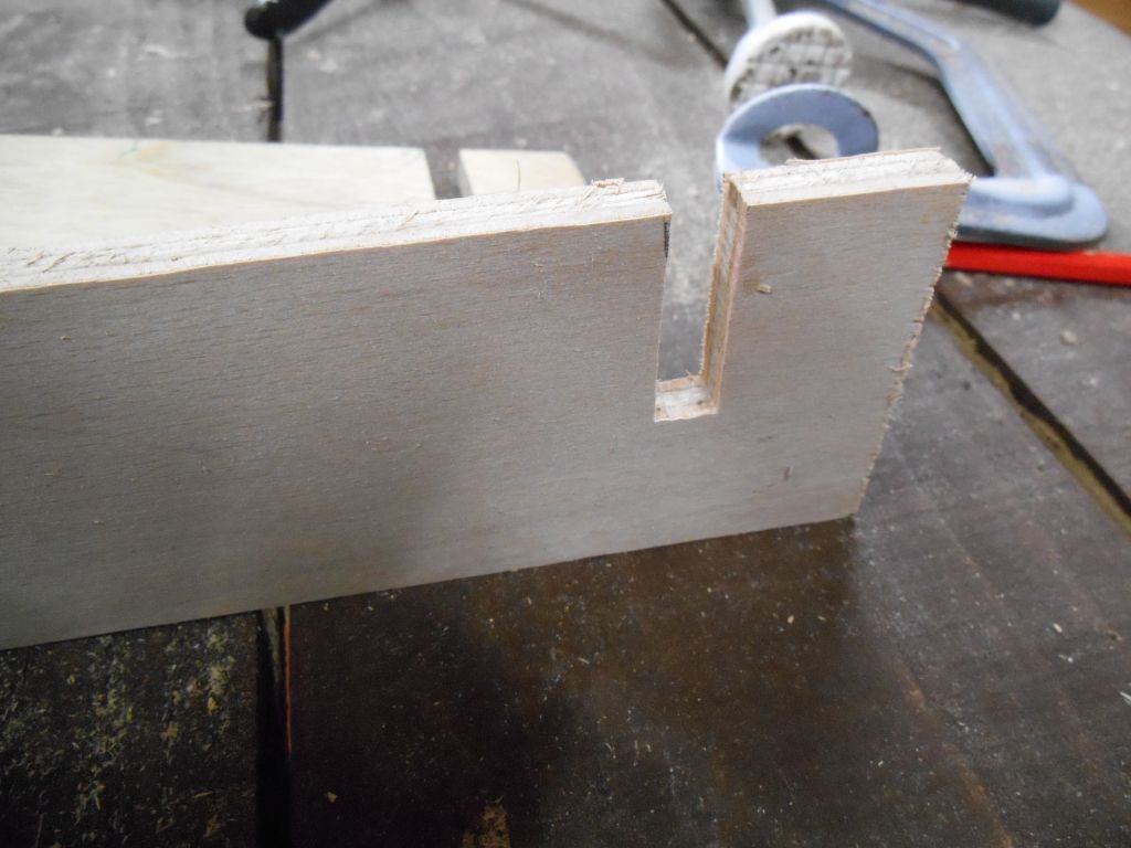

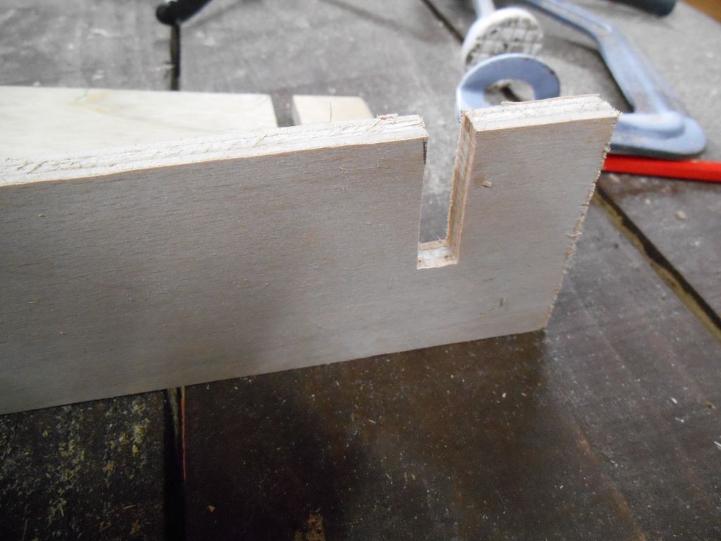

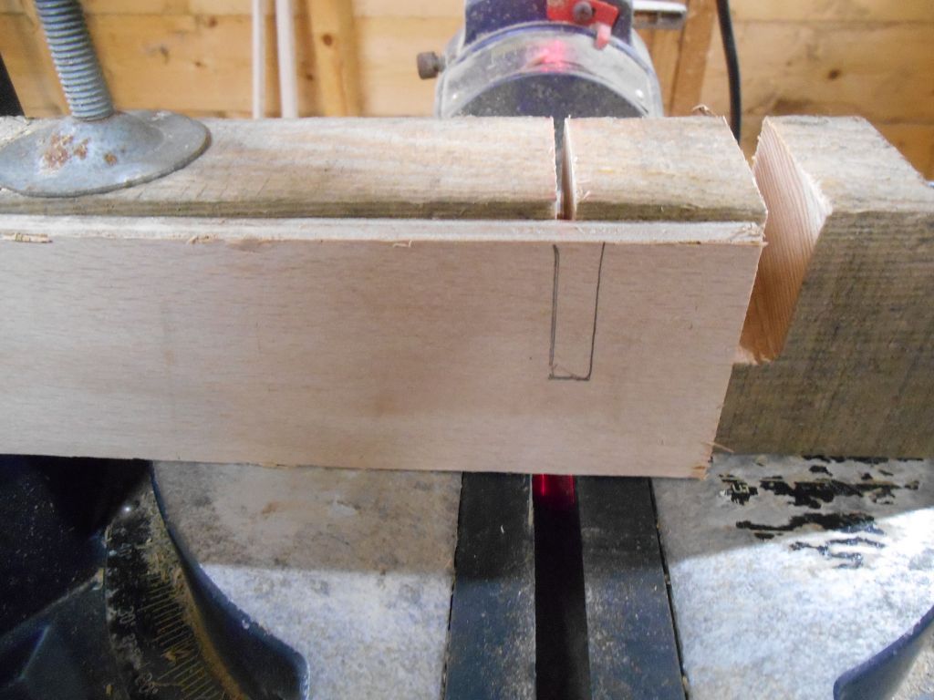

Thanks for the replies everyone
Think I've got it sussed now, mitre/chop saw with a very fine blade making multiple cuts, with a piece of wood clamped behind.
Leaves a fairly good finish (still to tidy up with file/sander)

as i mentioned above you dont need a square base to the slot
so much quicker would be a drill hole and then a pass each side using a guide/jig or rod for uniformity
