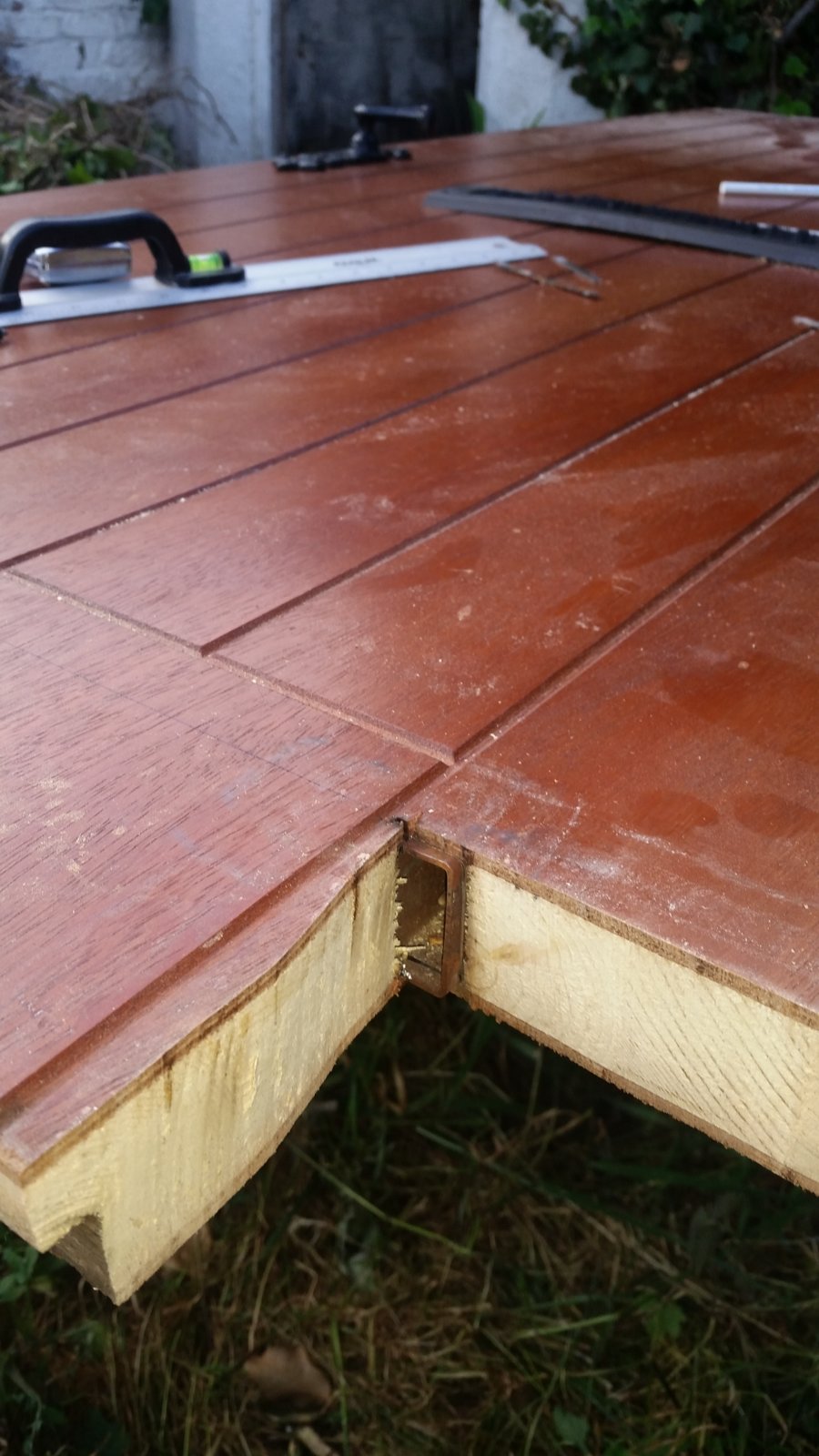

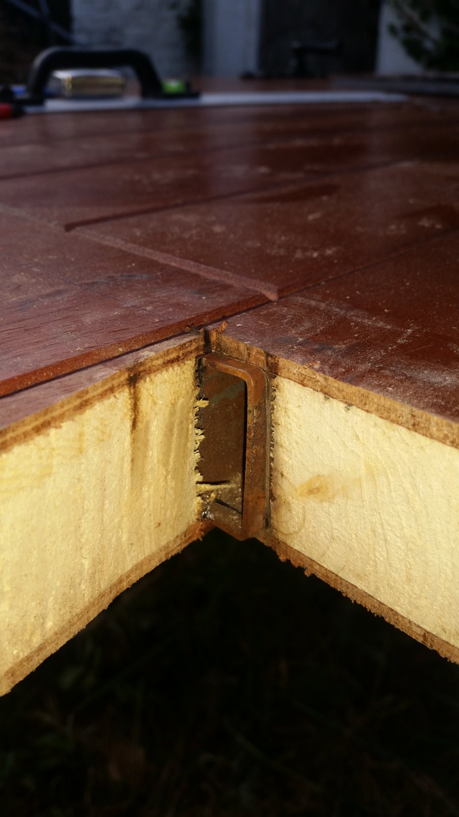

I brought a second hand Wood door for my Shed, It was listed as solid wood and i too believed it was as it is so heavy, I started cutting it and I have hit metal, so I cut a cross section to see what it was.
From the pics can anybody tell me if this is likely to run all the way through the width of the door, or could I cut beyond it?
If it runs right through I guess I'll have to take another couple cm off of the top and drop down below this and repair the corner.
I've already taken 5cm off of the top and stopped where I did to keep it looking in proportion, I also have a fair bit to take off the side, i guess it's unlikely there will be any metal beyond this in the photo will there?

A powerful magnet might help identify the location of metal buried in wood.
Blup
very hard to tell this must be for a specific purpose
in general you will not have a frame only in the centre off the door it will be probably at both edges as a security door as that is a heavy duty frame
i personally would chuck the door and start again as framework that size is to stop a very heavy attack
worth tapping the door with a screwdriver handle to find hollow spots

I would guess it's a metal frame, all sides, possibly 100mm in from every edge.
With a circular saw and a multipurpose blade, you should be able to cut through everything in one go, yes even the frame.

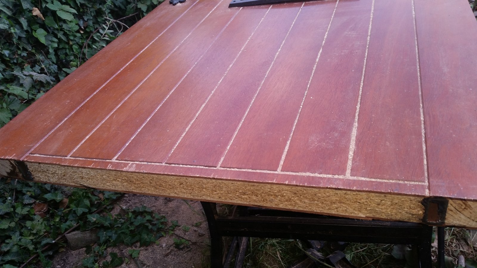

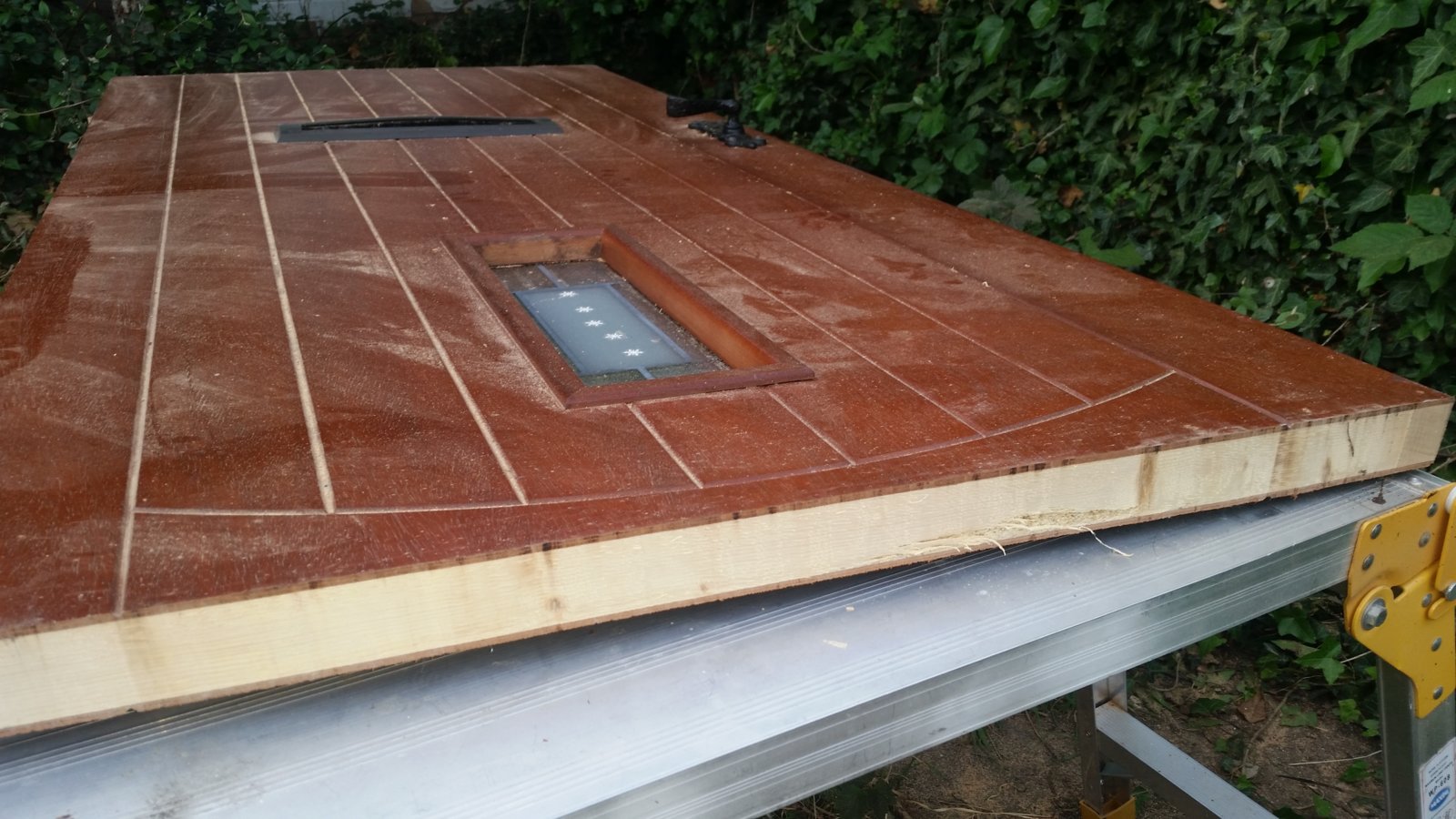

Final update:
I cut the bottom, actually a little more than I originally intended to compensate for the slight incline into the shed.
The Circular saw made it effortless, sparks flew everywhere but I actually quite enjoyed it and it was like cream cheese compared to the jigsaw. Also I used the detector and that worked well too, it appears there are a few cross sections but they start a fair way above where I was cutting.
The top was at it's limit, as you can see in the 2nd pic, I have literally just hit the cheaper chipboard type wood.
Anyway I'm glad I persevered, thanks for all of your advice!

Well done, just make sure you paint/seal the chipboard edge well... as it will soak up water like a sponge and over time will probably delaminate the door.
Think I would also add a weather bar or strip to stop rain running down the door. Use plenty of silicone.
