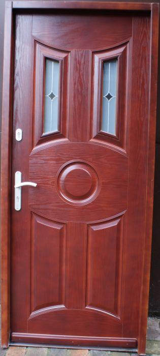

You've probably guessed my problem is with an exterior door which is too large by about 10cm... The door is a pre-hung 'wooden' type which includes a solid mahogany frame. I am not sure of the exact construction of the door, but know that it's definitely not solid wood, possibly the edges are solid with the rest being a sandwich type construction with insulation in the middle. Dimensions including frame are 208cm x 86cm
Here's the problem - the door is 9cm too high for the existing hole, which currently still has my original old door in place. I purchased the door on the recommendation of a friend, who intended to install the door for me and insisted "no problem, I will raise the hole and bury the bottom metal rail slightly to gain the extra space required:cool: Unfortunately, this in reality did not work out, as there is a steel lintel in place directly above the frame :evil: He is now suggesting the best work around is to cut 10cm off the bottom of the door & frame, but I'm very wary of breaking any factory seals, especially on an exterior non solid wood door.

Without seeing it, can you not take 10mm rebate off the bottom cill (not the whole width so you don't lose the weather drip bar under the front of the sill) or take 10mm off the top of the frame?
Hi Masona,
Thanks for your response.

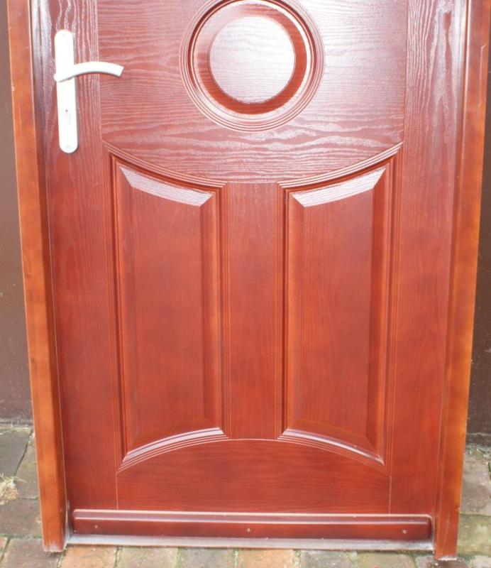

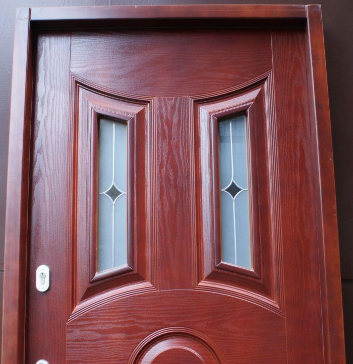

I need to remove about 10cm, so not sure if there would be anything solid in that portion of the door and I'm quite concerned about resealing the bottom.
I've uploaded a few pictures which might give you a better idea regarding what could feasibly be removed without ruining the door.
Best regards

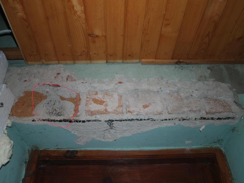

raising the lintel, cutting a small slot in the lintel (suspect this is a no-no, but not 100% sure).
Is the lintel covered in plasterboard or you just see the metal lintel?
A photo might help(?)

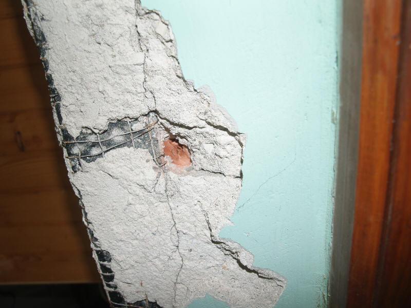

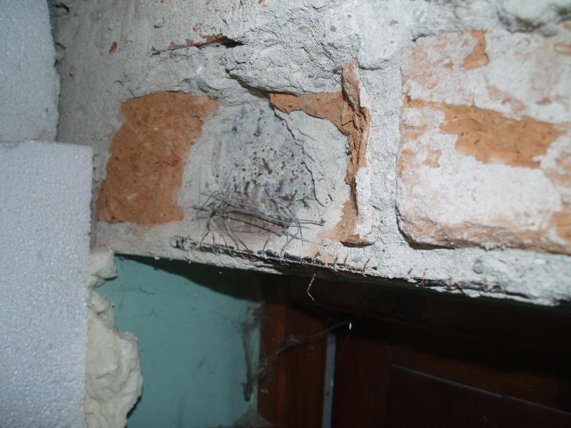

The interior wall above the door is plastered direct on to the surface. To avoid damaging the interior, I ran a metal detector over the wall above the frame and confirmed the lintel appears to be just behind the plaster. The exterior wall above the door has been excavated to the lintel in one area (picture attached), the square bricks are just facing bricks which are about 30mm deep placed on top of the lintel.
The only other thing I can add is that the walls on this older house are quite thick at 45cm, which at first gave me hope that the lintel may only be half that distance, allowing me to bury the top 10cm of the door & frame behind the lintel, not a perfect solution, but better than cutting the door.
Thanks for taking the time to think about this problem.
P.s the black metal line below the lintel is just a thin strap presumably to hold the mortar in place, the actual lintel starts just above the first mortar line, so maybe a gain of 2cm could be achieved by placing the door frame higher, but that still leaves 8cm to find.

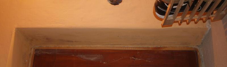

Sorry to be a pain, can you take a photo from the front and I want to see if I can see the lintel on the mortar joint, if it's rendered, may have to drill a small pilot hole underneath and hoping it will be more than 10mm
I did a little more excavating and the black strip is actually the edge of the lintel...Also, the front lintel is a lot smaller than I initially thought. Might be best to excavate more on the interior side to find out exactly where the second lintel is, but I will wait for advice. Many thanks!!

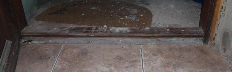

Also have a look at the bottom brickwork, is there mortar joint under the old sill?
There is a 20mm mortar joint which protrudes from the floor under the sill (picture attached) We did include this extra space when initially measuring. I have measured the steel H lintels and they are 7cm x 20cm x approx 170cm, each of which is set to the interior / exterior edge of the wall.

Okay, need one more photo opposite of above photo of the front under the sill
