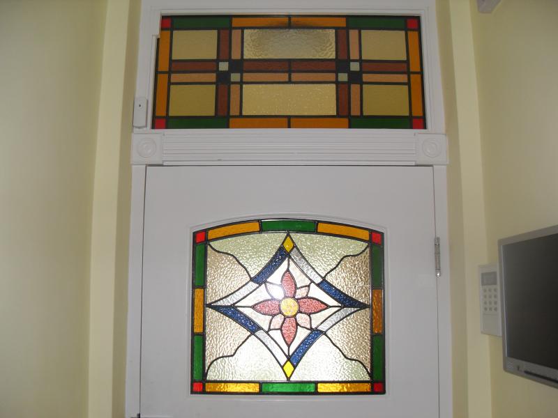

Done this many times, re-adjust the leadlight came frame smaller to put it inside the double glazed unit
This is my front door stained leadlight I've made, although hard to see, the fanlight and the door are leadlight inside the double glazed which is very hard to break being toughened glass & leadlight came being soldered together
Break my heart when people chuck out stained leadlight windows specially when it's many hours making it
