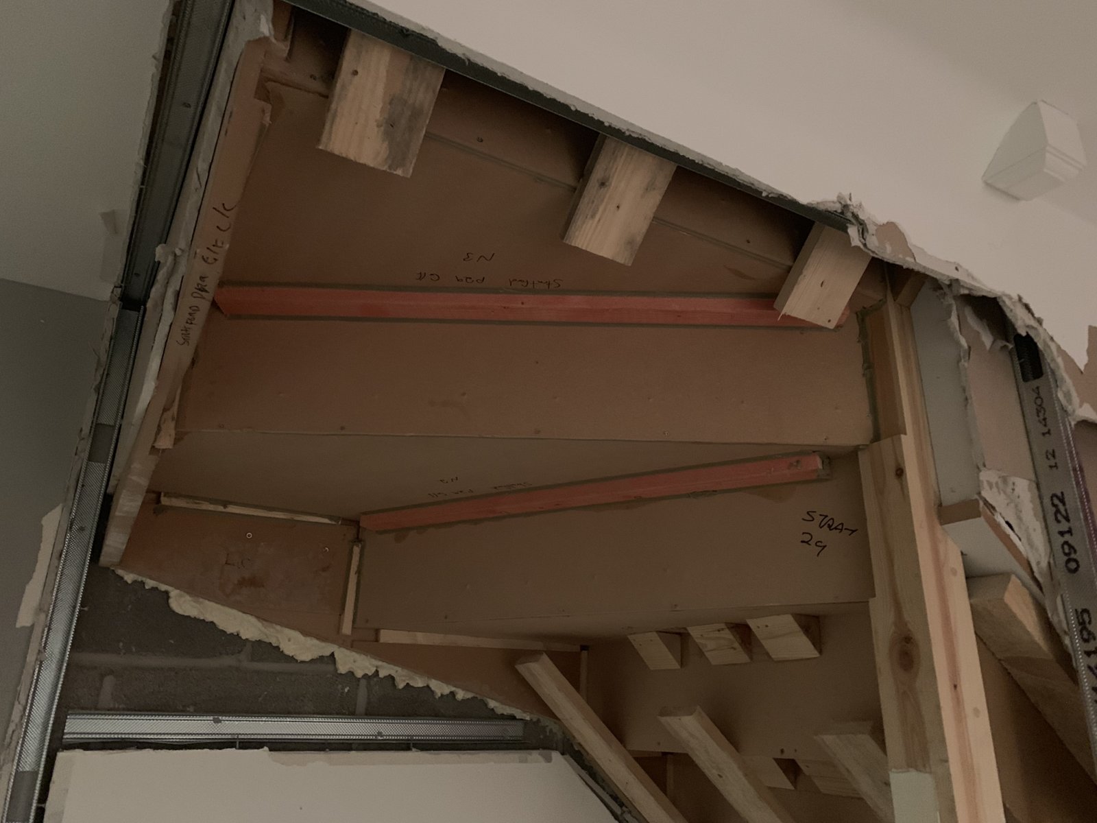

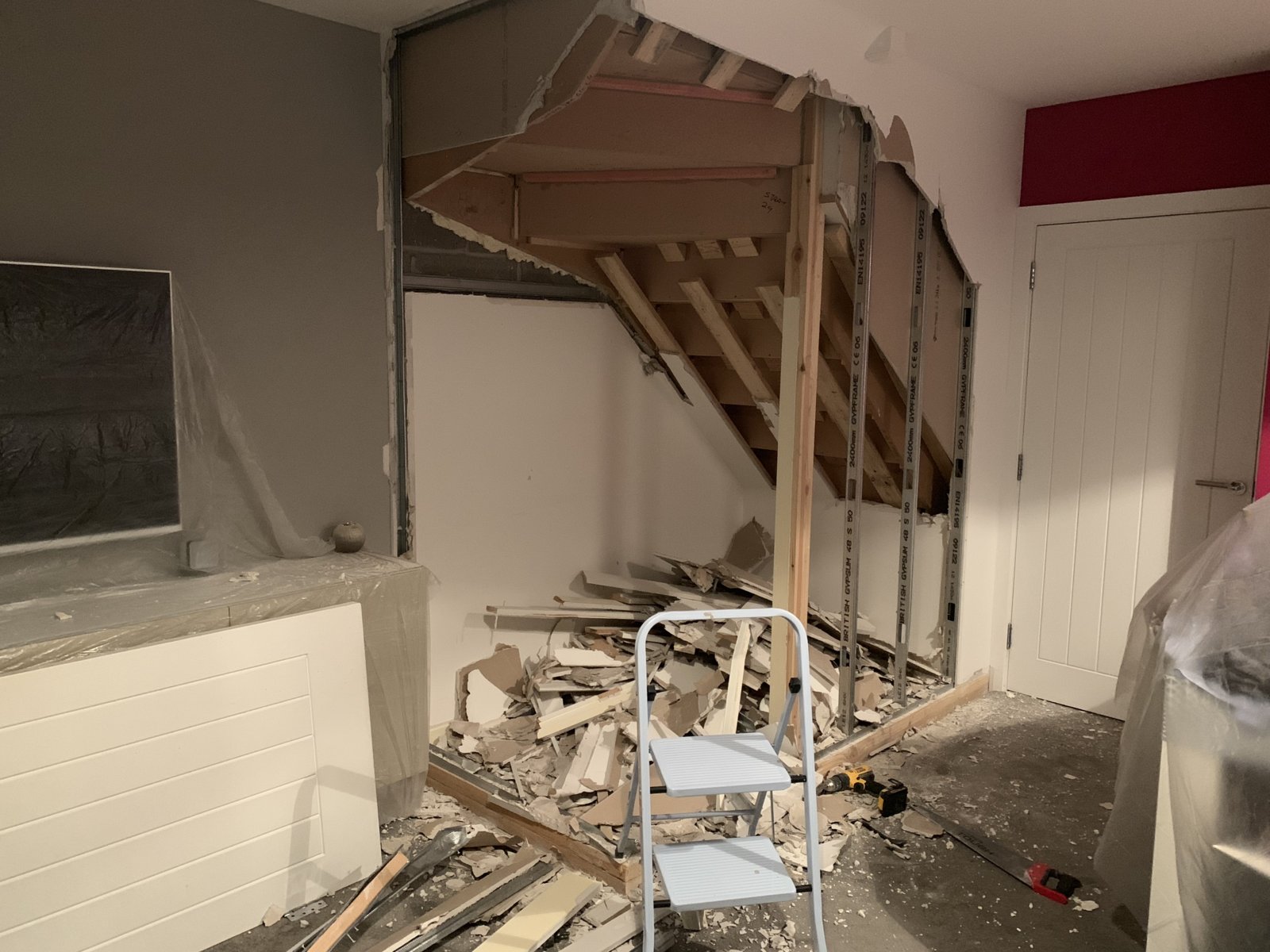

I need a quick solution to this one please. The newell post that goes to the ground in the photos I want to remove, not completely but cut it higher up so I can board the back of the stairs.
Is there a solution or would I need a whole new staircase to achieve this?

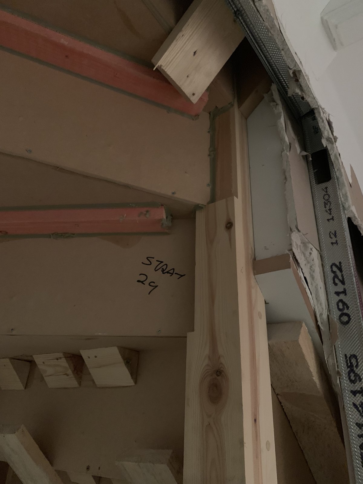

mikeinthemidlands, good evening.
That post looks like it is structural [as big-all above] i would not remove it.
From the images posted, the timber is supporting the stringer on the left as you go up the stair, also supporting the winders on the stair [the treads that turn around towards the upper floor]
Looking closely at the image, there is a load of glue? in there and screws to hold it all together.
