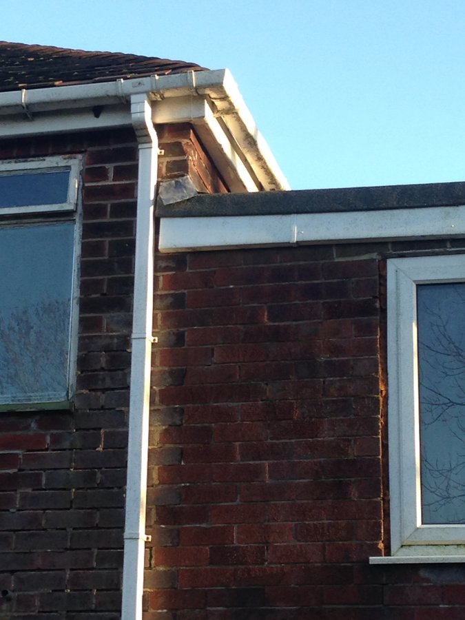

External shot showing the original house and lower extension with flat roof.

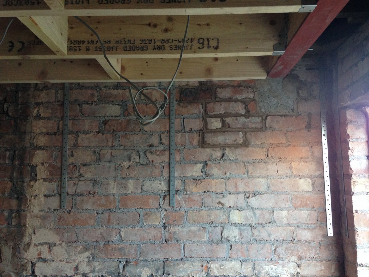

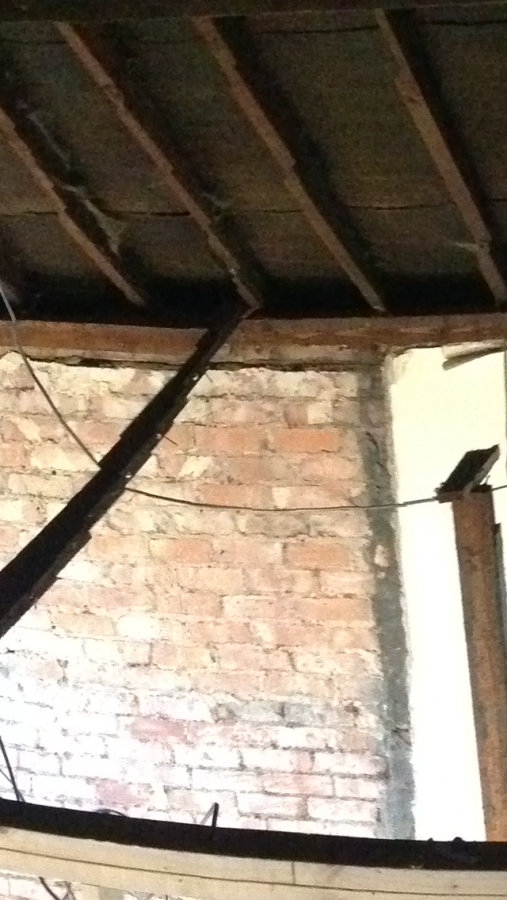

Fist one I did at the party wall side:

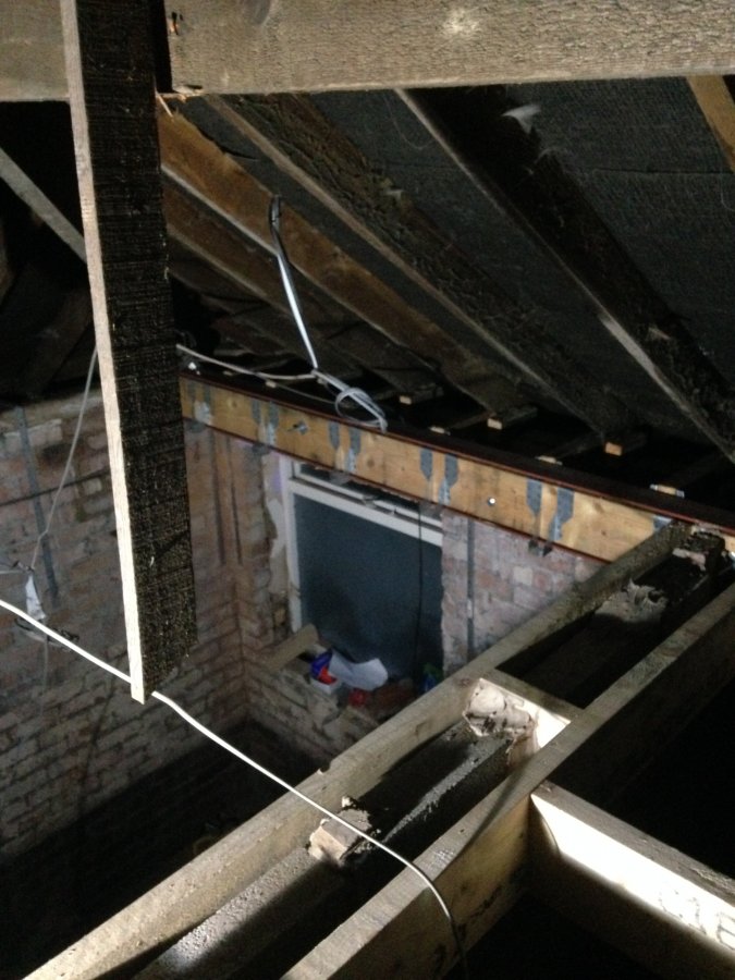

Centre on a supporting wall:

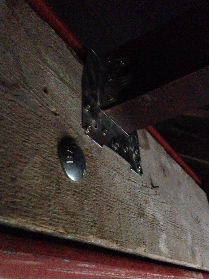

Hip end side with 4 straps, cut wall plate:

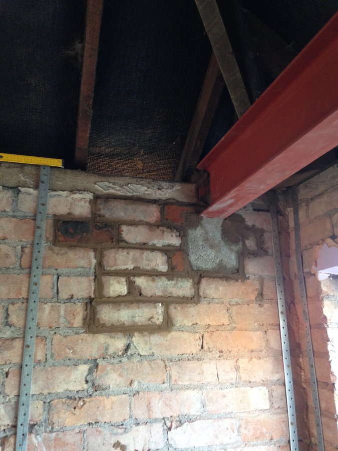

The second steel wants to be 120cm in from the internal face of the front wall. Which is where I hung this strap:
By the time I have 2 layers of the fire line board under the first steel the finished ceiling height will be 232.

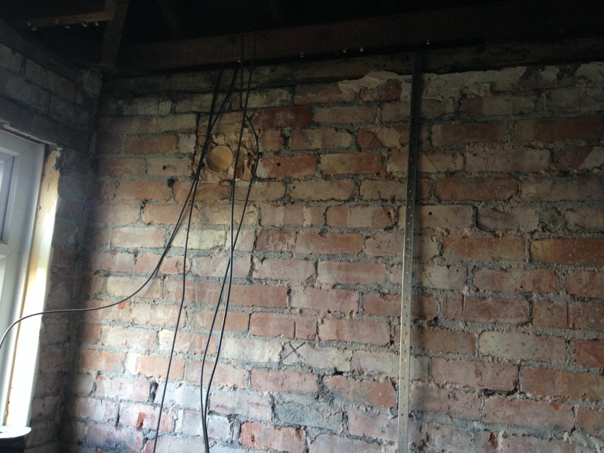

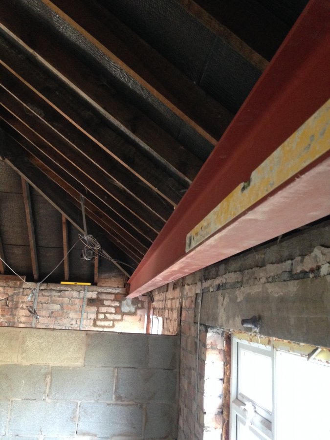

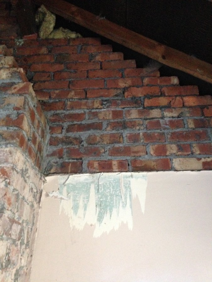

A few more pics of the first steel beam.
The second picture shows where the second beam will sit to the right of the chimney.

The rafters all sit on 3 X purlins which are 10x2's. They are supported by timbers which were built up from the bedroom floors.
I had to remove one of them so I propped each side with a long acro while I rebuilt a wall then put a piece of 8x4 on top.

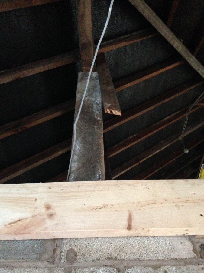

I have no idea about the spread. I reinstated the 3x2's that were pinned to the wall plate (but not the rafters) by bolting a timber into the rear of the RSJ and connecting like this:

I earlier noticed a few stubs of joist but are you saying that that is how both wall plates will now be tied into the steels?

AAMOI: the keyed-in join of the new extn brickwork to the old brickwork has developed aa opening thats been pointed up -
just to the right of the down spout - perhaps the down spout was dropped there to divert the eye?
