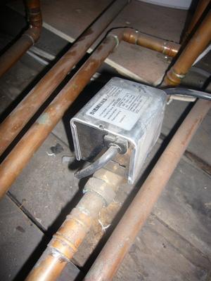

Ok, had a look at my cylinder up in the loft.
Overall view:
Bit closer:

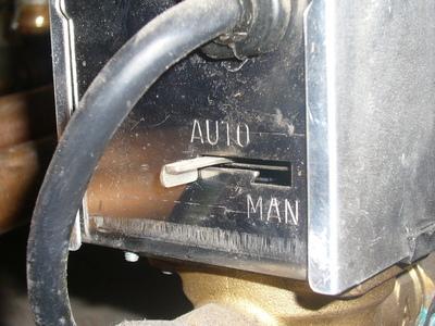

The bottom box is a Siemens 2 port 22mm valve actuator:
it is set to auto

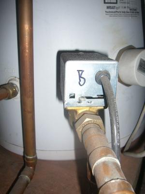

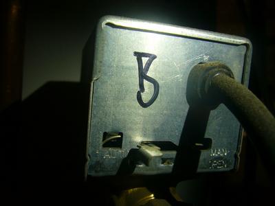

Top 'box' (marked B) says Honeywell where it joins pipework:
also set to auto
So I assume, based on Kevplumb's post above, I should have S plan (2 x2 valves)...
Is there any obvious solution, based on these pics, to my original query?
(thanks - total novice here)
Well... there are regulations regarding correct and safe installation of unvented cylinders. There is a special qualification (G3) that plumbers are supposed to have to install or mess with theses things - correct wiring etc is more of a safety issue than with vented cylinders.
who installed that cylinder?? the tprv outlet goes uphill! The feed into the combination valve looks like its teed into the balanced outlet?? !!wtf? more pictures please! all of the cylinder and its pipework. See what else they did wrong. No way was this done by a competent person.
