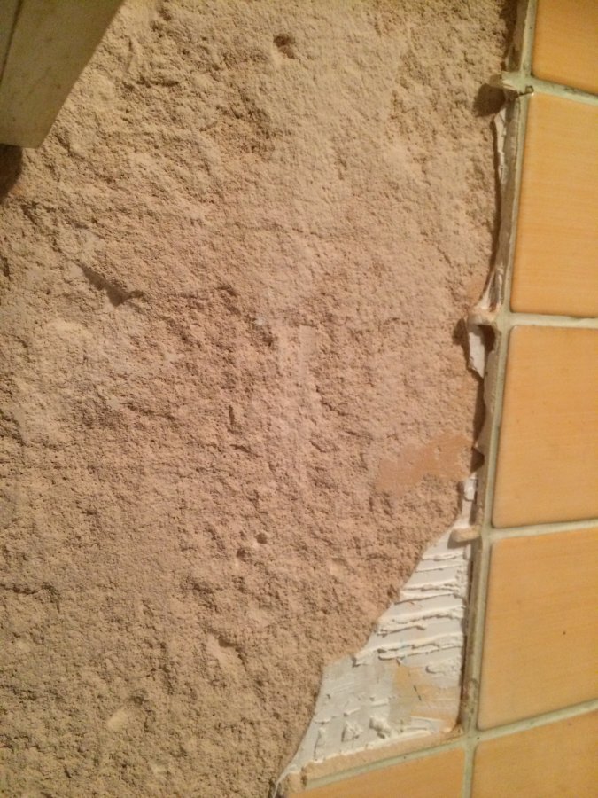

Hello,
I'm in the process of decorating my kitchen and I've been removing the old (fairly uneven) tiles and also chasing out some bit of plaster to add new sockets and wiring. Removing the old tiles from the splash backs so far has left the old plaster in quite a bad state. Moving forward I want to re-tile but I'm unsure on the best move next...
I could get them re-skimmed but this is something I'd need to get a plaster in for as I'd struggle to achieve a level-ish surface to tile on.
My other idea was to fully remove the plaster in these areas and and fix moister resistant plaster board to the blockwork. In an area where I have chased out the plaster it looks like there is 18-20 mm depth from the undamaged plaster at the edges which didn't have tiles to the blockwork. I was thinking to keep within the same sort of depth us 12.5 mm board with something like Everbuild Pinkgrip Dry Fix. Or could the plaster board screwed to the blockwork? I assume this could be ok to then tile straight on to? This is something I could do myself.

You would be best off removing all plaster back to brick, and rendering with sand and cement for a new tile backing.
Avoid using any plaster board.
Is there any sign of damp in the splash back or on the wall below the work top?
What condition is the outside wall surface in - is it rendered?

As far as the plastering is concerned, it does require remedial work, if you are tiling over it, it does not have to be perfect, but the flatter/evener it is the easier the tiling will be. You could try using one-coat plaster, that can be sanded down once dry

Yes the wall seems totally dry, no signs of damp. The broken plaster is bone dry and below the splash back behind the cupboards is totally dry.
I liked the idea of using some sort of board as it looked easier to get a flat surface. I've tried plastering and failed in the past. Never tried rendering before.
I'm aware the surface doesn't need to be perfect for with me being someone who doesn't tile regularly I though having a totally flat surface to start would be good. I'm sure someone with more experience could cope ok with a more uneven surface.

If you are happy fixing backer board then do it but it can be slightly more difficult than it seems to get the boards plumb and flat while keeping them tight to the brickwork.

Ok I see you're point about boarding. I've not tried rendering before. I'll have a look on here for some info on it. Any tips for first time rendering?
