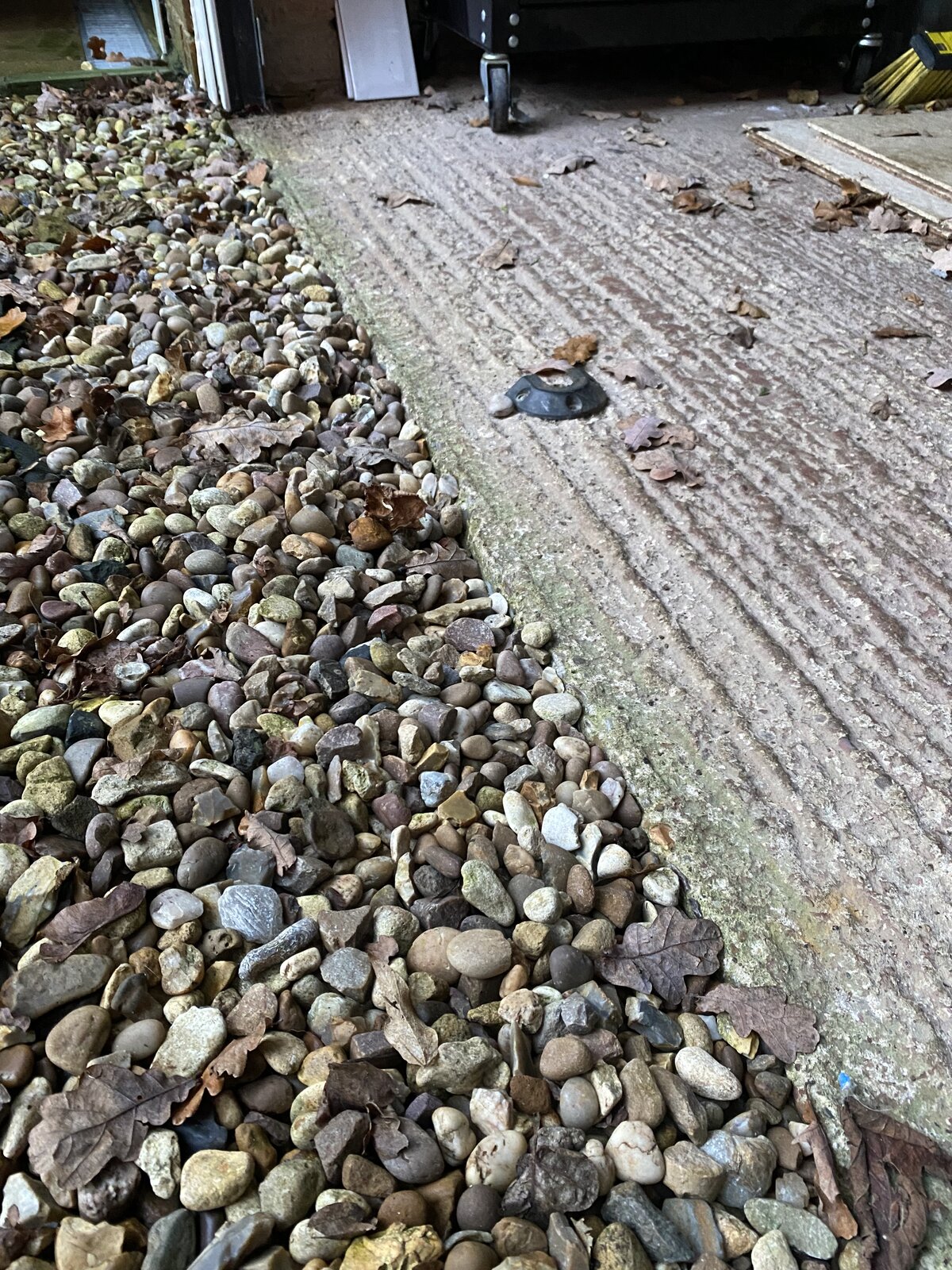

Hi All,
I’m sure this has been covered so many times, but looking for some first hand experience as to how I’m best to fix this issue.

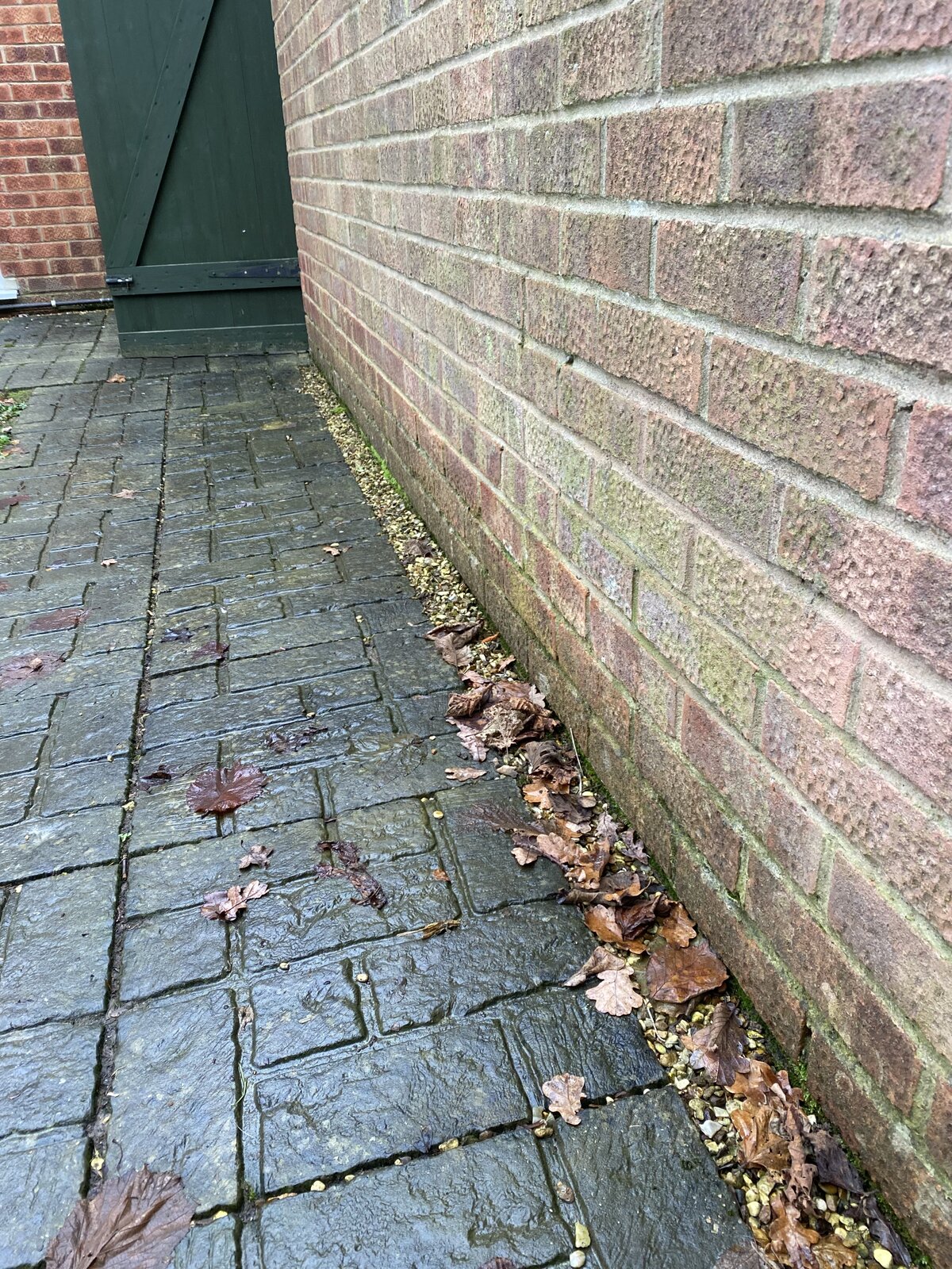

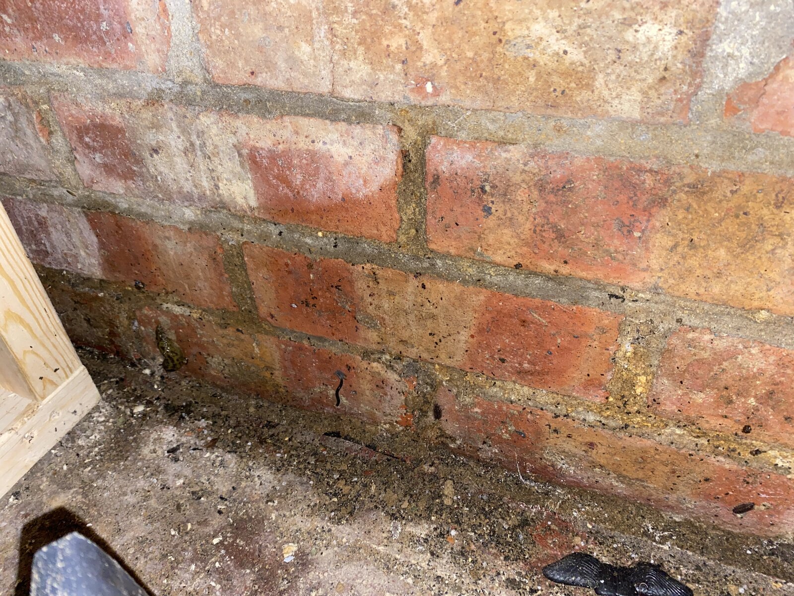

I have a small single skin garage where the lower bricks are damp, and this dampness is soaking into the garage as you’ll see pictured. From what I can see, there is no DPC, and I believe this is common for the age of the property.
I’m leaning towards bitumen painting the inside and outside lower courses, but keen to hear other suggestions? The dehumidifier is working overdrive at the moment and my tools are rusting, so desperate to fix!

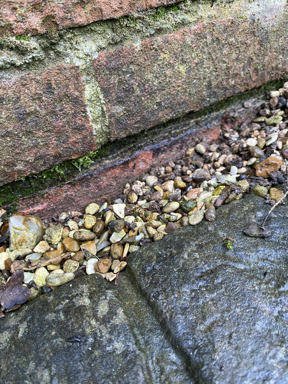

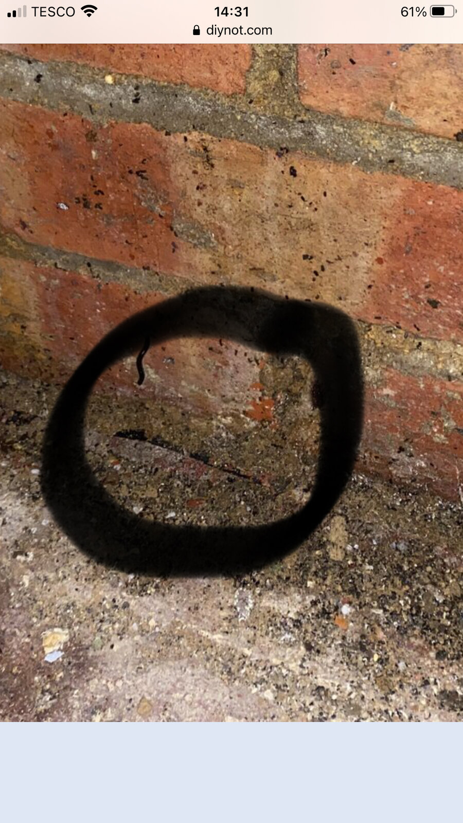

I believe this is the membrane under the concrete slab, 2 different things I believe?
Ventiallation is not an issue as I have 4 air bricks (I hope that’s sufficient for a single car garage anyway!)
Hard to believe then that whoever built it had the wherewithal to fit a damp proof membrane under the floor and not a damp proof course.

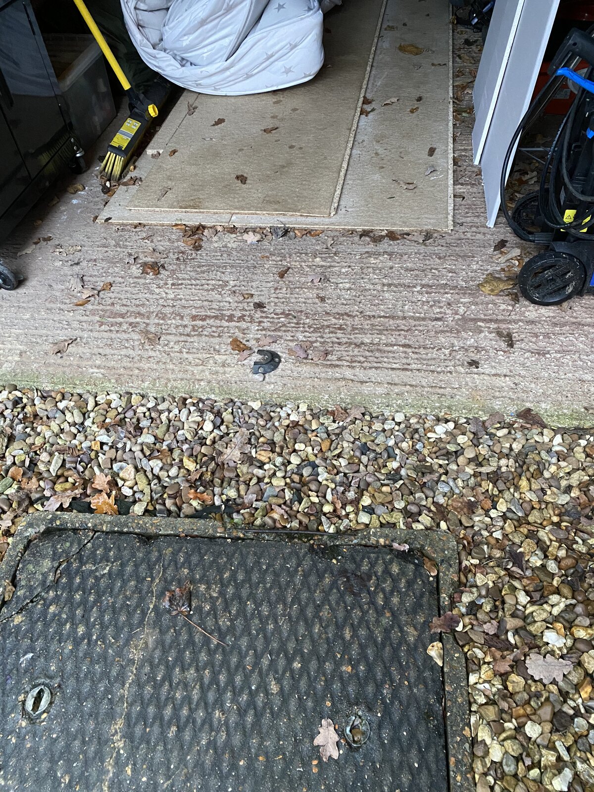

can we see the door and it’s relation to the level outside?
Is there a step up to the garage floor, in other words has the damp bridged from the slab inside?

Here is the door:

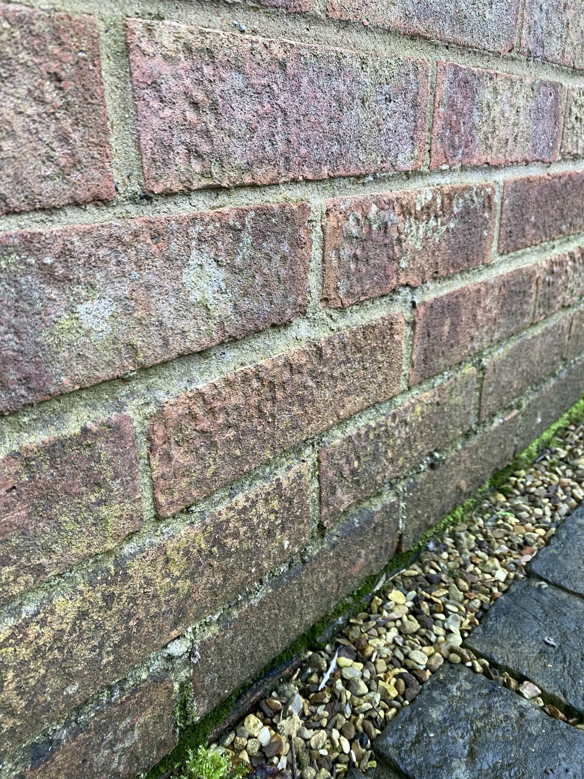

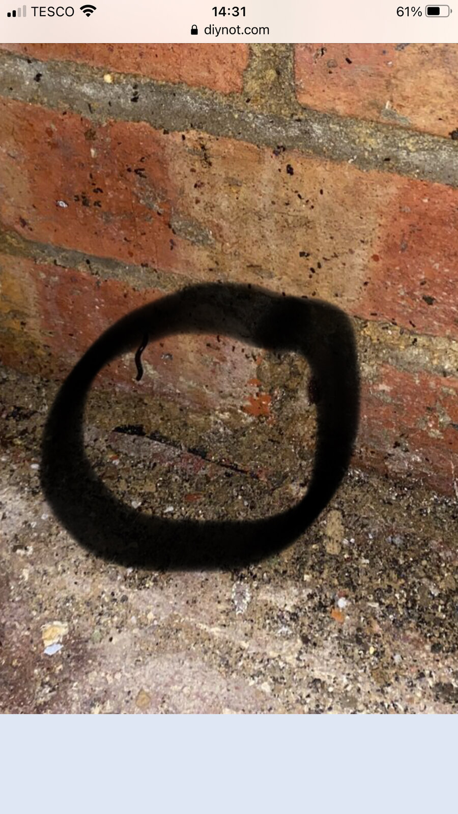

My thoughts exactly, but I honestly see no trace. From what I can see, it could do with some repointing which would clearly help. Here is a photo of the first few courses:

It’s all level. You could install a chemical or physical dpc , but the outside ground level is too high anyway. my preference would be tanking about 5-6 courses up on the inside. Others may have different ideas.

Looks like the original dpm lapped into the bricks but the level outside was raised when the patio/pavers were put in. Although there is shingle laid the rain can still "bounce" above the dpm into the lower bricks, hence the damp. Repointing would help.

Thanks Blup - I’m planning to repoint along the lower level, and then slurry the external and internal first few courses, does that sound acceptable!?
tank inside , repoint outside . tanking outside will look awful and trap moisture in the wall.

I have done this by applying 6 or 7 coats of bitumen based paint (internally) and kept the damp at bay, ideally the bricks should be allowed to "breathe" though.
