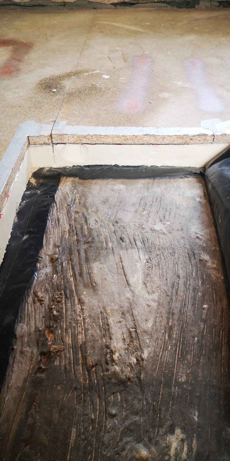

The bumpy surface under the dpm must be the cement slurry,sorry, not the screed. The celotex is above, then the chipboard sitting on the celotex.
The shower wet room is next door, but the damp is on the opposite side of the room. It was built about 6 years ago.
So it's a floating floor? Working from top down.
Chipboard
Celotex
DPM
Lumpy screed?
If correct, I'd be erring to bridged brickwork as damp perpetrator.
Yes.

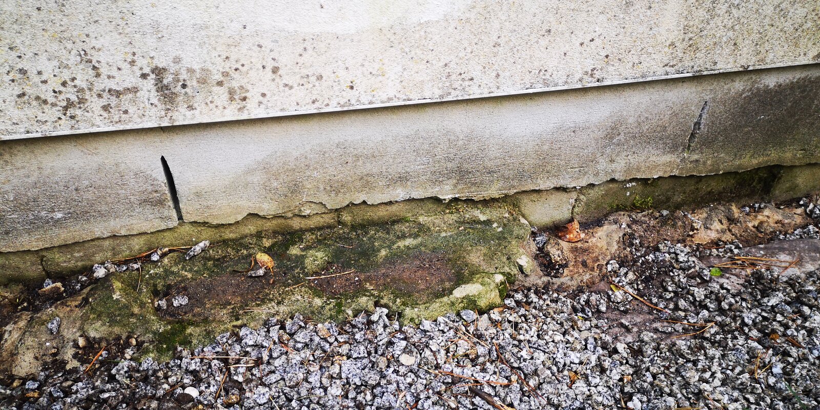

No air bricks in the external walls, just these slots on two sides

The slits in the render outside will be doing nothing.

So little/no ventilation through those slits, would they need to be replaced with air bricks?

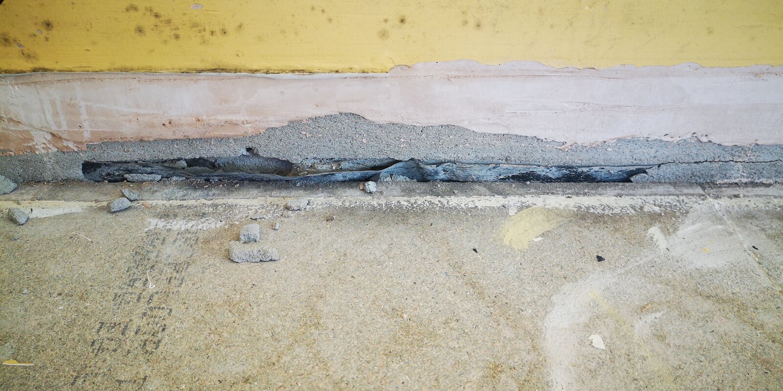

I've removed the skirting. You can see the dpm just extending up

Looking at the staining on the chipboard and mould on the wall, I'd be looking upwards for the cause of that amount of damp. You need a really thorough check of the roof, gutters, downpipes, fascias etc etc.
Alteratively it may have two membranes, the one you've seen above the slurry and another below it and/or the block & beam. It's possible it was sealed up while everything was wet, so what you're seeing are the few hundred litres that were sealed in on day one. Perhaps it just needs airing and drying out, and there isn't a cause of damp other than what was poured into the mixer on the day it was built.

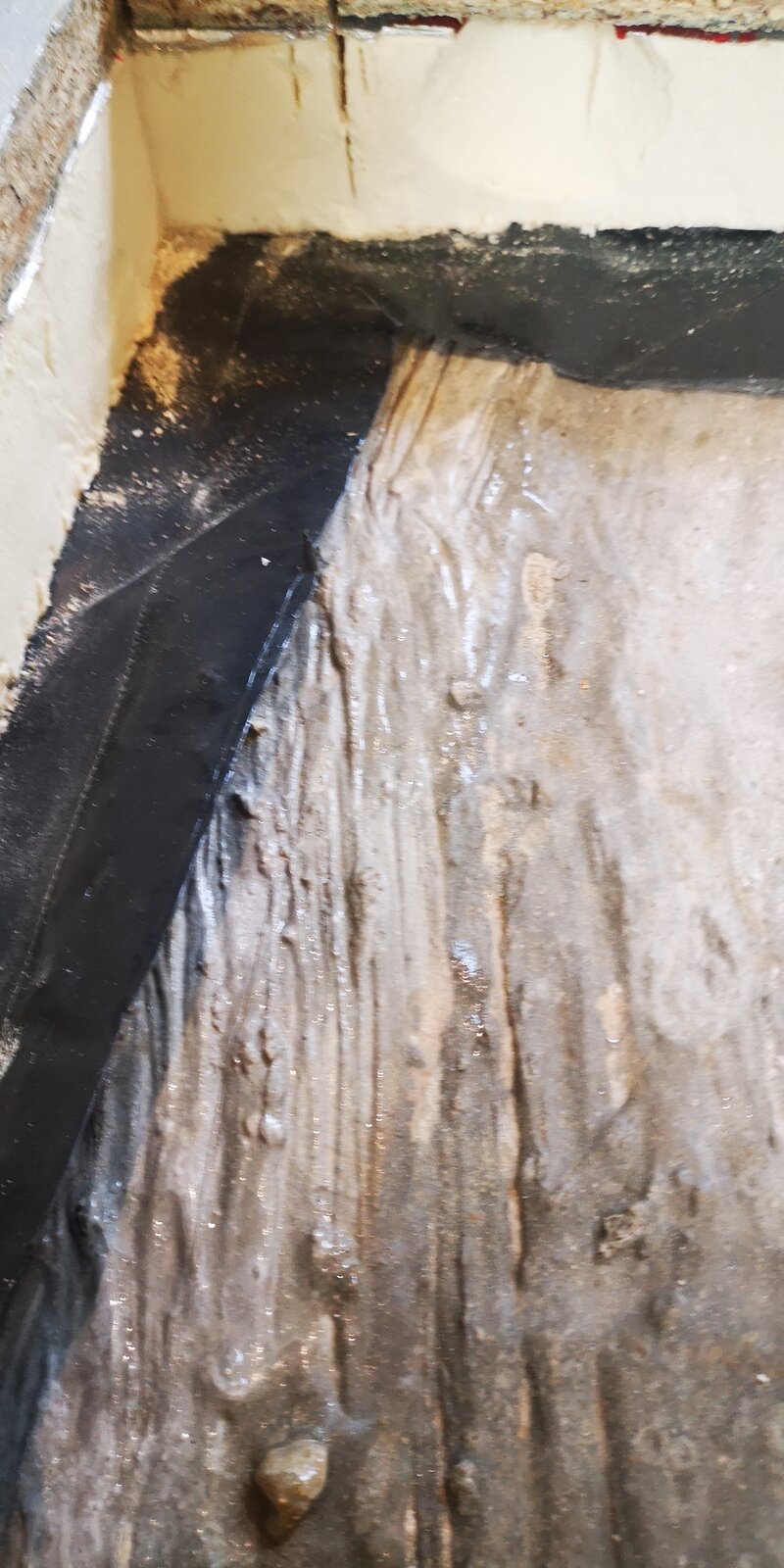

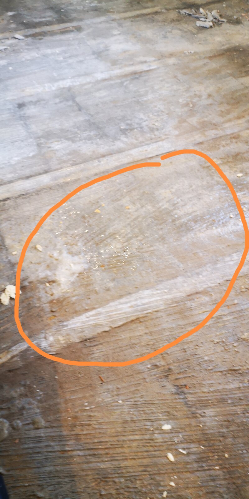

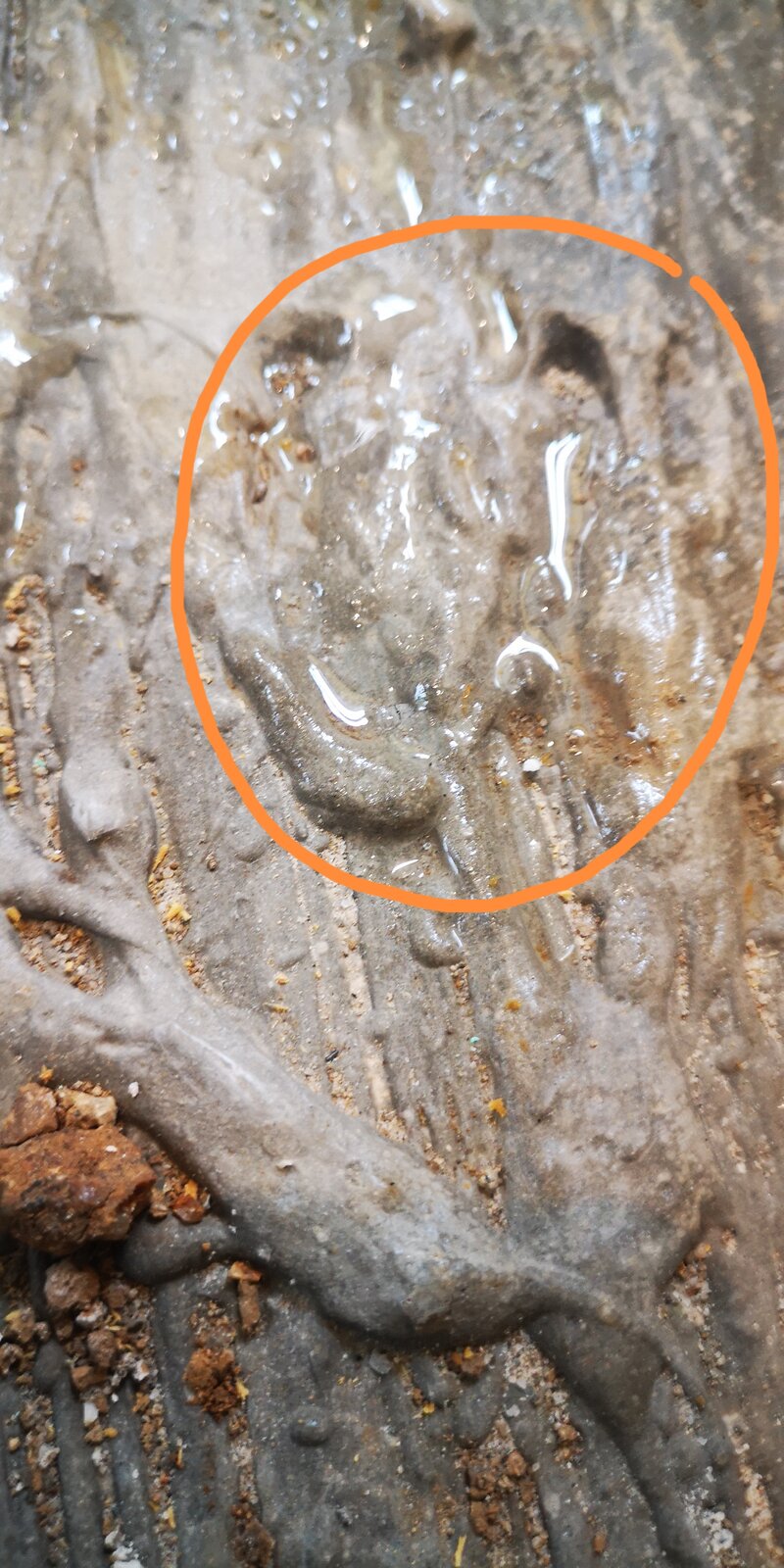

Just pulled the floor and dpm up and found pools of water on top of the slurry a couple of mm deep, towards the middle of the floor and droplets elsewhere . The bottom of the walls look to be dry.

Wondering if it's condensation, the bottom of the B&B floor could be colder/more vapour and possibly there is no oversite.
Lack of ventilation could also contribute.
Can you take some pics of the outside wall please.
Do you know (doubt it) how much space there is from bottom of B&B floor to ground?
You're very unlikely to get running liquid water rising up from the ground, unless it's a cellar.
Either this water was sealed in on day one when it was built or it's pouring in from somewhere, or you have a significant moisture source (e.g. steam room, shower, kitchen), and an absence of ventilation.
Fair point.
Surely after 6 years it would be dry?
I don't know what you have, but often two membranes are used. One is under the insulation, the other above and the edges of both are trapped in the wall. Basically it's a giant cornish pastie. If there's a few hundred litres between them then it's not got anywhere to go, ever. It will dry out as fast as the contents of a bottle of water, i.e. never.
It's very difficult to understand without seeing it, this is merely a suggestion and something to consider.

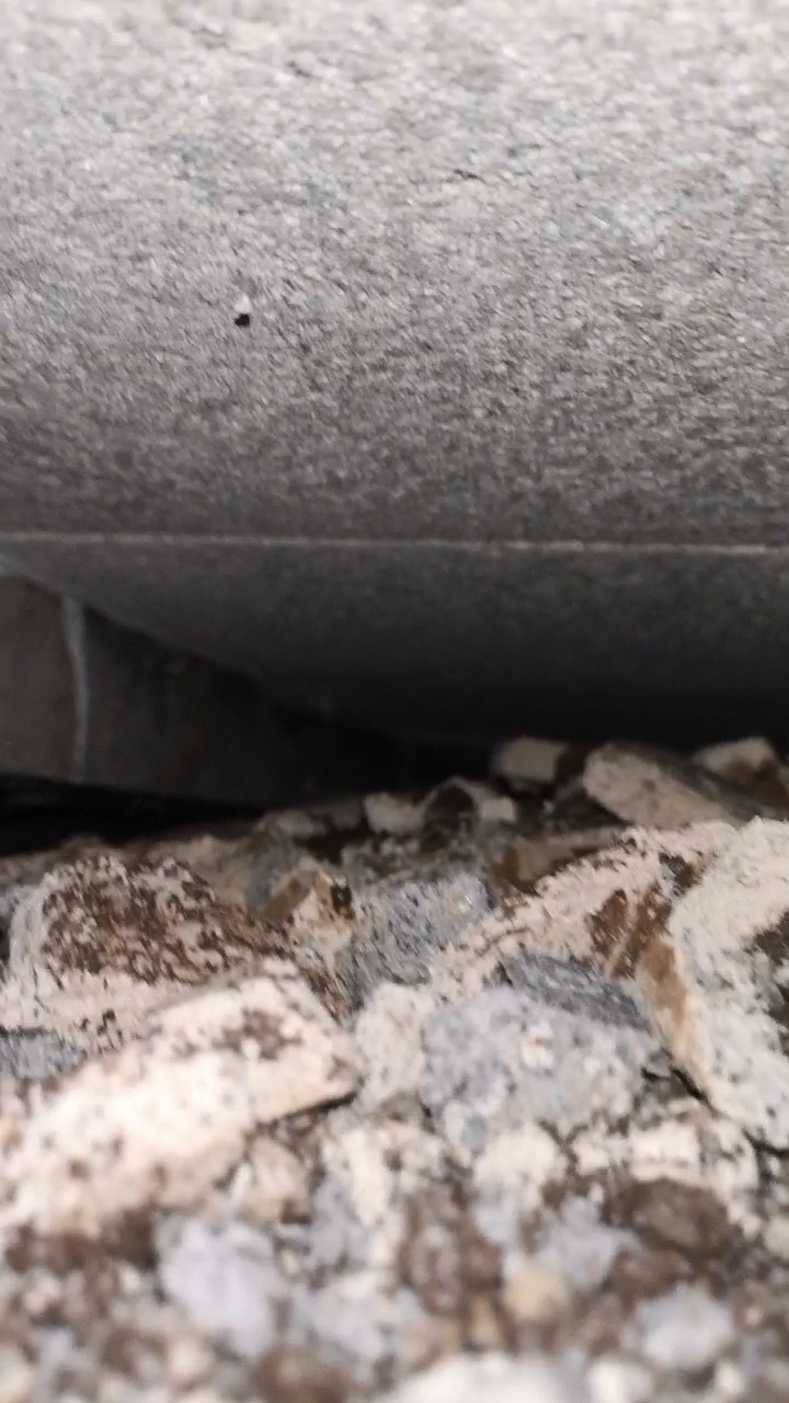

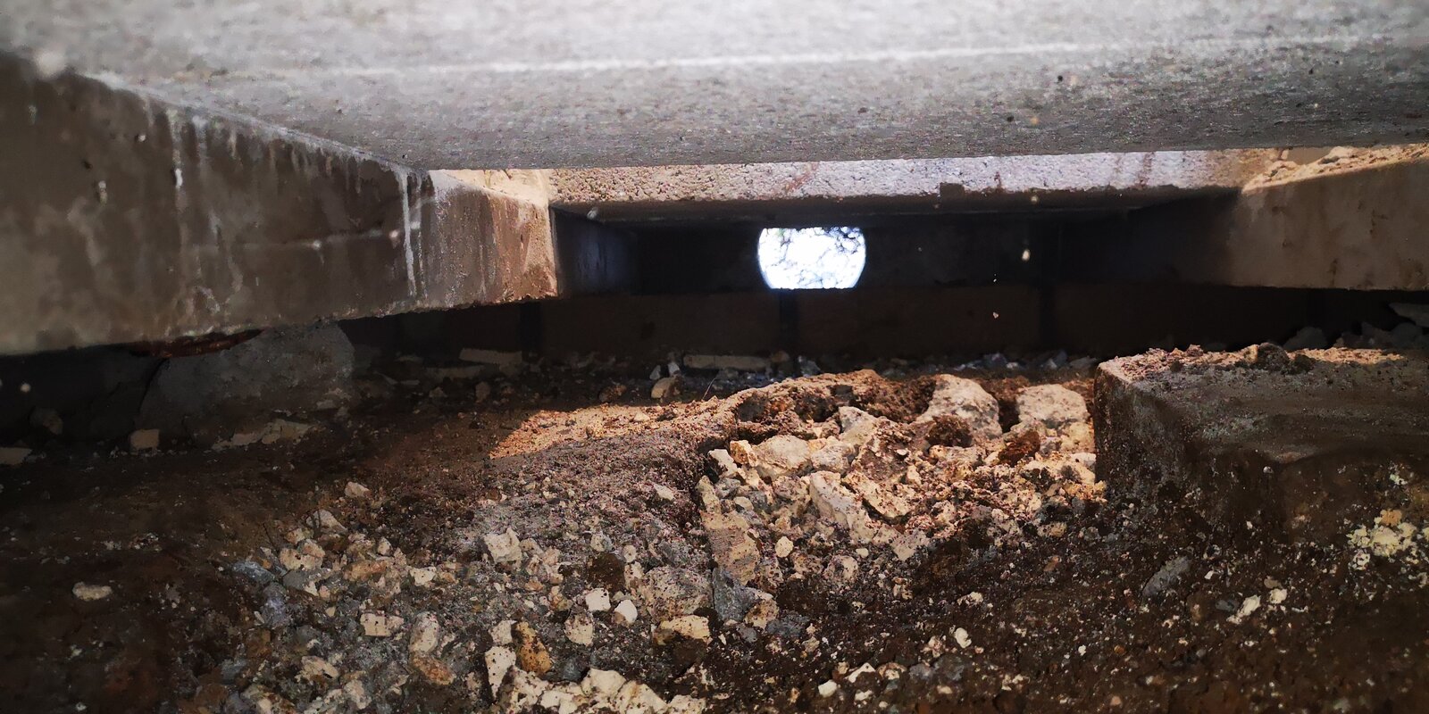

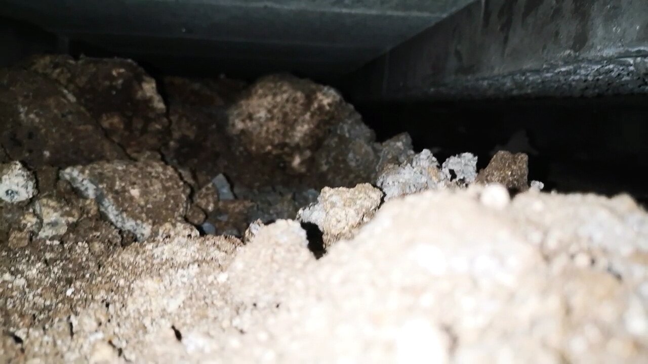

I think I've found the cause of the damp. I've broken some blocks out of the floor to see whats going on underneath, and found stone, soil, and bits of plasterbord, which I've started to clear out. It's all very damp, and hardly any, some places no gap for air movement.It looks like soil underneath that. I've core drilled three 110mm holes on either side of the outside wall for ventilation.
