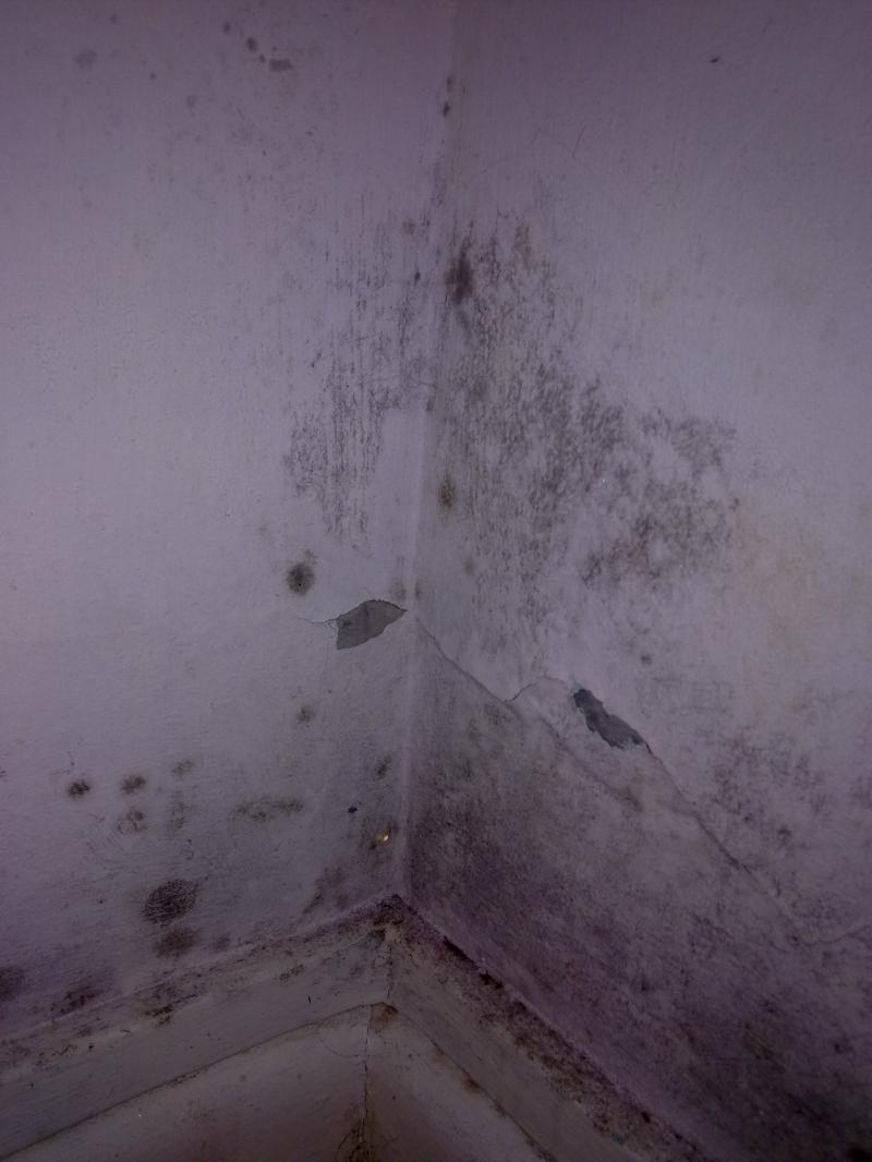

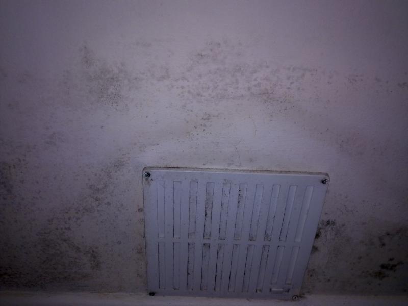

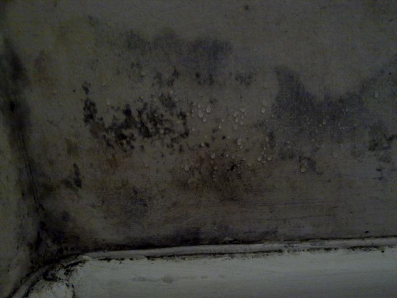

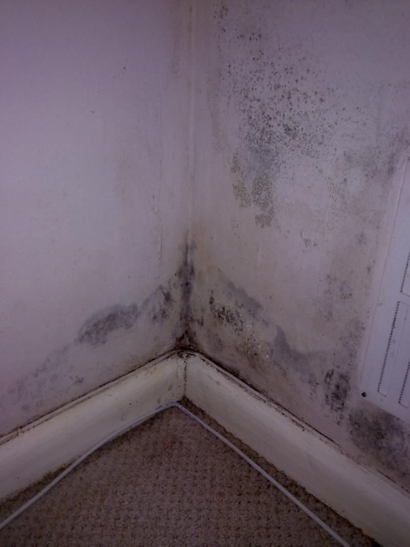

Well there coming tomorrow morning to do the Flatmast so hopefully it will help with the problem. Funbags i totally understand what your going through. Heres some pics of the damp and mould x
