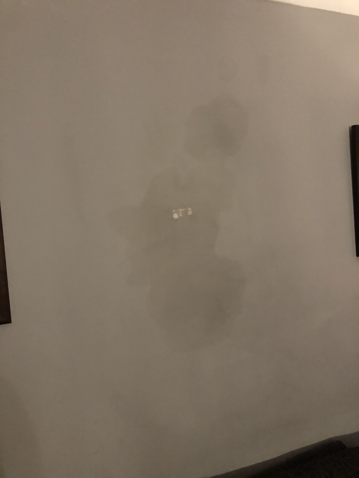

Hi,
We live in a semi detached house, our house has the chimney removed up in the loft. Our neighbours, who are council, have theirs still intact. We have a nasty damp patch appeared on our wall that adjoins the neighbours chimney, this is always there but gets darker and lighter in certain conditions. The council are saying it’s not their problem but we have no pipe work or a chimney on our side so the problem can only be theirs? Anyone have any ideas?

Presuming that its not a bare brick wall then
When the loft chimney breast was removed maybe the backwall/party wall soot was not cleaned off but just gypsum plastered over?
The solution would be to hack off the existing damaged gypsum plaster, wire brush clean any soot, and render back up with a sand and lime mix.
One way or another you will have to hack off the damaged area. So maybe start by doing that and exposing your background.

Barring any leak from the stack, these look like tar stains from the chimney flue.
The only way to stop them leaching through, is to remove the plaster and coat the wall with a suitable barrier liquid, then replaster.
This is being caused by the neighbours flue, and you could require the council as landlord to remedy the situation or compensate you for the damage and repair costs.
