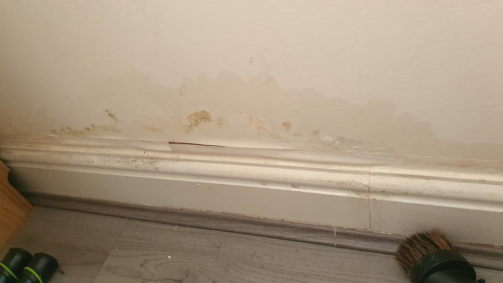

Hi, I recently discovered a damp patch in our living room. Its below the window but nearer the floor.
It also looks like the cavity wall insulation is wet as it's expanded and paint it coming off.

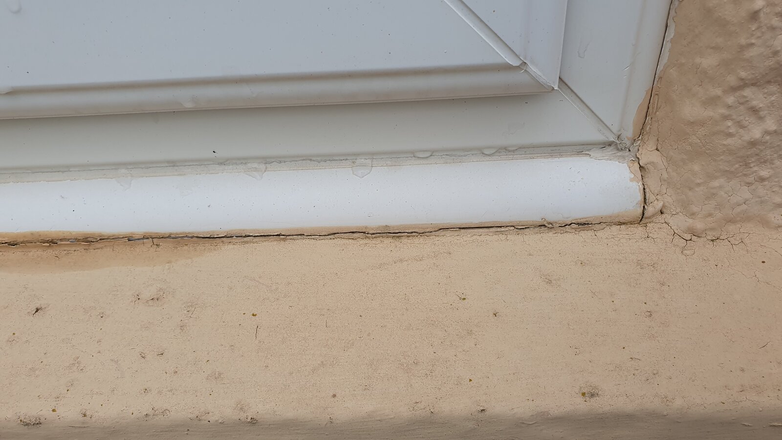

The windows also need resealing as the silicone is pretty cracked.
Question 1 is whether the cracked paint and/or sealant could be the causes or if I should be looking for other (bigger) problems?

The low level damp suggests a bridged or damaged dpc, possibly exacerbated by the non traditional construction of tne house. Apparently there are two types of easi form construction.
Don't paint it until you've cured the problems causing the damp.

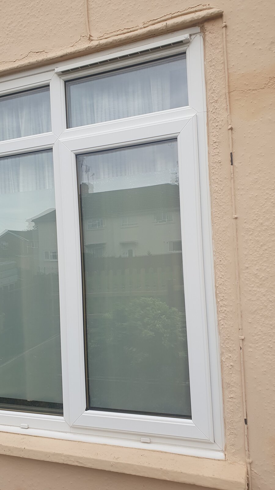

Where is this damp insulation you mention? Water might be getting into the cavity from a defect round the window, but I can’t see it.

Thanks, it does make sense that it would be coming up rather than from the window based on the position of the patch.

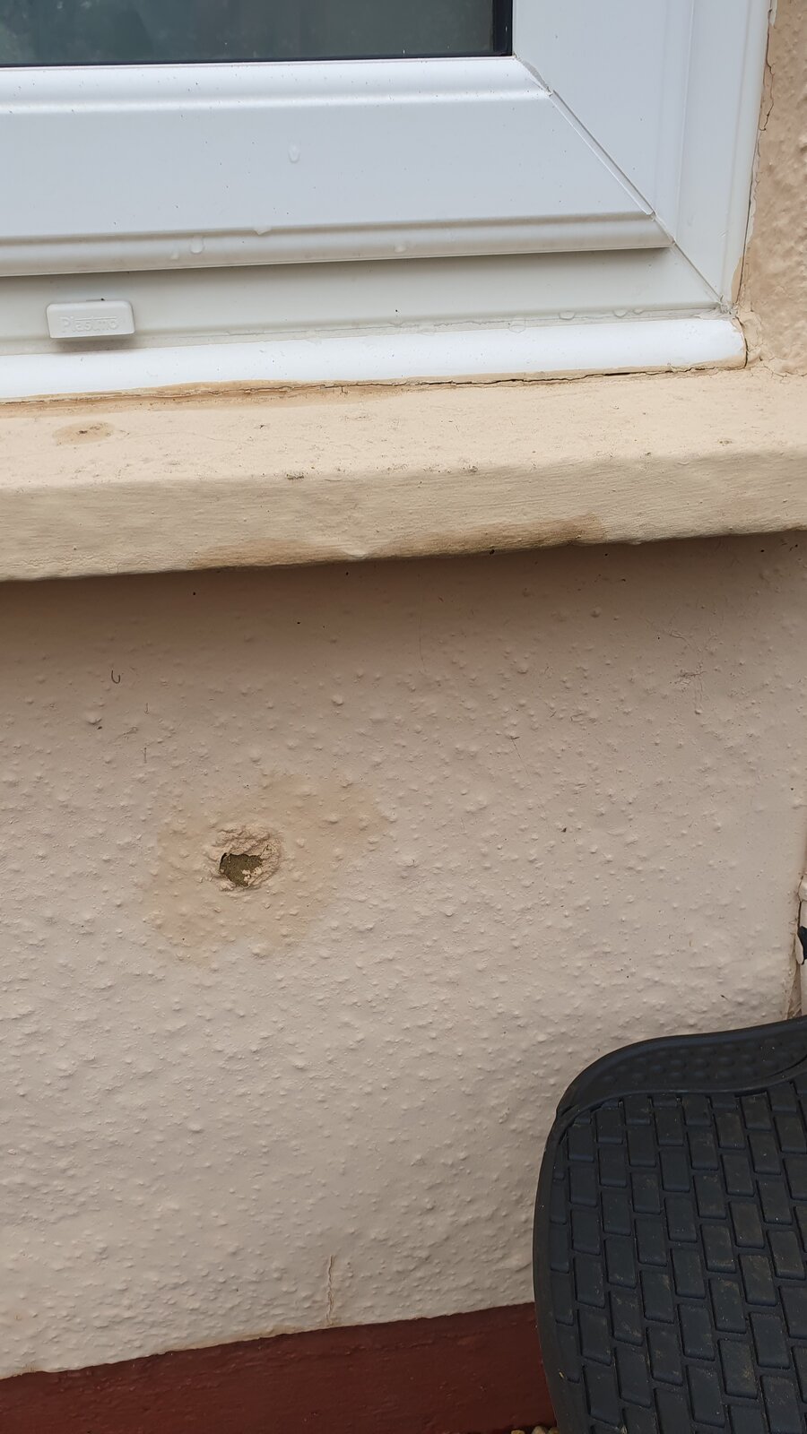

Im not sure that the insulation is wet but just guessing it might be as the round patches on the outer wall have blistered a bit and the paint on the one closest to the damp patch flaked off on touching (see pic)

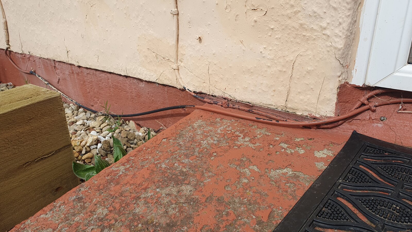

I can't see the dpc, Im guessing its at the line where the red paint stops.
Did notice that the concrete step by the front door comes pretty close to this line although thats about a meter from the damp patch. Maybe pooled water on the step could come over the dpc?
When looking for the DPC, look all round the house. If you find it anywhere, it is pretty sure to be at the same height. It might be visible at a doorstep, airbrick, or broken render. If you have any unplastered wall indoors, e,g. In a cupboard or under the sink, you might see it.
The red part might be a concrete slab, rather than render.
