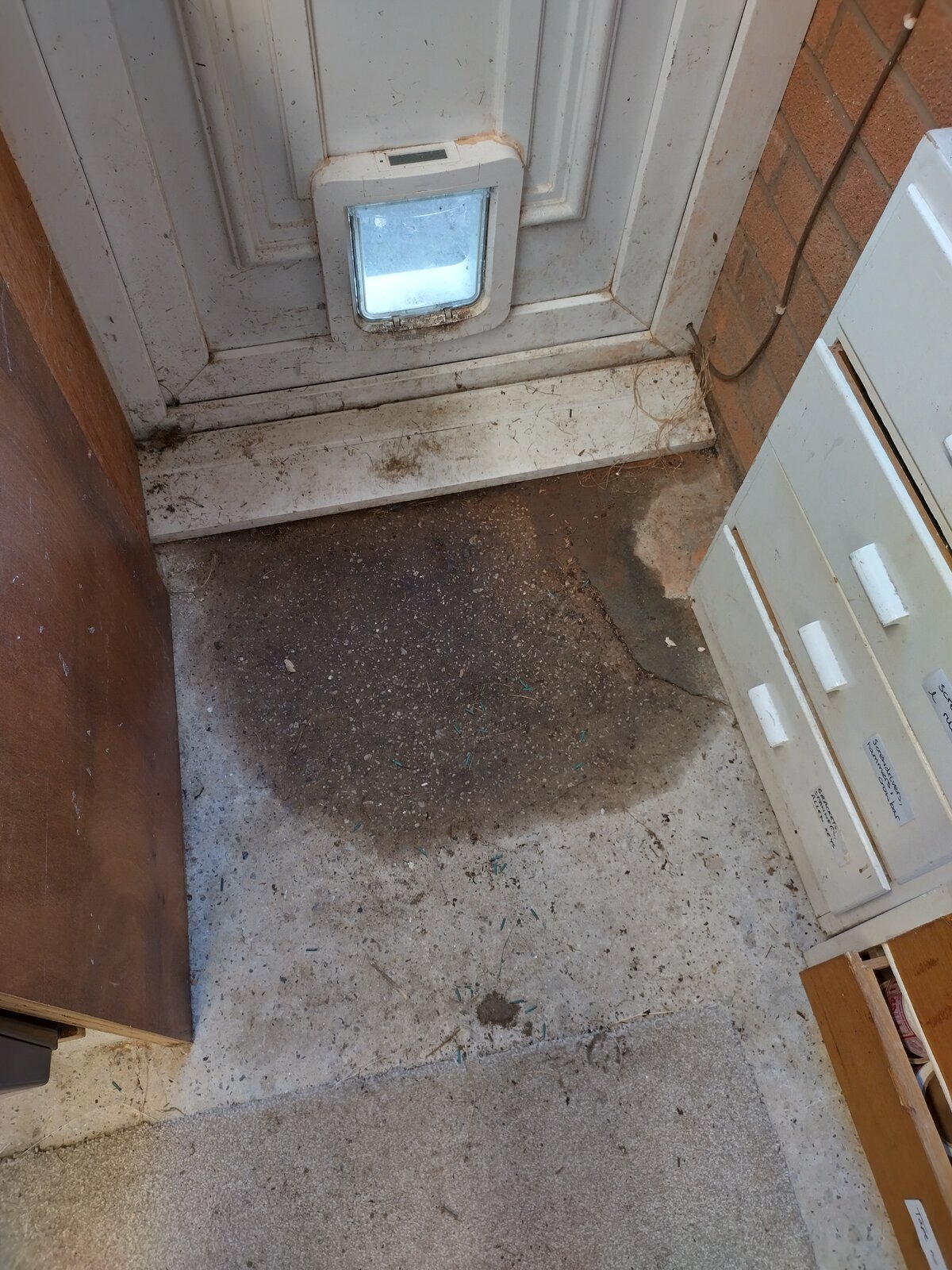

We have had a damp Patch on the garage floor for a good few weeks now.
It's right near an incorrectly fitted PVC door (IFD). The door has been like that since we moved in in June 1999.
I thought there might be water getting under the door, but I sprayed a hose under there for 20 minutes and nothing came through the other side.
Next to the damp patch is a washing machine but there's no sign of leakage there. Besides, the damp patch does not spread that far, on the surface, at least.

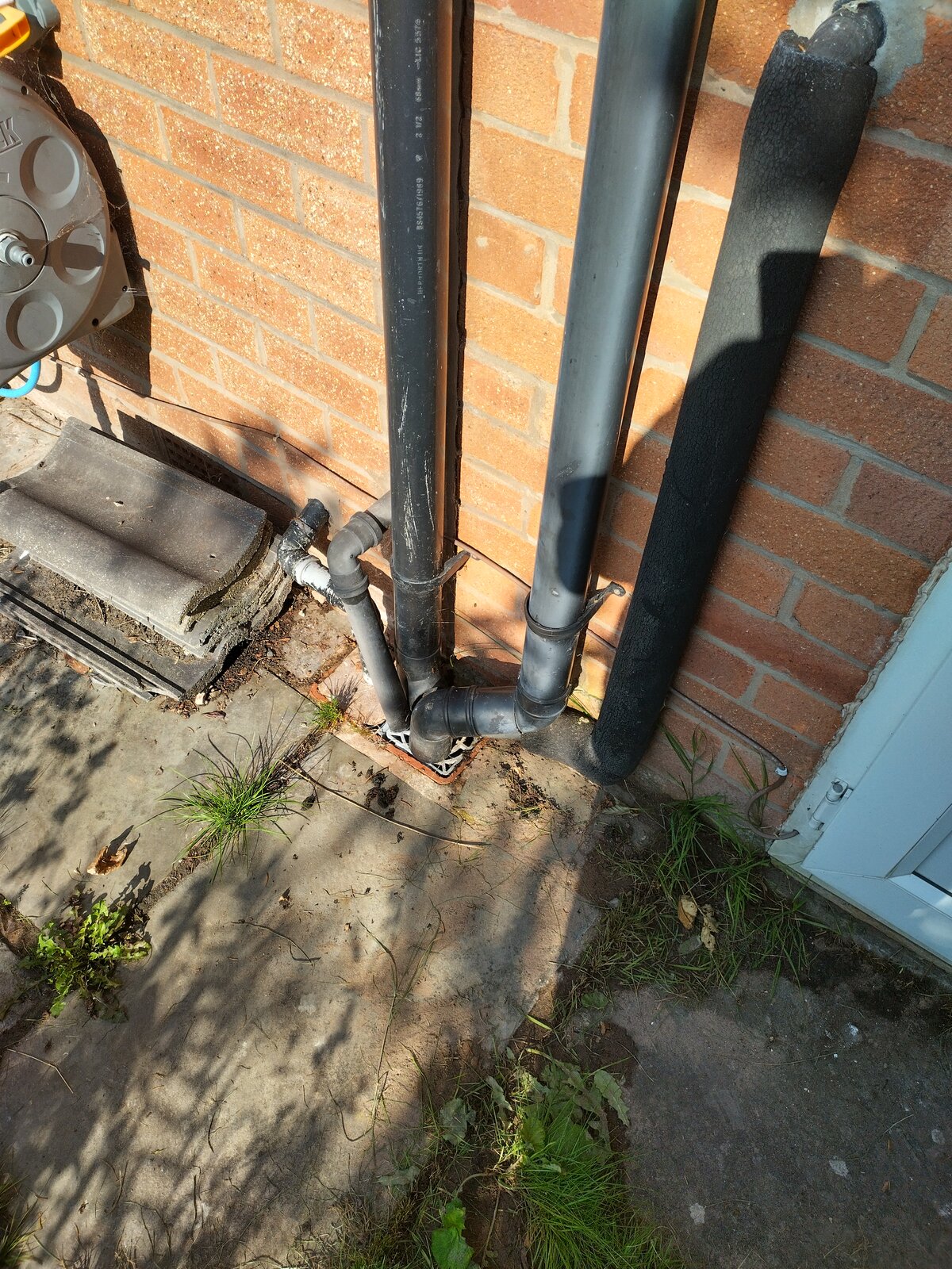

But outside, next to the IFD is a drain that has been added to over the years and is overcrowded.
Sometimes, I go outside and see that water has overflowed from it. The edges of the pottery are crumbling and I'm wondering if water is leaking into the surrounding ground and up through the concrete area inside the IFD.
Is this remotely possible, or am I being daft?
The WM is just to the left of the damp patch behind the ply panel.
The IFD is just to the right of the drain.
I'm wondering if I should lift a flag or two and see if the drain is broken, or try to find out why the ground underneath the flags is saturated.
Glazed clay pipes and gullies are, IME, always cracked or broken and leaking, usually at the trap or the bend where they turn from vertical to horizontal.
However my experience has mostly been in houses on London clay built before 1945, which were generally subject to movement and ground ripple, as well as settlement. Old water pipes also leak under floors. Your house looks newer so may be different. The water may be rising up that crack from beneath the concrete floor. If you know a young person with good hearing they will detect the noise from a pipe leak stopping and starting when you turn the outside stopcock off and on.

BTW, patched concrete and mortar poultices are often found near leaking drains, signs of past futile attempts to fix them without digging them out (which is always necessary)

The damp has only recently arrived, it's the door that has been like that since we moved in.

I'm guessing whatever the problem, that drain/ gulley needs sorting as it looks inadequate for the number of pipes running into it.

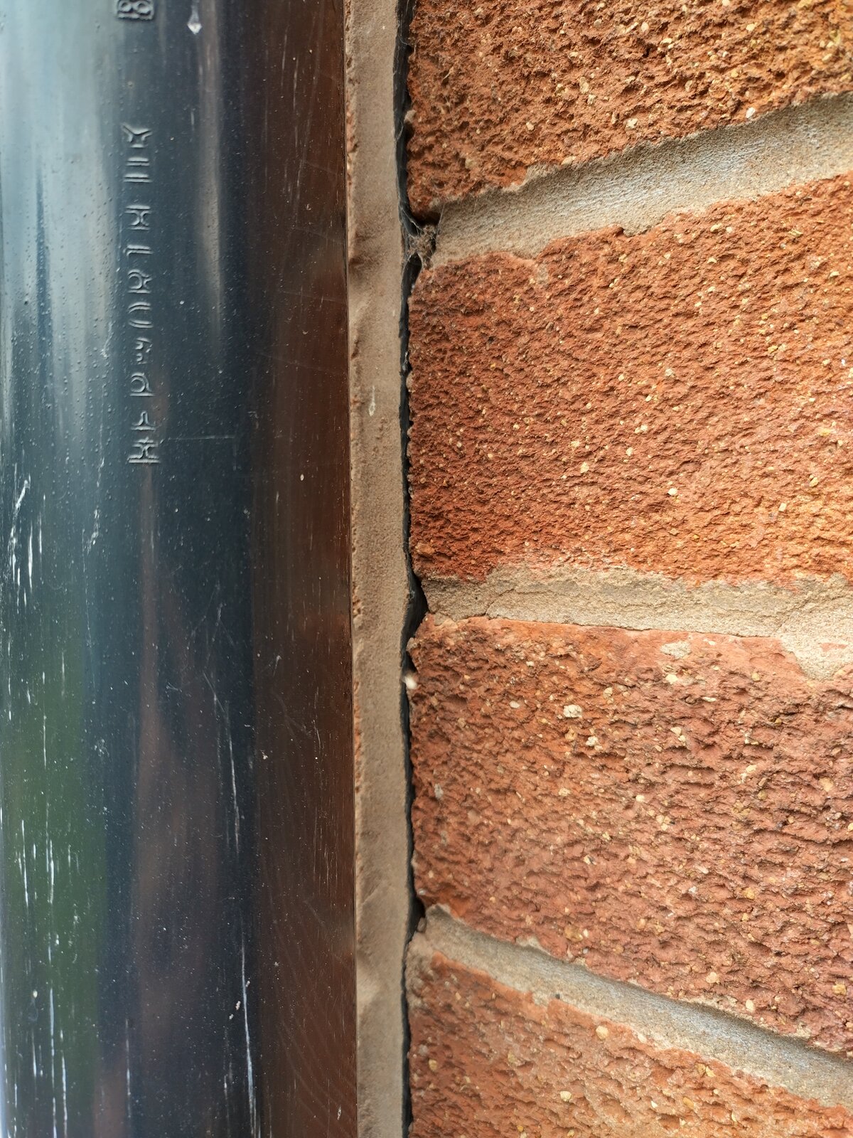

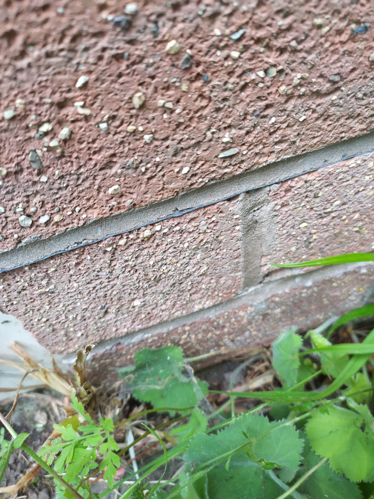

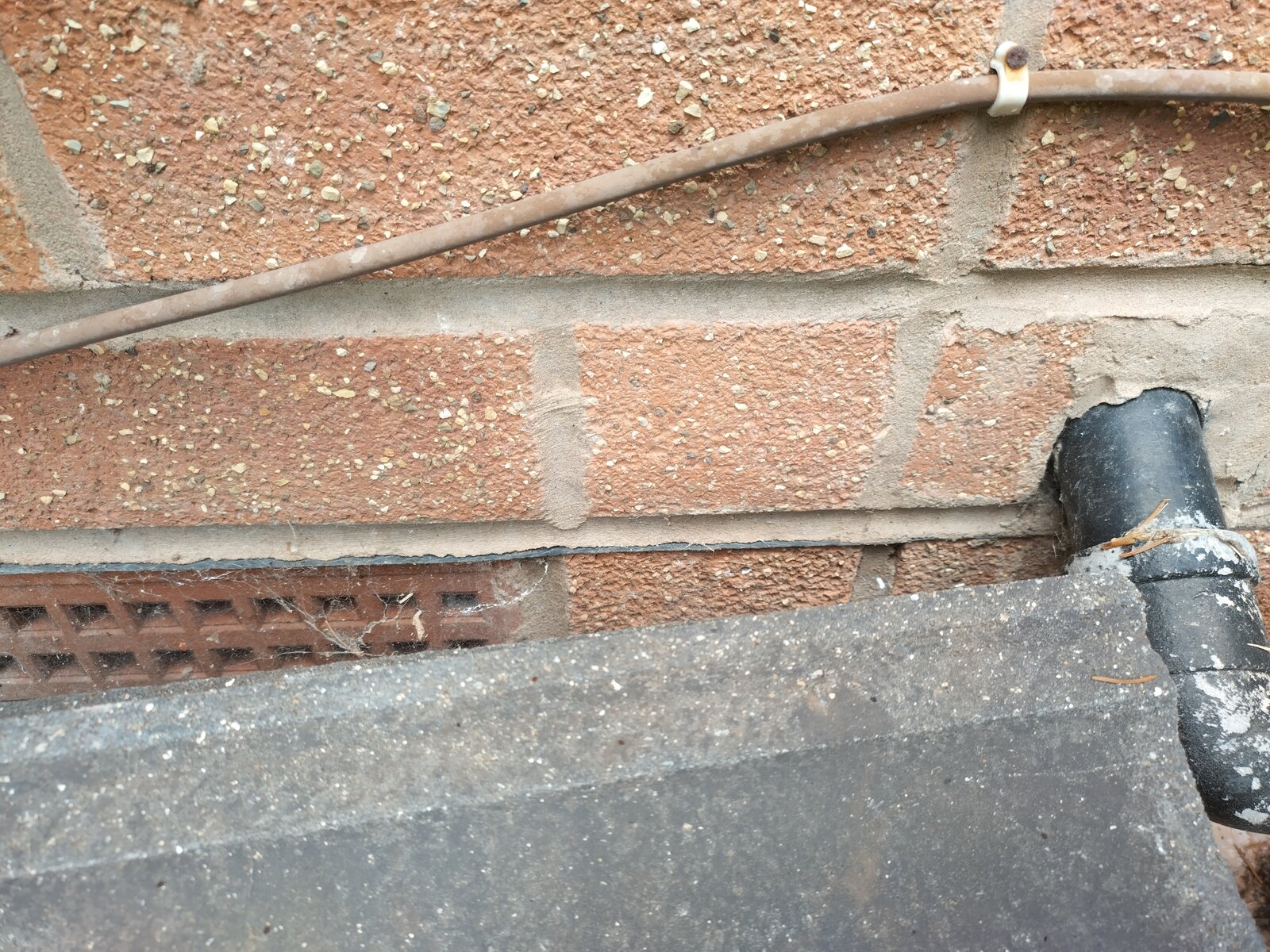

This is the 1994 extension just to the left of the drain.
Then there is a vertical membrane between the 1994 extension and the 1970 garage extension.
Then there's one on the 1970 garage extension.
I can't make out what the 1994 extension pic shows. Is that a mortar fillet to paving?
I see the the DPC above it. (Ed.)
Can't see any damp patches in the brickwork in those pics. The DPCs look OK
