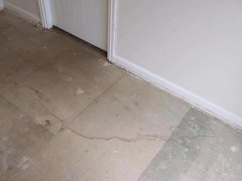

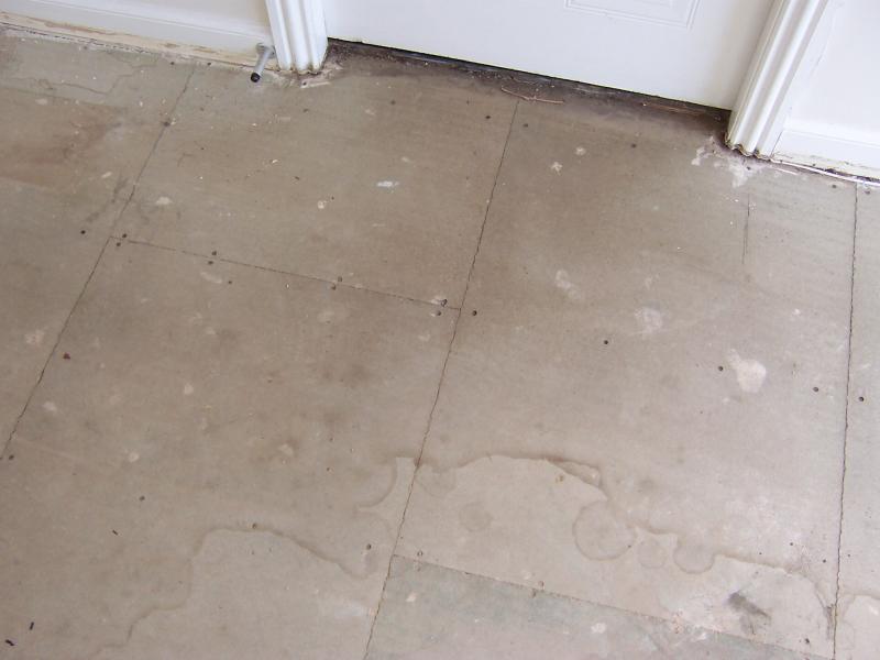

I uplifted laminate from dinning room, this is what I found.
When i sniff the 'stained' bits it smells that unpleasant smell when compared to the unstained parts.
I have had dehumidifier on for nearly 24 hours and a heater taking the room up to 30 degress centigrade.
Is the chipboard needing replaced?
If not then, What cycle should I use in terms of dehumidification and allowing fresh air in?
Do you know what has caused the staining? (Related to the other problem?)
try and get a board up and see what's going on underneath. I'd be replacing the stained boards as a minimum step, or replacing them with something better as the preferred option.

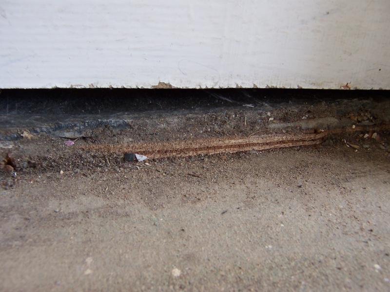

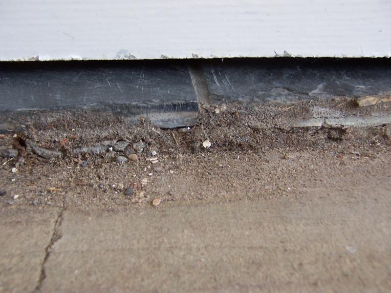

I believe it was flooding from washing machine. The door you see in above photos is the kitchen door which has tiled flooring. The photos below are close ups of the bottom of the kitchen floor.

chipboard is a rottern material.
it falls to bits if it gets damp
it can crack just from being stood on, e.g. at the bottom of stairs or in front of the sink.
rip it all up and replace with flooring ply. You local timber merchant will sell it. It is available with T&G edges.
