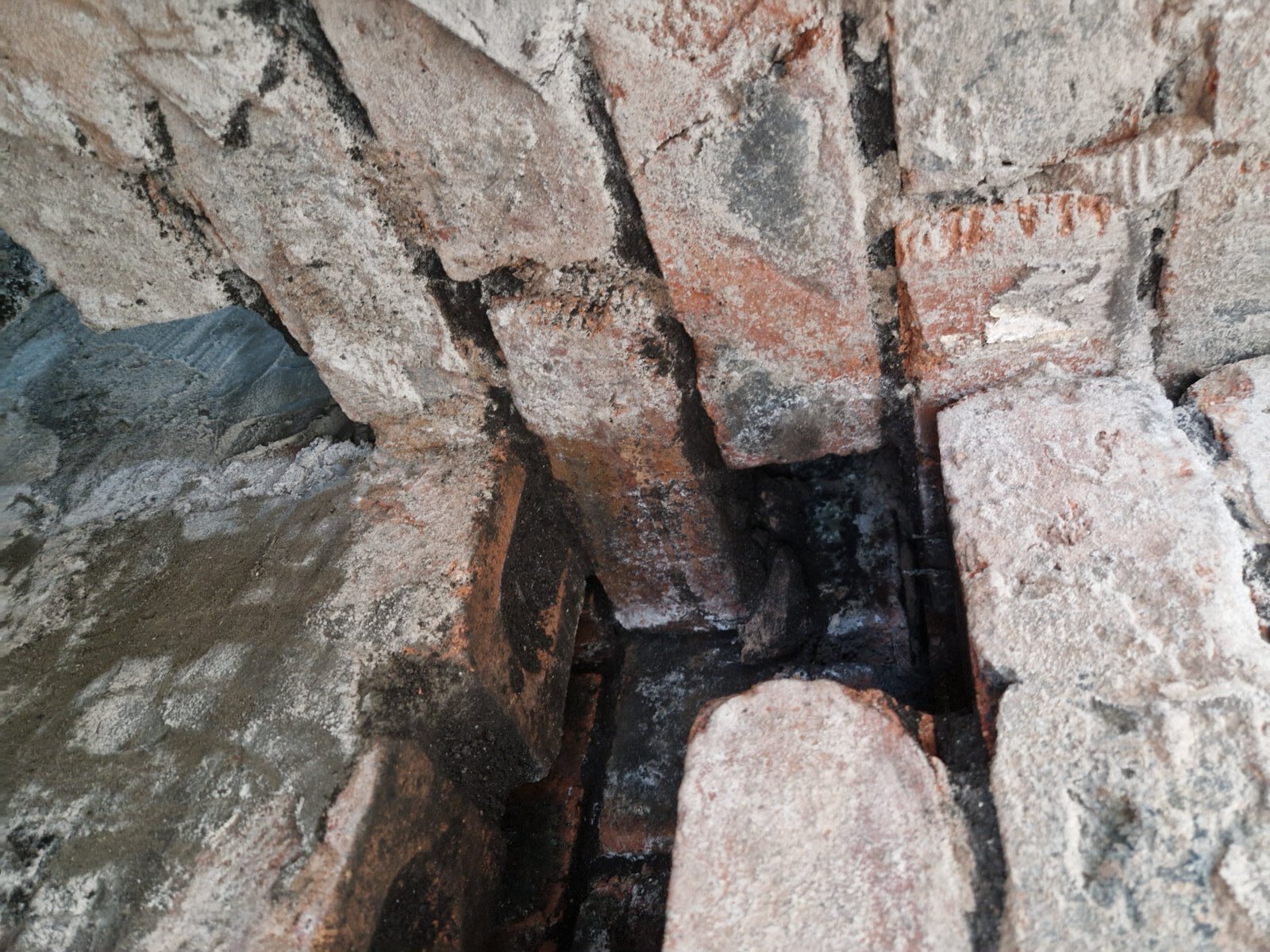

Hi guys so trying to fix a issue with rising damp on the internal skin and inter solid bricks walls my plan is to go along taking the bricks out bit by bit in stages and install a dpc like the images shows , just to get advice im i doing this correct and will method work ? i understand you can get chemical products but they can be hit and miss if they work

I’ve seen people try this method but it’s usually pretty hard to get right. Cutting out bricks one by one and slipping in a physical DPC can work, but it needs to be done very slowly and supported properly or you risk movement in the wall.
The bigger issue is that rising damp is often caused by bridging or high ground levels rather than the DPC itself failing. So before you go too far, it might be worth checking outside levels, debris in the cavity and any plaster bridging.
If you’re set on doing it, take tiny sections at a time and keep everything supported, but personally I’d get someone to have a look first just to make sure you’re fixing the right problem.

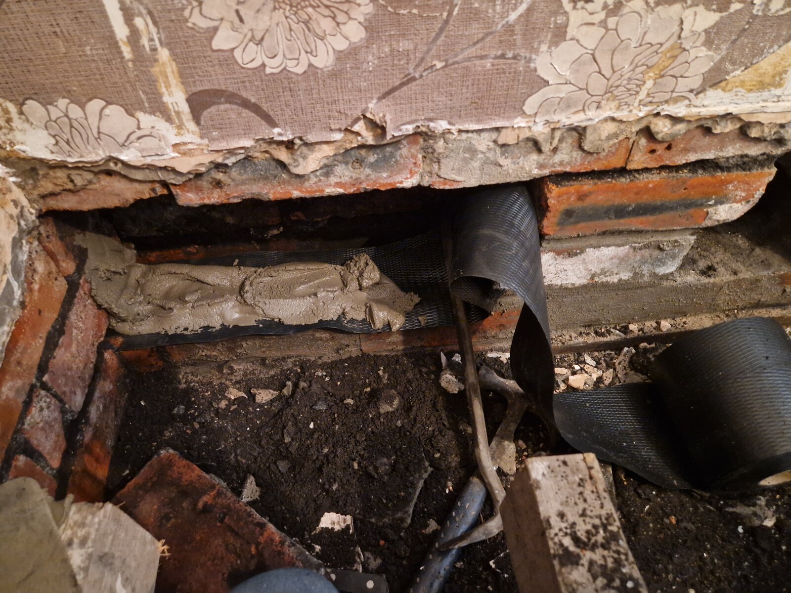

Thanks for the advice yeah the cavity was full of crap... the bricks in this house dont have sand and cement between them its like coal dust mix what they was trying meaning the bricks come out very easy you dont need to hammer so much to get them out as you would if they was sabd and cement.
Im about half way over the front of the house now , ive been doing sections of about 4/5 course a time and up to now ive not had any movement ive been making sure when putting the final brick back in that its well packed with a tuck pointer so the joint is back full
Also to note im only doing this on the internal skin not both skins at oncs
Yes this is a standard method of inserting a new DPC and is the most effective as long as the DPC is continuous - suitably lapped and there are no bridges from cavity debris or adjoining walls.
Yeah i have kept one lenght of dpc all the way there is no joins in it

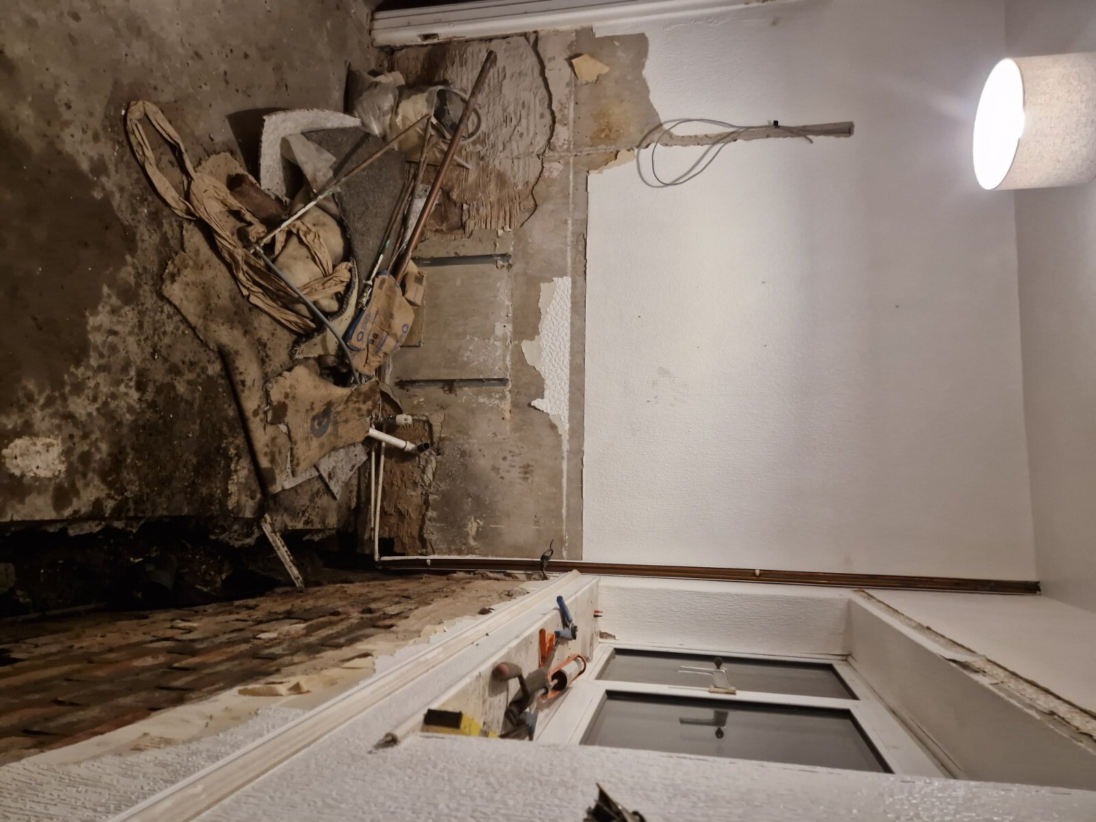

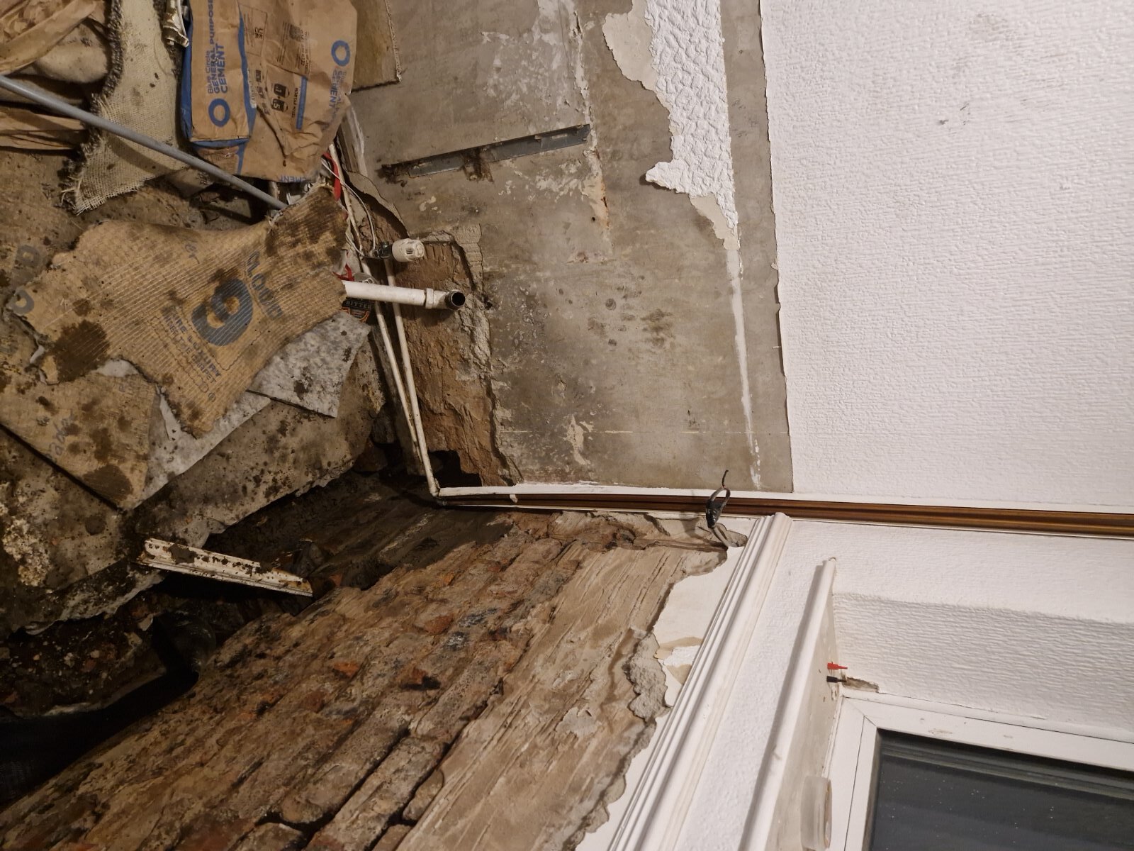

One issue i have is one of the internal brick walls goes right over the cavity and joins the external wall i dont know if it has been build like this for strengh or what ive the bottom section away but dont want to carry on detaching it all the way up if im doing wrong ?

Pictures not the best but you can see how the white paper wall would go over

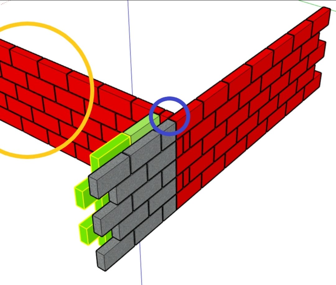

This is grabbed off another page but is basically how its built at the moment my feeling is penetrating damp can come across from the external wall as there is no dpc method been using on the vertical run

Following on from what ive said about looking at old plans i belive this is where the old front door used to be which has been bricked up so i could presume that the bridge of brick over the cavity would of been to close the cavity for the door opening so would there be any issue me taking all the end down a re tieing it into the inner cavity wall so its completely deatched from the outer skin
Probably not, unless there's a specific issue at this point.

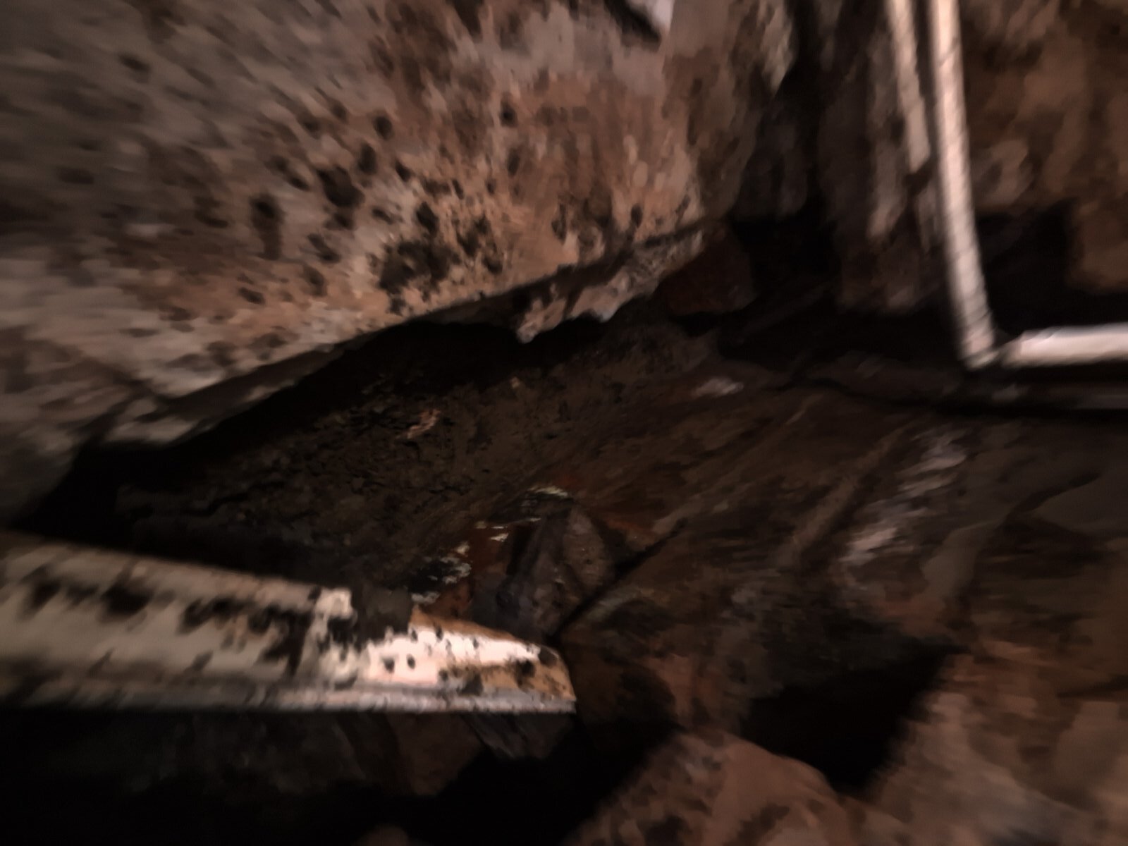

Here you can see where it goes over
ive done about 1 meter up is there any need me going all the way up ?

So all of this debris in the void - is that lots of fallen off snots. Or just sections where previous work has been carried out above somwhere like taking out some bricks to install extraction in a bathroom. Which would be a good reason the go to the expense of hiring a core drill maybe.
I have an older house and occasionally come across the same issue with debris inbetween the skins and remove it where I can.
God knows there has been no work done in this house for over 40 year dont know how all the rubbish has got in there.. maybe when the windows was changed all the years ago like i say these bricks are not on sand and cement its like a a mixed pit coal dust something they had a go using all the years ago
