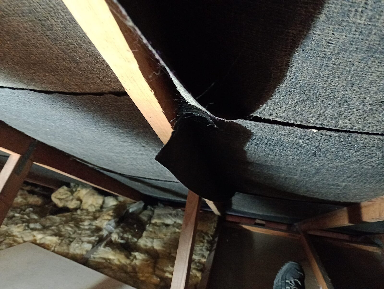

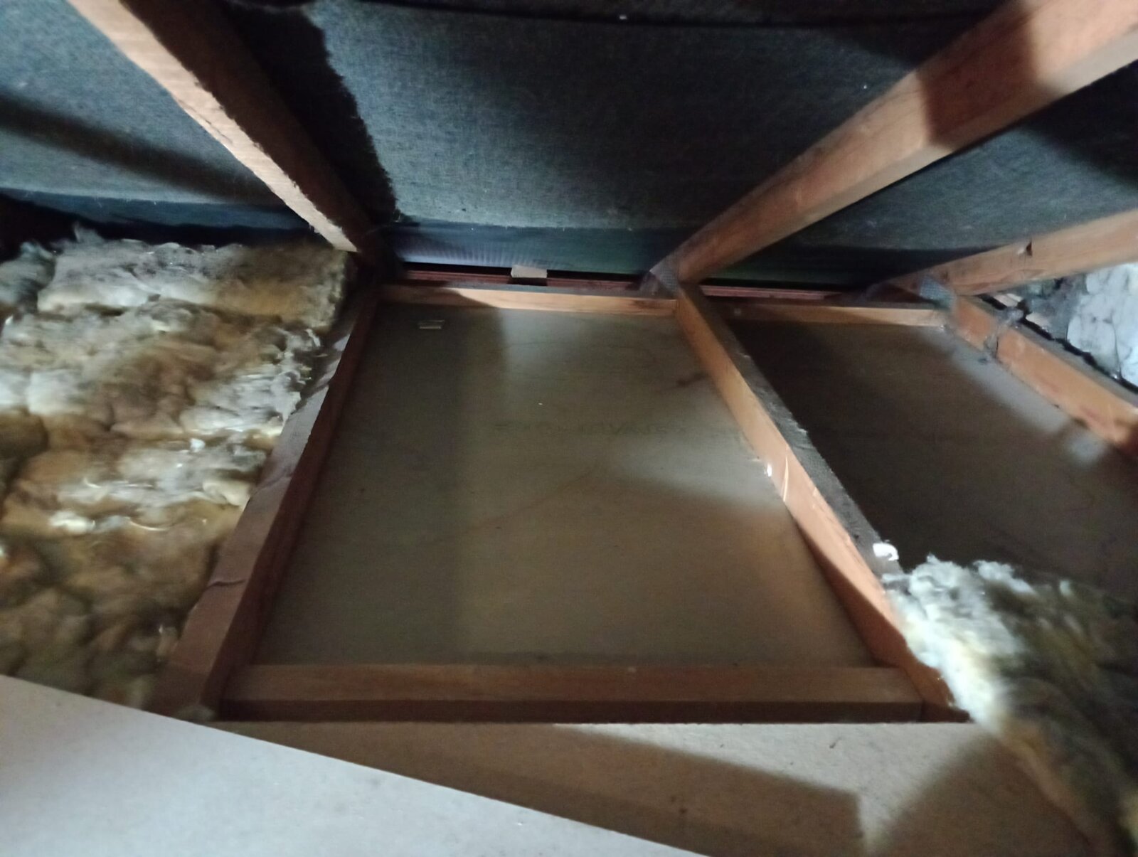

The kitchen ventilation is poor and loft has been poorly insulated.insulationpushedup to eaves, chipboard planks laid directly on insulation compressing them and foil insulation blankets upside down.

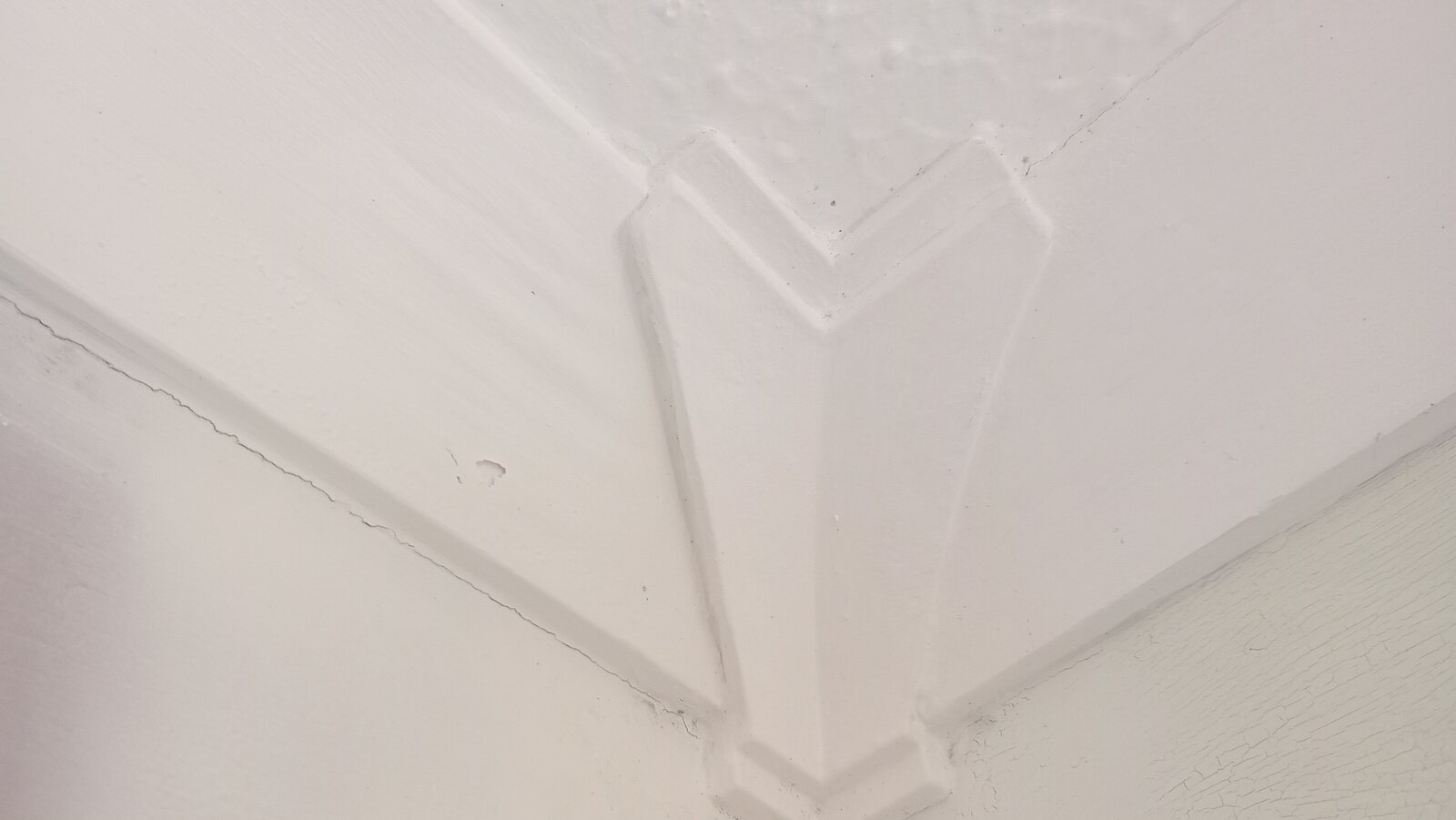

I've started relaying he insulation checked loft for for any leaks can't find anything at present.There us evidence if previous water leaks in the back of he plasterboard in the loft and some felt that's not been secured back properly.See pic 3 and 4.Ive left out newspaper now to see if any water marks appear on it when it rains next.Ive also been running a dehumidifier to bring down any humidity and dry the wall out.

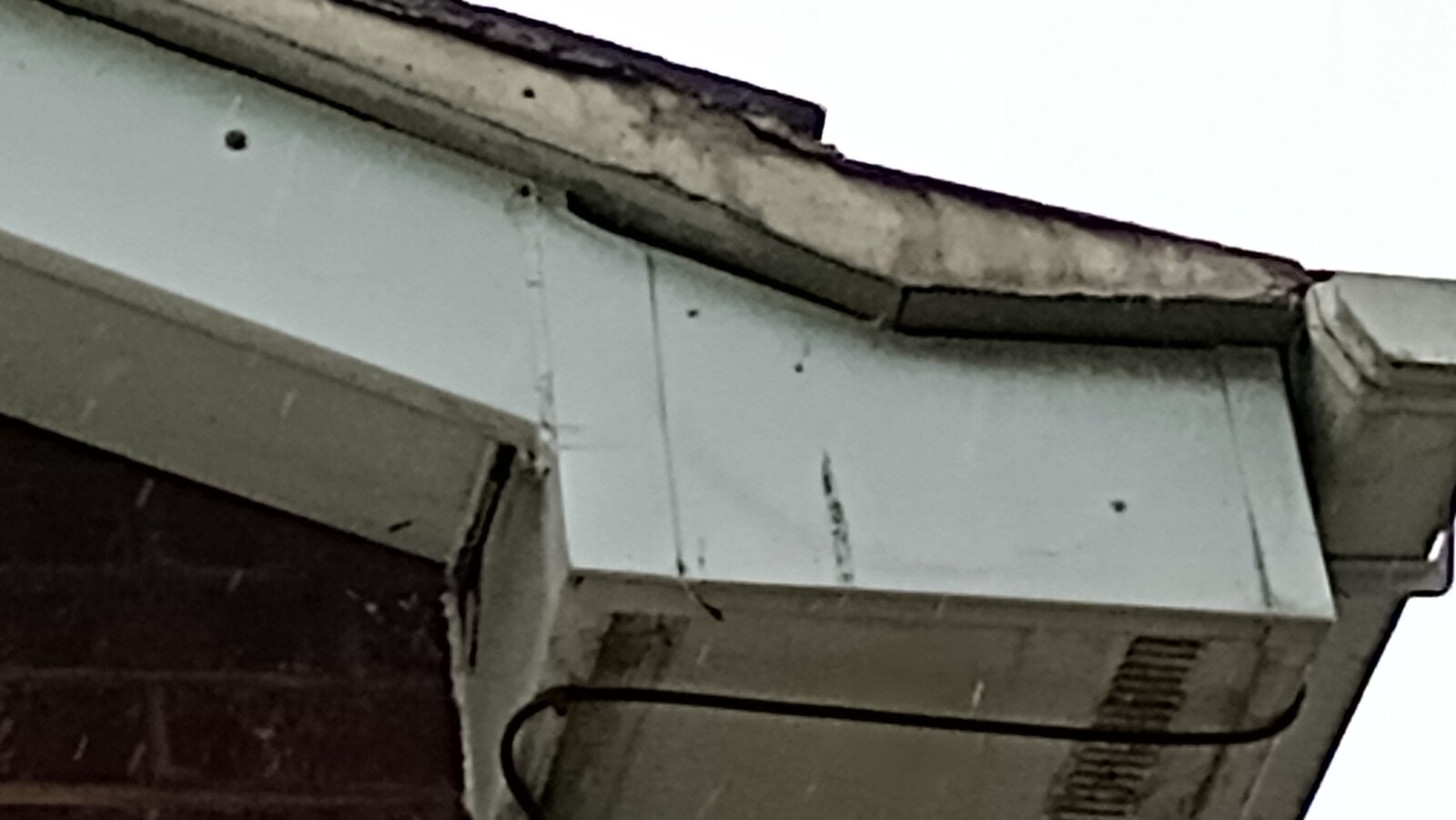

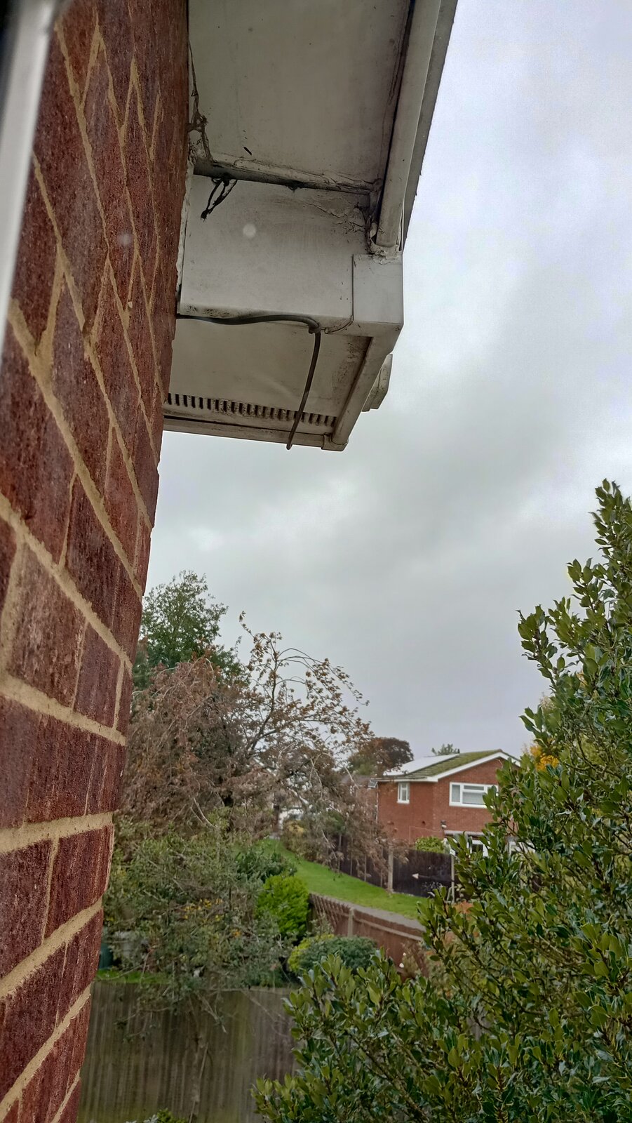

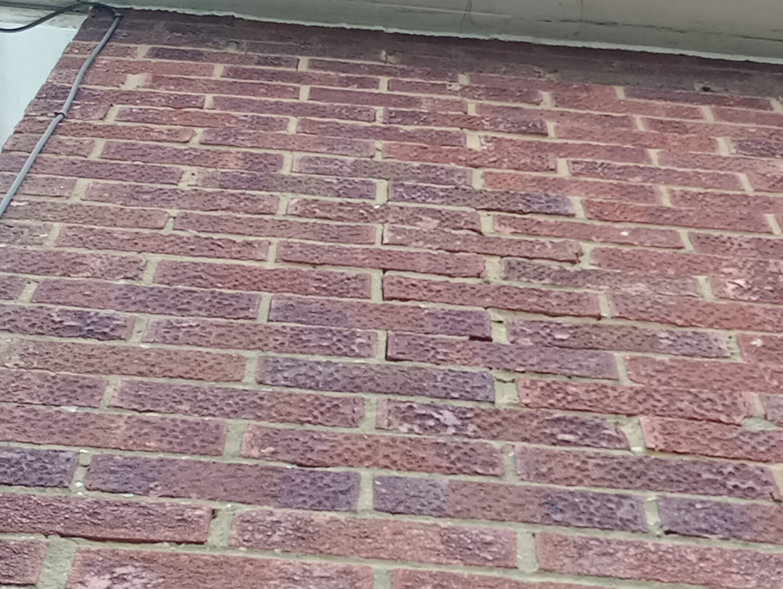

One thing I have noticed is that the brickwork in that wall the pointing needs repairing can see some small holes and that wall gets pretty wet when it rains.The wall also has cavity insulation.The mortar that is defective is lower down than where the damp patch occurs.I suppose it could rise or cause internal wall to get cold and any humid air to condense on the wall.See second pic of exterior wall with pointing required.This wall is the same wall the damp appear interior.The damp patch is at the top left if the pic on the internal wall,its also where tha aerial runs down the wall.

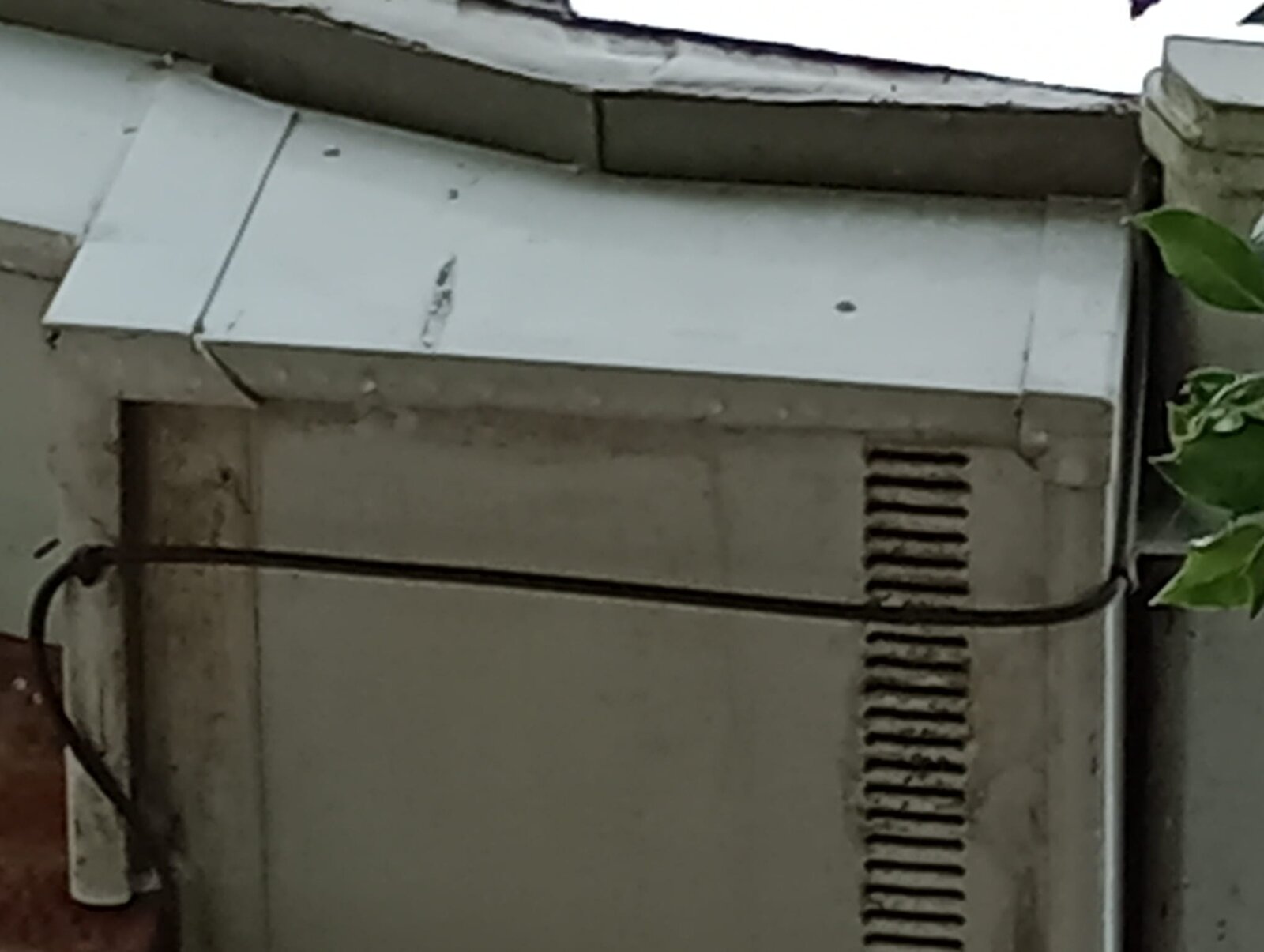

Another thing it could be is that theres an aerial cable coming out if loft and going into the wall,possible rainwater running down it.See first pic
Another option is that there is a gap between the fascia and the concrete verge, where it's been repaired.The rest if the roof this gap is filled.Rofwr didn't think that was a problem though.

It's a cavity wall, so the causes of internal damp are very limited.

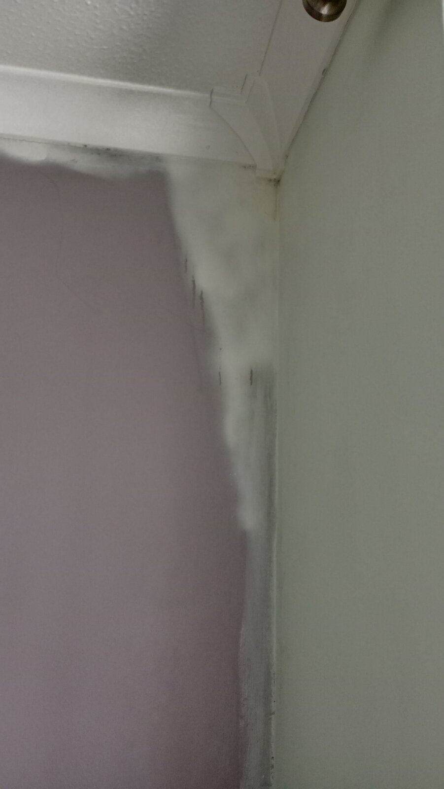

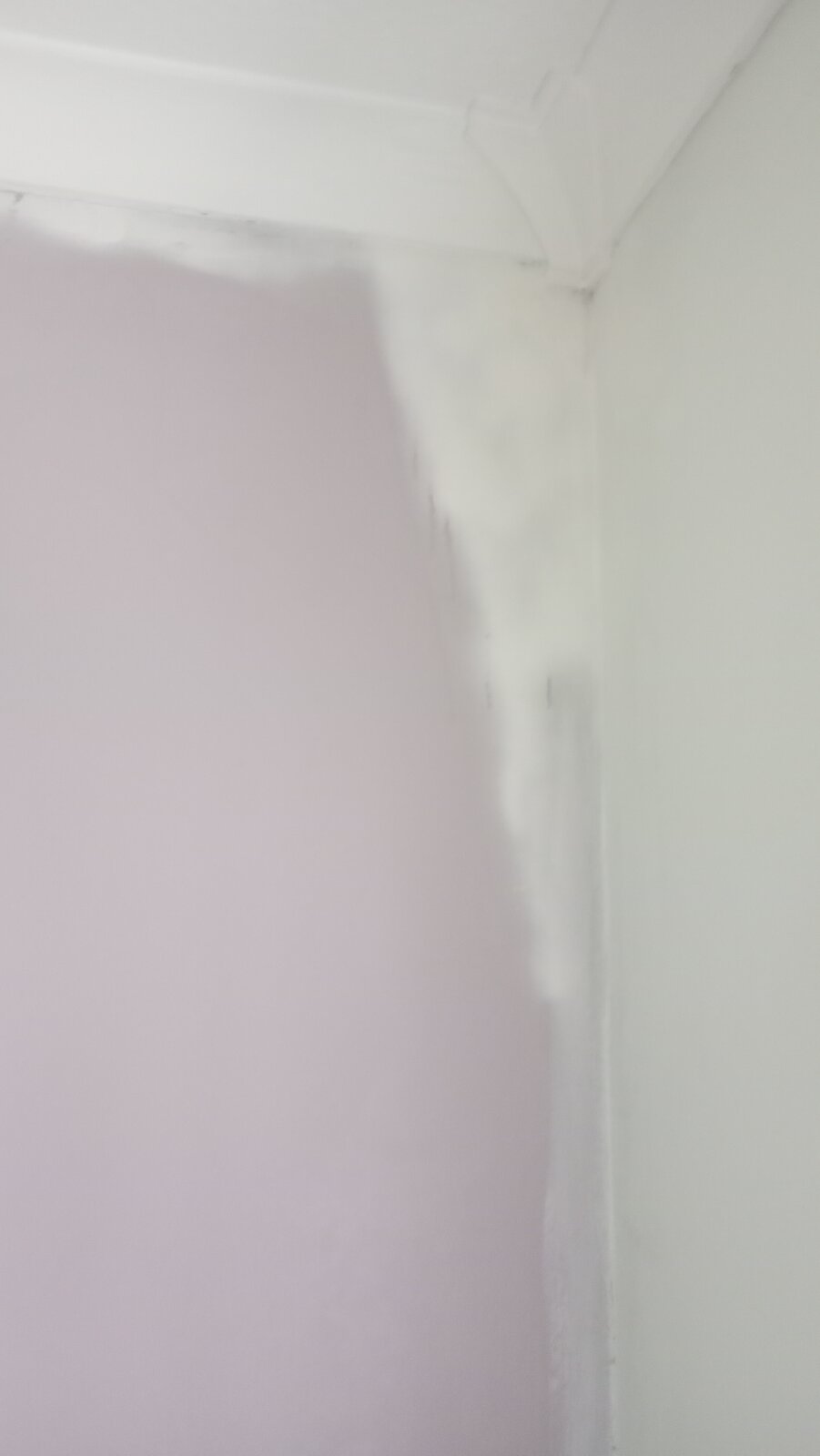

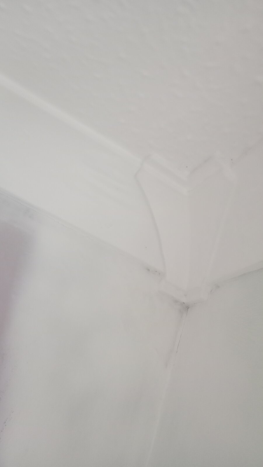

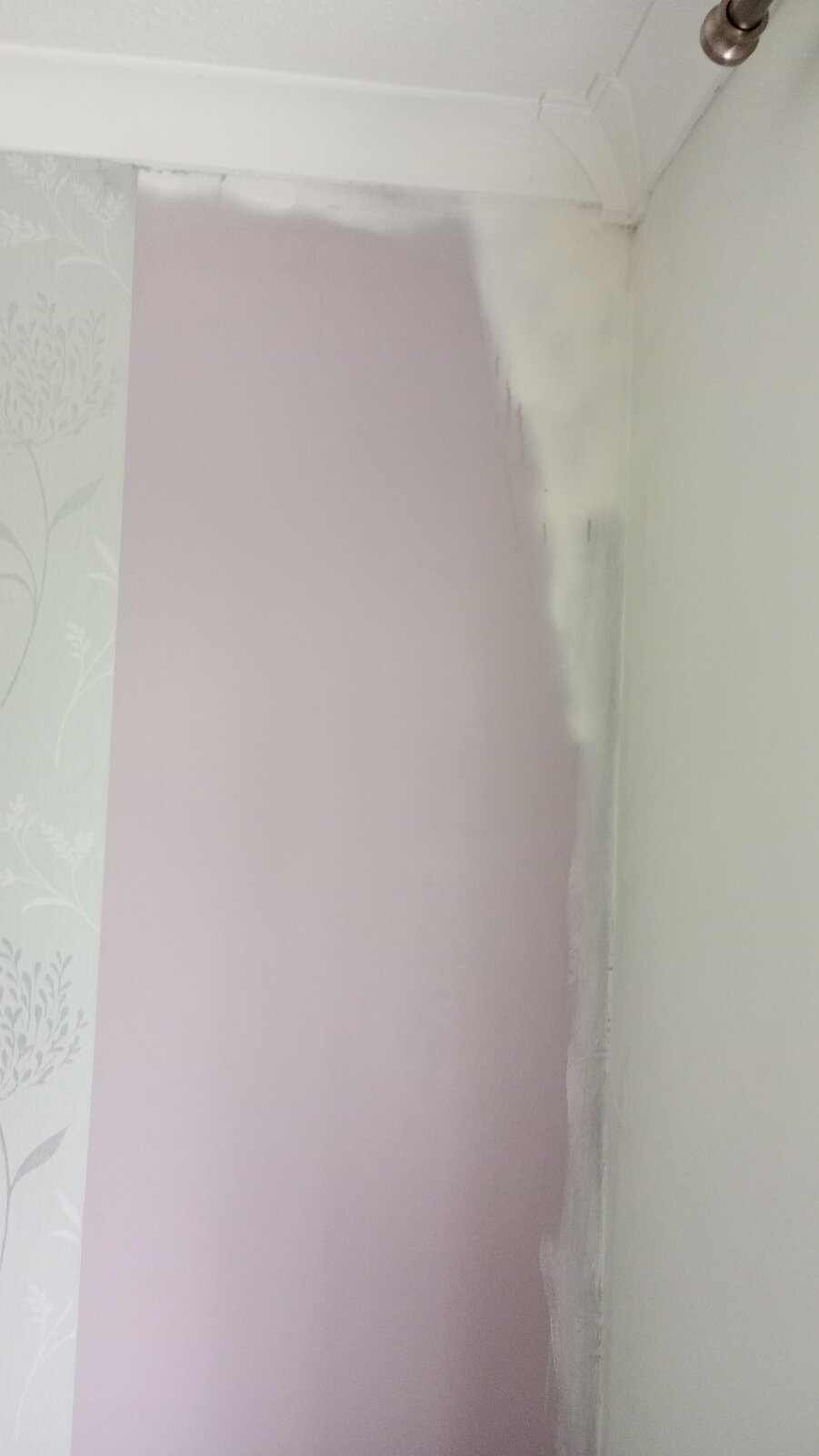

There's no damp staining on the internal wall.We only noticed when measuring the wall for a bed.Its damp to feel, damper after rain and you can see some wrinkles appearing in the coving.We can also see some instances of previous water leaks in ceiling below probably the reason for the previous fixes.See attached pics of wall.looks lie they've tried painting over wall to try to seal it.
Considering that virtually everyone has access to a decent camera these days, those are the worst photos I've ever seen.
I've tried numerous times to get good pics but it's just not coming through.that wall paint is smudgy on the wall here are a few more which might help

Just noticed this isn't properly attached with a gap at the top.tjis if from the bedroom side opposite to the brick wall face another pic.Also attached another pic showing the gap left between soffit and verge cement thats filled on areas before the repair works were done.Roofer saud though this gap in kast pic shouldnt be a problem

If there is no staining or no mould, that indicates there is no dampness.
Whatever issues you are looking at to the roof verge and soffit boxing are not the sort of issue that can allow water to get to the inside leaf of a cavity wall - and certainly not without associated staining.
