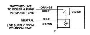

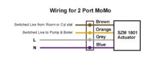

The motorised valve needs a permanent line to close it so yes some rewiring required, it's not like for like with the wiring
Some MOMO's have a separate 'open' and 'close' wire, but the wiring for the spring return and MOMO below is the same.
Spot the difference ;)
Honeywell spring return 2-port motorised valve. [Drayton & Danfoss valves are the same]
Sunvic MOMO

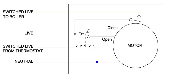

It's not difficult to work out how a MOMO can be manufactured to use the same wires as a spring return valve. The addition of a relay inside, operated by the switched live from the thermostat would provide a 'motor on' and 'motor off' output.

However the the OP wanted to replace the spring shut valve and said that he was happy for like-for-like replacements which these valves are, but at least two posters made reference to rewiring.
So I was simply trying to explain that for the aforesaid MOMO valve wiring is the same as a spring return valve. Four wires of the same colour that go to the same terminals.

Genuine water hammer can cause leaks. Also most valves have a permanent live anyway (grey wire usually).
Yet again !!!!! check the direction of the valve , if fitted the wrong way round it will clunk when closing
yet other posts say that extra wiring (a permanent live?) will be required
Spring return valves have a permanent live connected (grey wire) so not sure how they work that as being an 'extra' :rolleyes:. But as you don't want a MOMO, then I'm done on the subject and hope you manage to find the damper type device you're looking for.
