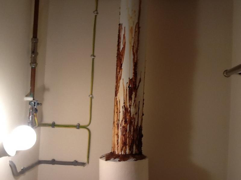

Hi all,
New to this site. I have a danesmoor 15 19 and there is what appears to be a leak of some water based fluid. It's crumbles to the touch and I suspect it's is coming out of the chimney and flowing down the outside of the pipe. I have a cowl on the chimney so I can't confirm this yet. Has anyone seen this before.
Trying to narrow it down. It coincides with a new full of oil. Is it possible that oil burning at a higher temperature or with impurities could cause this?

It flows down the outside of the pipe then solidifies. The solidified streams are hard and crumble to the touch. Ill post a photo
Just a couple of questions.....is there any smoke to be seen at the top of the chimney? Has there been any boiler problems recently?
What is the flue pipe made of? It seems to be porous from the inside therefore can we assume its asbestos?
Is the terminal on the top of the flue pipe in good condition i.e can it stop rain pouring down the chimney?
John :)
This is just a guess BUT... Probably an unlined flue or the the liner has corroded causing condensation / Rain to run down outside of pipe.
What I said in previous post. PLUS..............
Your flue is Fooooooked!!
It looks a very large collar for a 15/19..
I would also check inside boiler for leaks.
I'm NOT suprised you have problems, that flue is a MESS
the female sockets on an oil fired boiler are supposed to face upward (unlike gas which should be the otherway round) this is to allow condensation within the flue to run back to the boiler.
However your flue was bodged up when the Danesmoor was fitted and the older oil fired boiler waws removed (I've seen flue pipes reduced in diameter many many times and 99% have problems!! :unsure:
Whichever orientation you choose .I stand by my initial diagnosis.
It's FOOOOOOOOKED!!
The second pic is the right way round. It just started to do this in the last month or so. Previous three years it all worked fine. One event was the fitting of a cowl in August and it hasn't been used much since. Second was new oil which seemed to burn hotter ( maybe my imagination). Many thanks for all the replies. My sense is that it's soot or material from inside the pipe condensing on the cowl and flowing down the outside of the pipe. Water evaporates leaving this crumbly material in streaks. Anyone seen this before?
