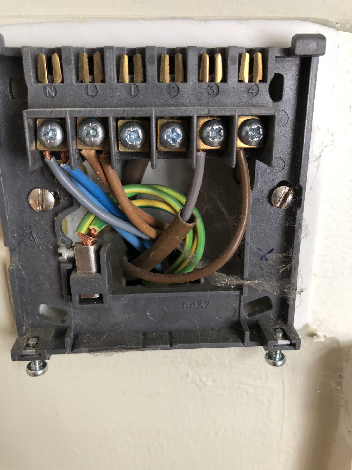

Hi,
Please help as I can’t see a diagram that matched my setup in other posts.
I want to swap a danfos controller and a replacement thermostat to a Nest system.
I have a oil combi boiler.
My Danfos FP/CP715-Si is wired as below.
3x N
2x L
1x DHW ON
1x HTG ON

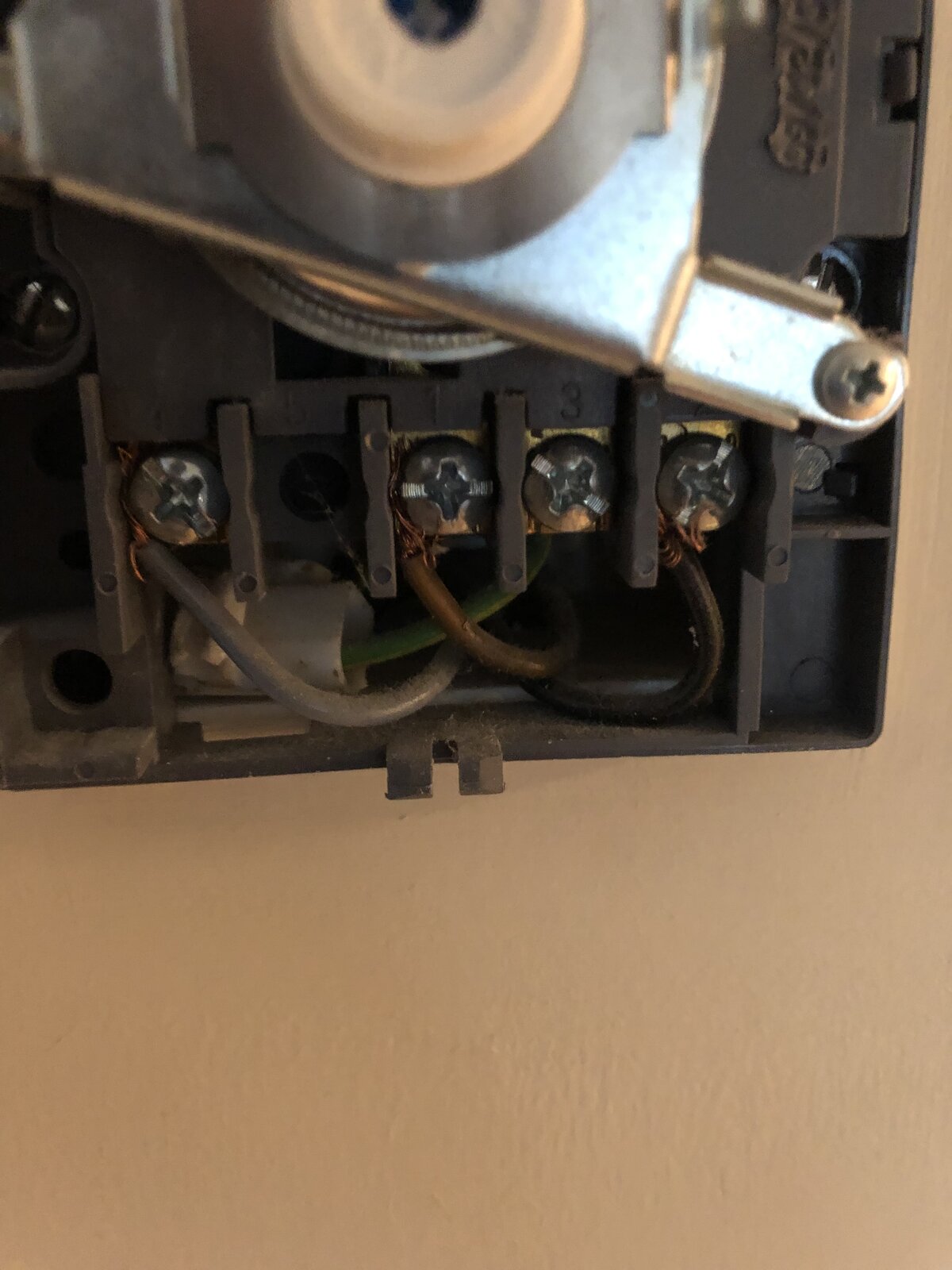

The room thermostat is a follows
I don’t see which wires would connect to t1& t2 ? And what is wire on 4 on the room thermostat?
Any help would be amazing
Are you sure it’s a combi? Anyway I would have said 1 and 3 to T1 and T2, but it appears yours is wired slightly differently.
you have an S plan system , follow the instructions for that an link out the existing room thermostat
Now you mention it it may not be.
I have an external Grant oil (kerosine) boiler that supplies hot water and heating.
  • Thanks
Reactions: CBW
are you sure as I don’t have a water tank just an external oil Grant boiler supplying hot water and heating.
well I know you think we have crystal balls, just post what controls and wiring you have
