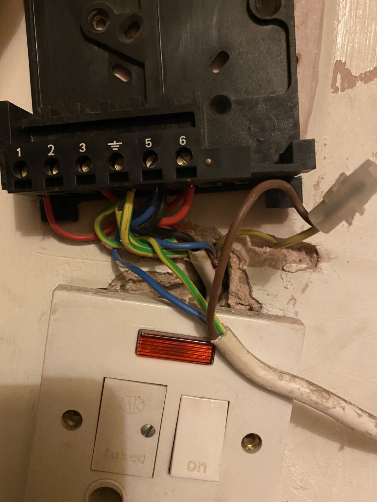

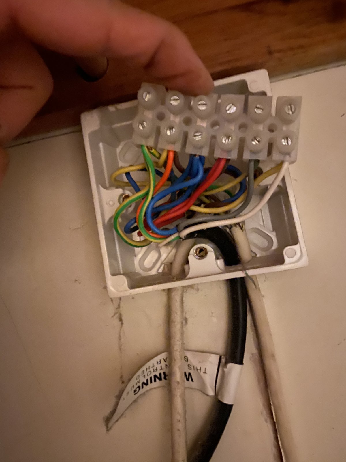

Hi all!
I know this topic has been covered before, but I can’t seem to see anything with my specific wiring setup so am looking for advice.
I have an ideal boiler that has a Danfoss 103 timer and a Honeywell room thermostat.
There’s a yellow cable connecting to the live of the boiler via a terminal block, other than that, there’s very few wires at the Danfoss controller itself. I’ll post pictures to see if that makes more sense.
looking for advice on how I can wire the hive in without disconnecting all of the existing wiring to trace it all, and start again. Any help much appreciated!

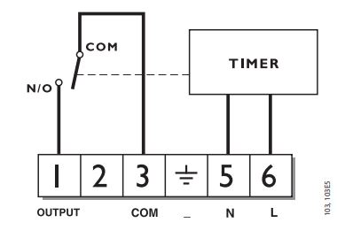

The Danfoss 103 is a single channel timeswitch, so the heating and hot water share the same on/off times and wiring connections. The terminals are:

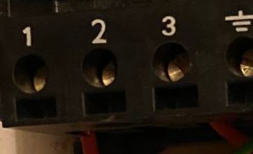

From the above, can see that the switching wires are in terminals 1 & 3.
The Hive Dual Channel Receiver (which is the version you need for a Y-Plan) needs separate wires connecting for the heating and hot water. However, your 103 isn't wired like this. As you can see, in your case, there is only on set of wires connected to terminals 1 & 3
Therefore the heating and hot water wiring are not separate at the moment, which means unfortunately that you cannot replace the 103 with the Hive, without rewiring.

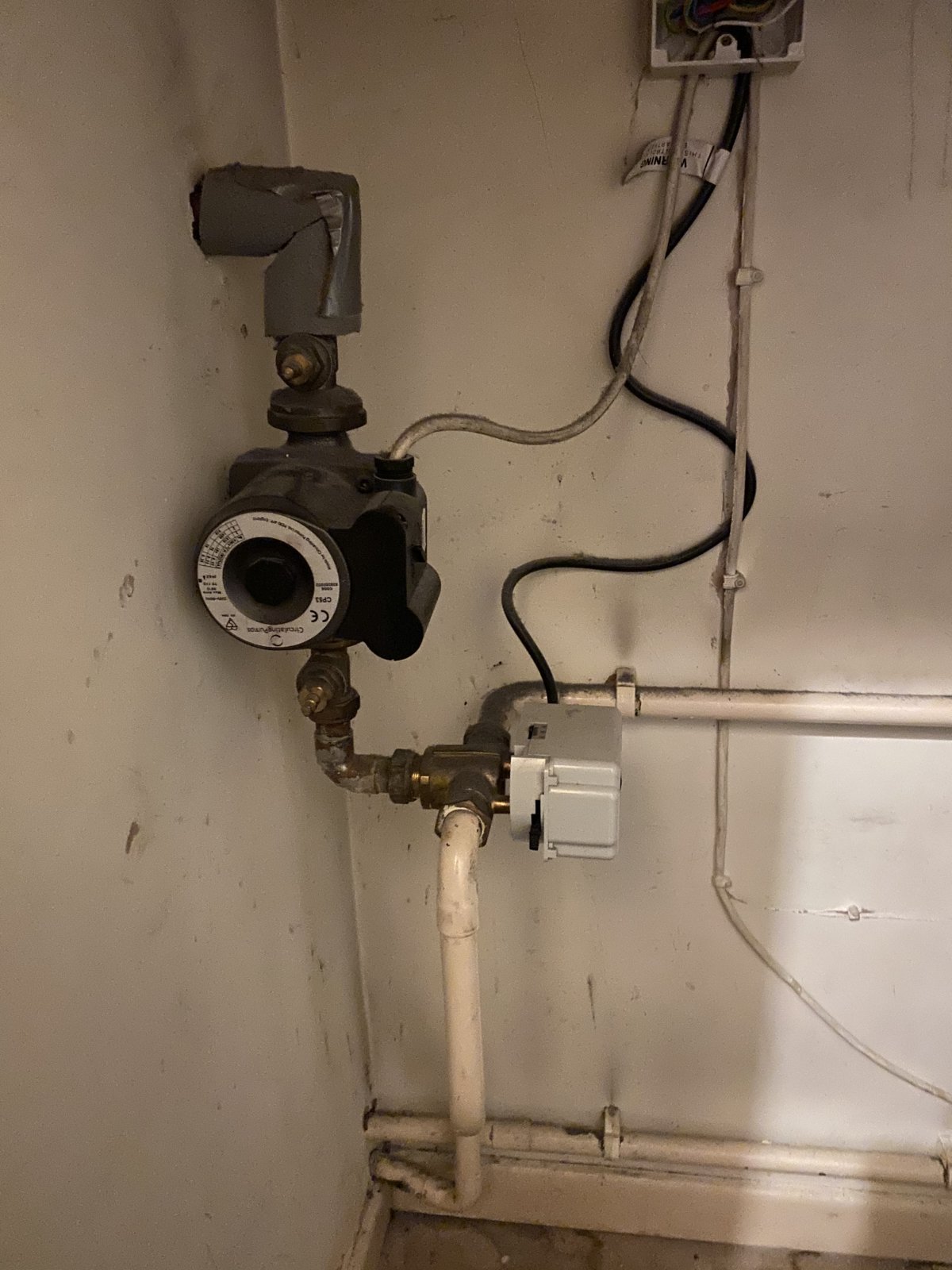

yours is a complete bodge of wiring, you have a time switch and not a programmer, if you want to use the hive dual channel you will need to rewire
Thanks for your replies gents. I’m assuming that if a pump overrun or permanent live to the boiler existed, they’d be pretty obvious for me to see? Happy to rewire, was just hoping I didn’t have to!
Yes it all relates to the boiler wiring terminals. If you tell us the make / model of your boiler then someone will probably be able to tell you.
not a big deal to rewire, get yourself some 5 core 0.75mm flex and the job is easy, you dont currently have a cyl thermostat, would be an idea if not too big a job to fit one when you are fitting the Hive

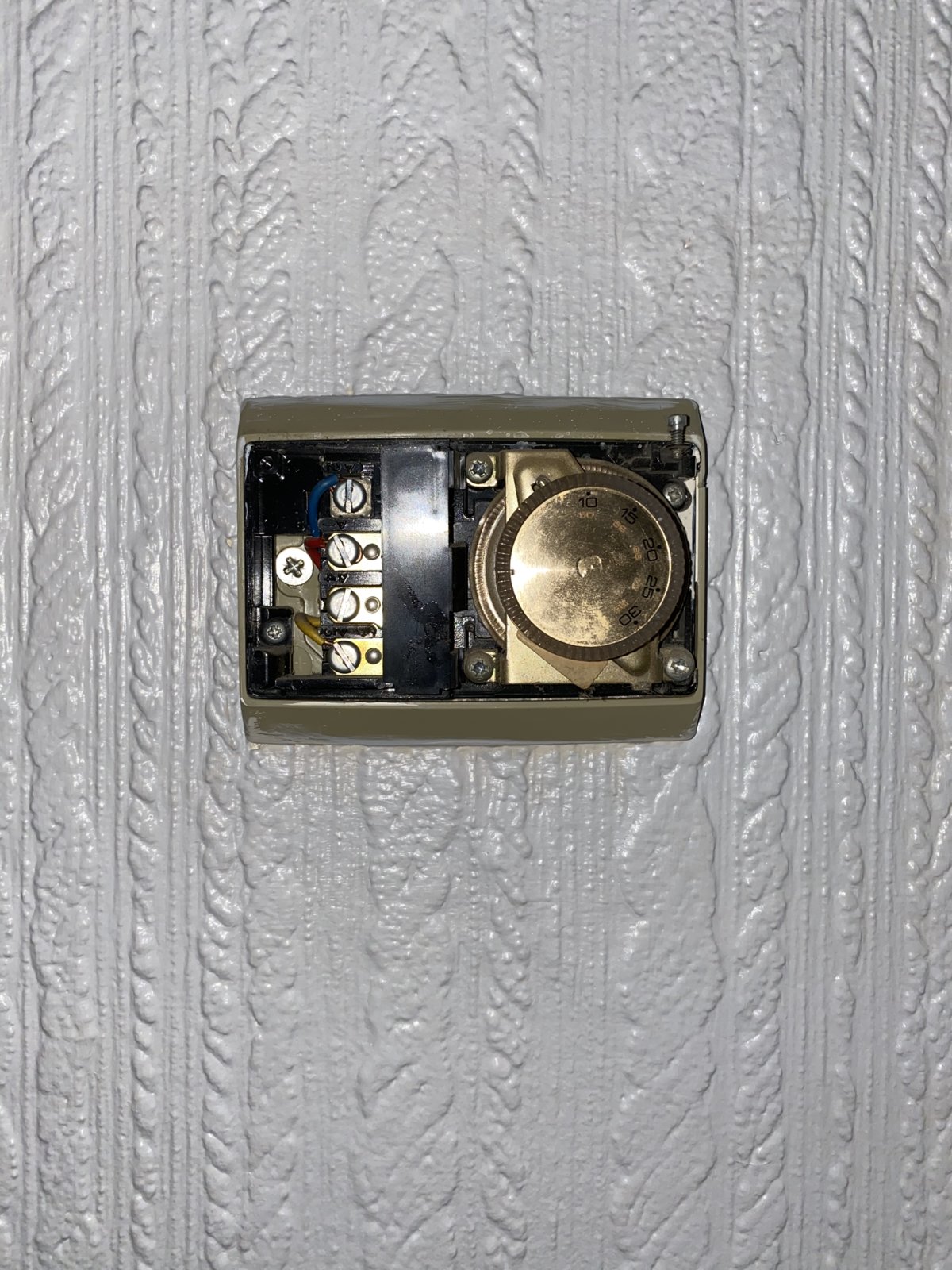

Thanks for this. You’ve all been a massive help and have certainly outdone my expectations! There is a cylinder thermostat there, I forgot the send pictures of it. It’s the white wire in the last photo running down and to the right.
I see the white wire but cant see which cable it is connected to you will need three cores for your Cyl stat, Com , NO and NC if it has 3 cores the wiring with a piece of 5 core will be easy, you can buy the cable by the Meter you dont need much
