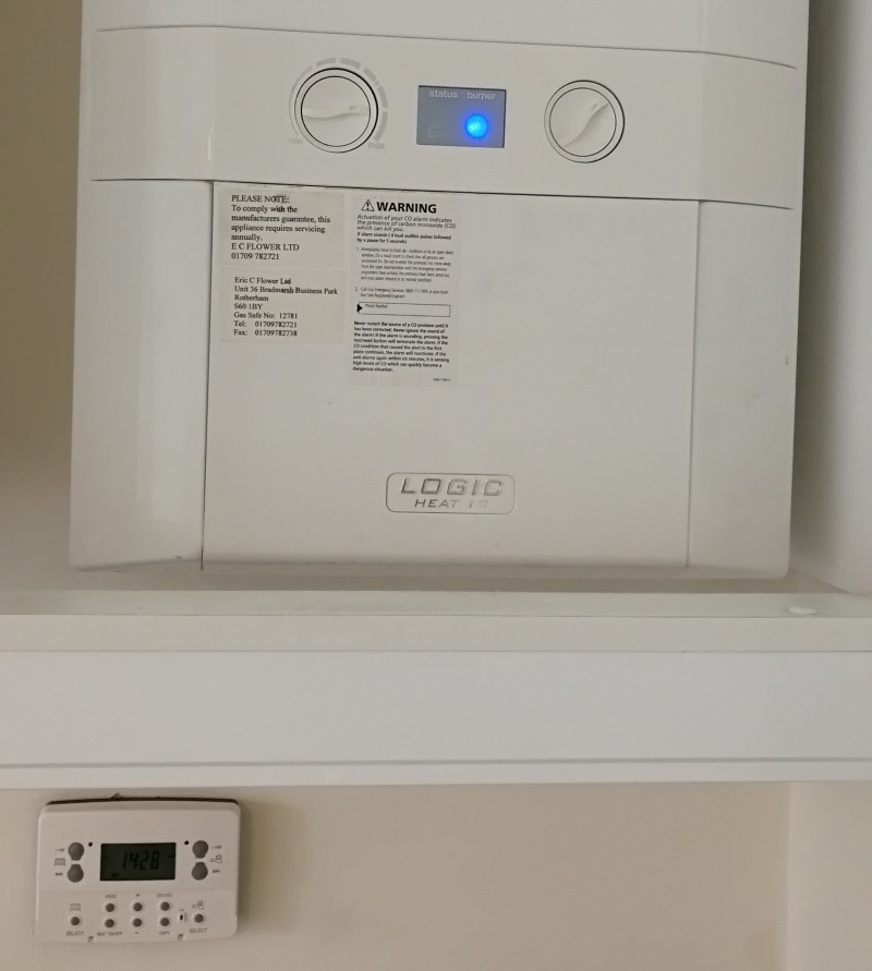

On the Danfoss programmer I would usually hit the +1HR button for CH to do my test - I did, I didn't pay much attention, but I heard the IDEAL boiler fire up, 20 minutes later, stone cold radiators.

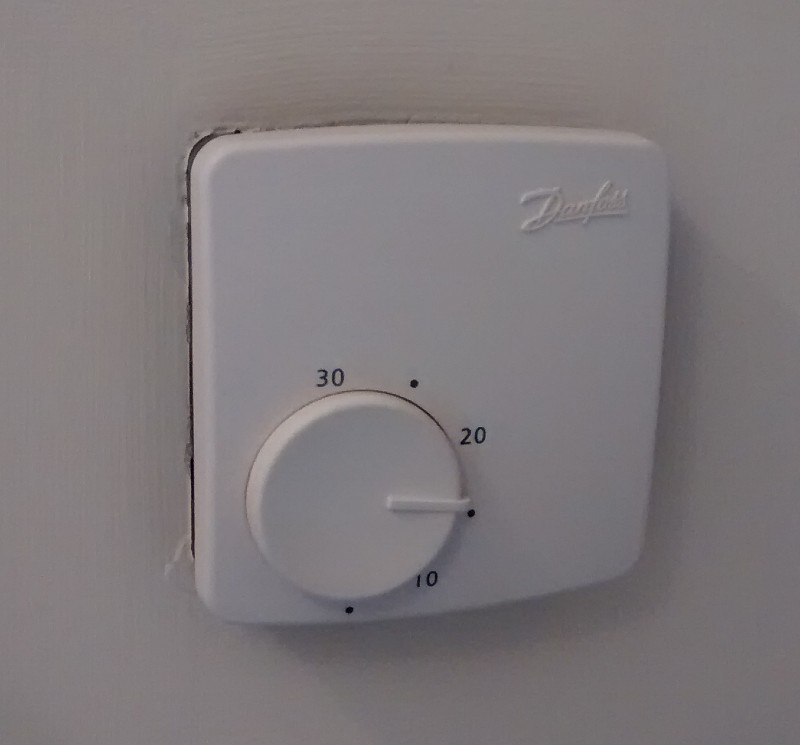

Slightly bemused I checked the Danfoss thermostat in the hallway just in case - and it was down at its lowest... I was pondering whether that would have an effect, or not, wasn't I overriding the thermostat with the +1HR? So I just ramped it up to maximum anyway, and carried on...

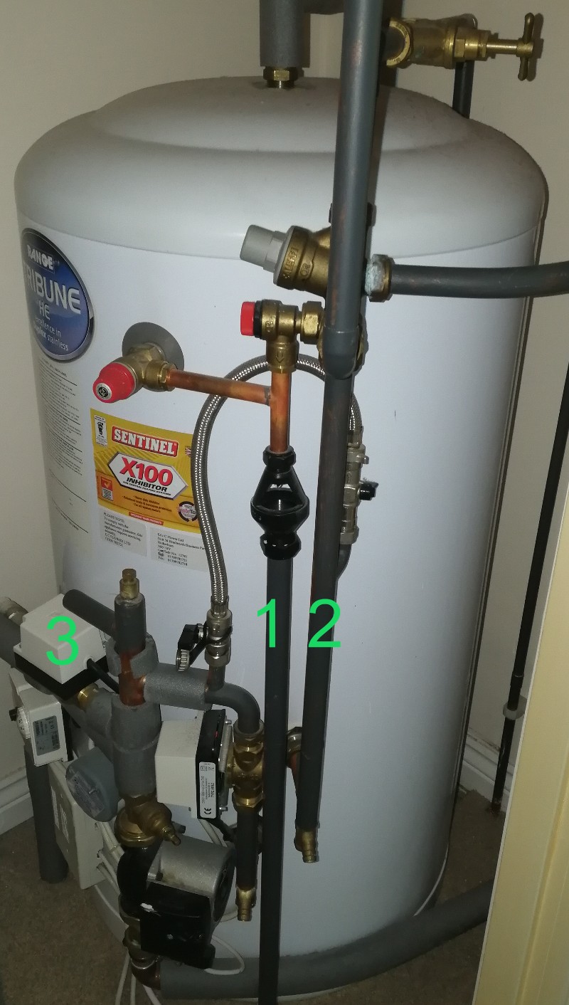

20 minutes later, stone cold radiators... I checked the boiler - sure enough, the big blue burner light was on and it was rumbling away. Stone cold radiators. I went to the cylinder room and there was plenty of rumbling in there. And some of the pipes were also hot... so it definitely seems as if the boiler is burning gas and creating heat. I checked the TRVs on each radiator - some were down, but certainly not all... I ramped them up anyway.

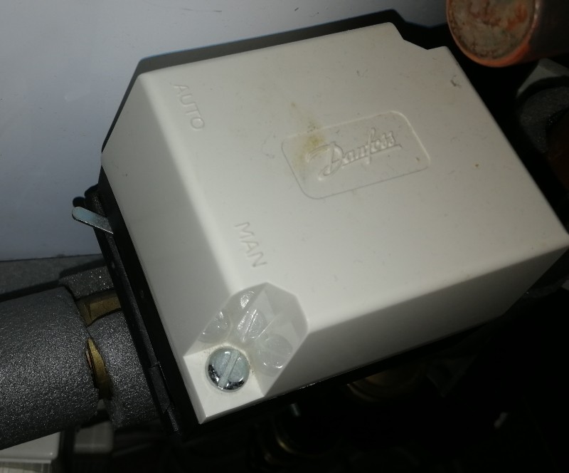

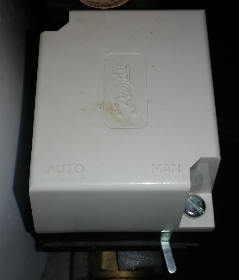

I started to wonder if some valve wasn't switching or something... in the cylinder cupboard there are 2 valves I can see, looking like this:
And they're both on AUTO - the 'choices' being AUTO or MAN - not something like OPEN and CLOSED. I didn't see either move - should I?
Anyway, the only strange thing I've noticed is that the hallway thermostat does not "click" as you turn it - I always knew you would hear a click as you moved the dial - as it switched on and off - whatever range you spin the dial - no click. That doesn't seem right to me, but I'm not even sure if the programmer overrides it anyway... so if I've set +1HR there and I move the dial up and down, maybe it won't click because the programmer is saying ON no matter what?

Should I see one of the valves in the cylinder cupboard change position or stay at AUTO? If I don't, is there something wrong with one?

Wow that’s a lot of info. Ok a couple of things: post photo of hallway thermostat, check the heating valve in the cylinder cupboard, are the pipes hot to and from it? You probably won’t see anything on valve move, but you should hear the motor opening. The boiler, is this firing for heating or hot water?

Here's the hallway thermostat...
Good to know I'll not see anything move on the valve... I do at home, if I press the programmer's 1 hour boost equivalent button at home I can see the lever slide across in front of my eyes. I will check the pipes and report back.

This hallway thermostat measures temperature, right? That's what it does.
And, as you turn the dial, if you ask for a temperature higher than it is measuring, you will hear a "click" (inside it, like an immersion heater) as it switches and as it calls for heat, right?
Even if there's no boiler at the other end (theoretically) should you still hear that "click" happen as you dial it up from minimum to maximum?
You are correct in that a thermostat measures temperature although the dial ones are not the most accurate of things
However the click all depends on the thermostat some are quite noisy when they click some are very quiet
Don't turn on the hw just the heating and if the boiler fires when you call for heating then you know the thermostat is working , you can also turn it down whilst the boiler is firing to see if the boiler shuts down , it's a little crude but it's a good indication

From everything OFF and hallway thermostat down at 0, radiators stone cold, I turned the boiler on, waited a little bit, then turned the thermostat up to maximum and then set the CH on the programmer to ON. This was indicated on the programmer by a red light on the left-side and ON shown on the LCD. But, no, the boiler didn't fire-up... the blue burner light on the boiler did not come on.
I then altered the temperature knob on the boiler, increasing it, and the boiler burner light came on. Nothing happened with the radiators though - still cold. I went up to the cylinder cupboard and there were noises in the there. The two pipes I've marked 1 and 2 were both hot, the radiators were not.

I turned everything OFF properly and thought about it for a bit. (???) I then turned the boiler back on, I left the boiler temperature a bit lower and the programmer OFF for CH and HW (no LEDs) and I altered the position of the valve I've highlighted in 3 above - from AUTO to MAN - and within less than 5 minutes the radiators were warming-up... in 10 minutes they were hot.
The boiler burner light also came on.
When I moved the valve's lever back to AUTO, the boiler burner light went off.

Unless I have to now replace the programmer? I can't believe it's working... not properly... it is from the front (LCD, LEDs, buttons etc.) but it doesn't feel like it's doing what it should at the back?
Unless the valve has gone, seems unlikely, right?
I want it to be the programmer, I took it off the wall and had a look - it's just 4 wires, and there's no wiring you need to do - it just notches onto a backplate. I could get a new one, copy the jumper settings and be on my way... maybe? I don't want to spend £100 buying the wrong part to replace. What a dilemma! :D
So, gents, does this sound like the programmer is kaput and, if so, should I replace it like-for-like (about £60)... or shall I get something newer that fits onto the same standardised(?) backplate?
Only to close this off... I had the programmer replaced, but also an actuator in one of the zone valves.
