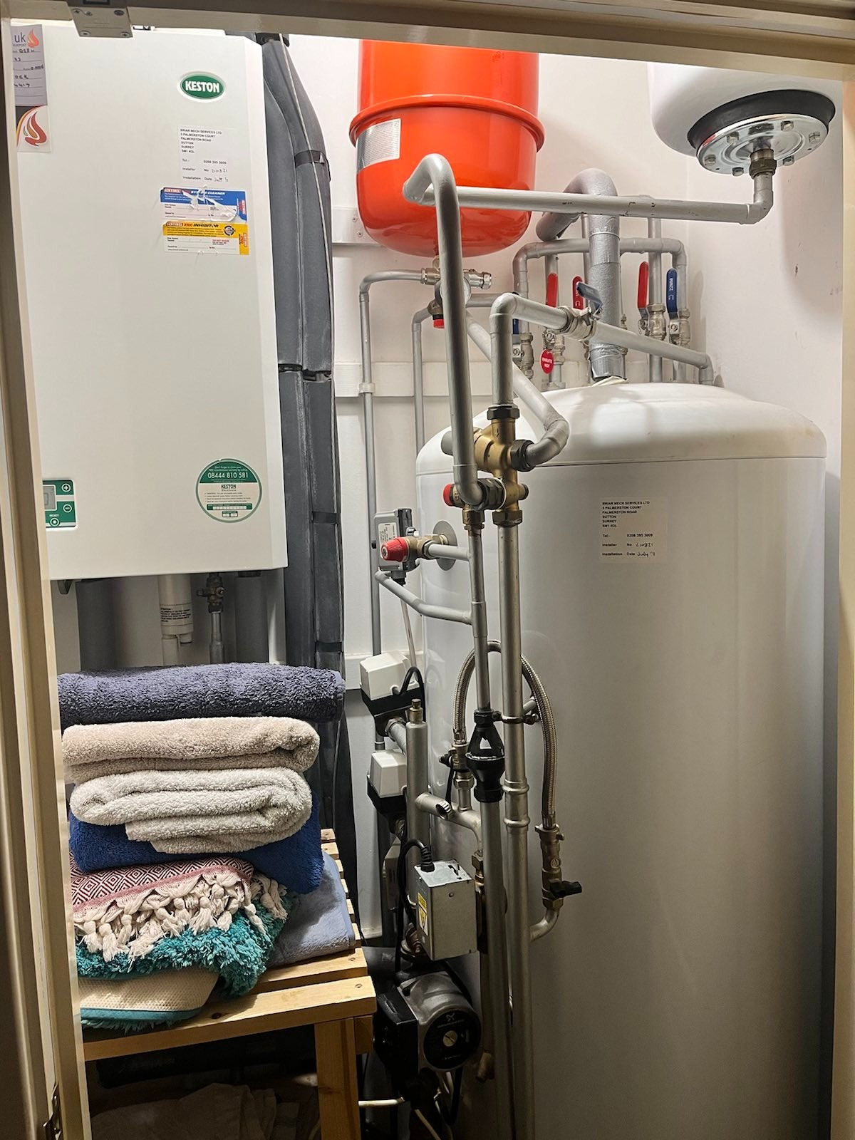

Hi,

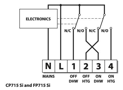

I have recently moved into a 3 story terraced house built in 2011. When I moved in, the house utilised a danfoss heating system that I wasnt familiar with. Inside the airing cupboard (which is situated on the top floor) was a danfoss FP715 Si 2 channel programmer for heating and hot water. On the wall outside of the airing cupboard was a TP5000 Si thermostat. On the ground floor there is a simple danfoss dial to set the temperature. This setup seemed to work ok heating the house and controlling the hot water.

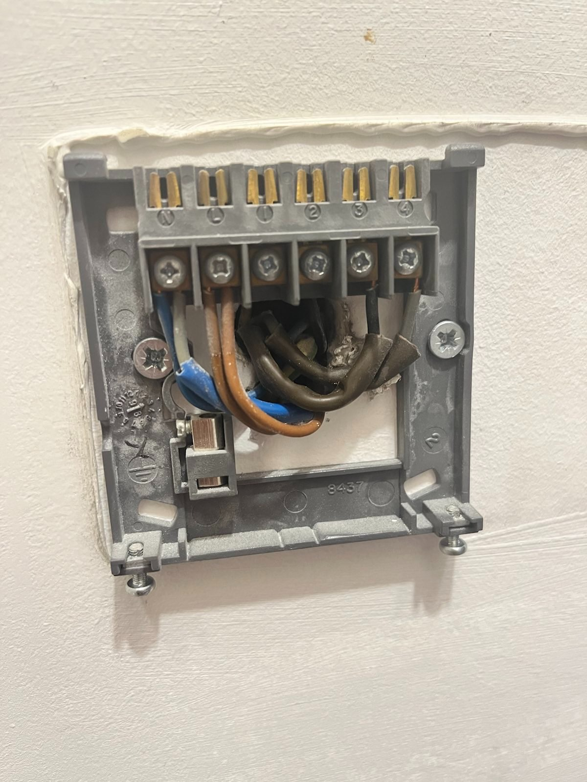

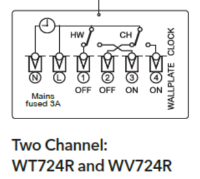

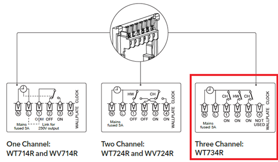

My problems arose when I decided I wanted to upgrade from a fixed programmer to a newer app controlled system. I removed the FP715 inside the airing cupboard and replaced it with a drayton wiser (kit 2). The base plate connections for these two systems seemed to suggest this would simply be a plug and play replacement.
(Danfoss on the left, Drayton on the right)

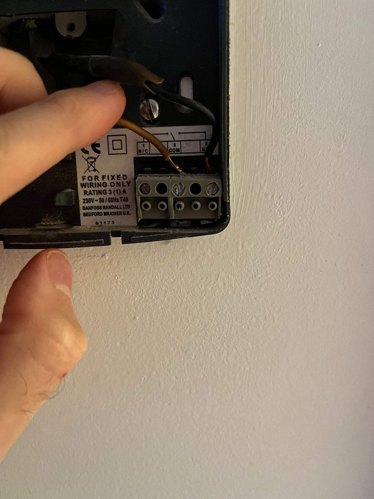

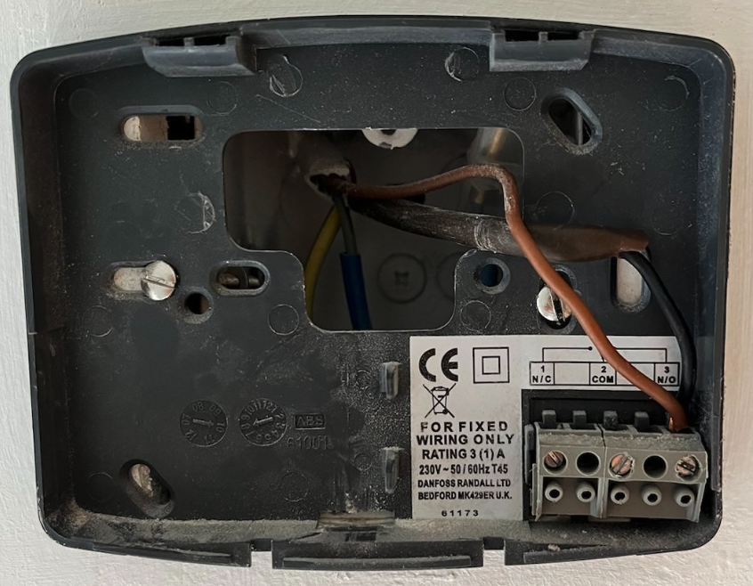

I also decommissioned the TP5000 thermostat by removing the batteries and capping its electrical cables with electrical tape. Once I made this change however, I lost the ability to control the heating to the upstairs of the property. The hot water and downstairs heating continued to work fine. I realised that the wiring that plugs into the TP5000 thermostat seemingly controls the upstairs heating. This was confirmed when I wired the two connections together in the on terminal (shown below).
Once power was reenabled, the heating upstairs immediately came on... but not under the control of the drayton wiser. What do I need to do to the system to fully cede control of the upstairs, downstairs and hot water to the drayton wiser? To my layman knowledge, this sounds like a 3 channel system which would require a drayton wiser kit 3 rather than a kit 2 however the danfoss system is clearly labelled as a 2 channel programmer. At this point im not sure if im 1 simple fix away from solving this, or actually need to do significant work rewiring and paying for an electrician. If the latter, I will simply fallback to the danfoss as I only really want the ability to control via the app. The original system worked, I just had to go upstairs to hit boost sometimes - im starting to kick myself... "if it aint broke..."
Heres a couple of extra details in case handy:

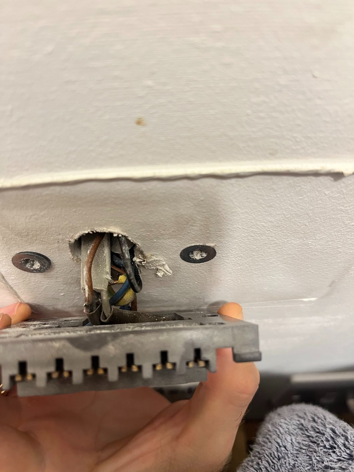

Base plate (no modifications made)
airing cupboard setup:
