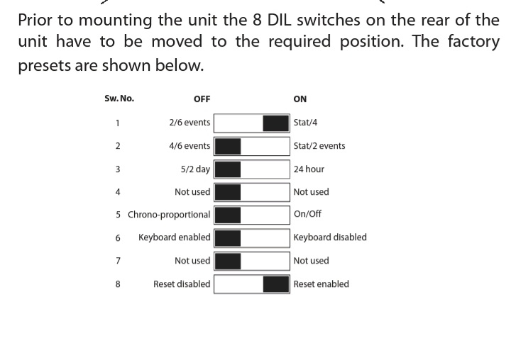

I was hoping someone can tell me how to change the thermostat so we can programme six events per day instead of four? I have tried installer advanced programming but there isn't an option 40 when I scroll through. I would be very grateful for any ideas. I believe it's an old thermostat from 2006/2007.
Thanks in advance.
Thank you so much for your post, I really appreciate it but sadly it was installer advanced programming that I was using as I had already seen the post above and had followed it but to no avail.
I have also found the following manual for it online and it also doesn't mention Option 40 so I was hoping there was an alternative fix maybe...? https://cdn.expertelectrical.co.uk/media/catalog/product/t/p/tp5000si-instructions.pdf
Ah-hah! ;)
Dip switches! :)
