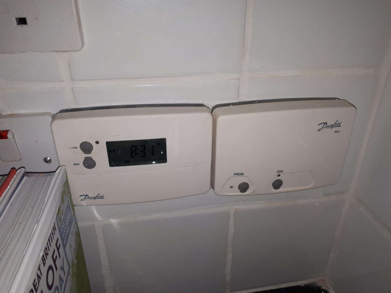

1st post hoping people can help. Moved in to my house in April. Had the boiler serviced and sorted.
It work fine on hot water. But I it has only worked once for the chs. Which was Sunday after I changed the batteries in the thermostat. And when I did this there was green light on (ch1) but now there is nothing. Some posts say to try manually override it but that doesn't work . I know system works because it worked and all tge rads heated up on sundaym but I can't seem to pair the two.now Photo included for.reference
Switch the power off at the mains, wait 10 seconds and restore power. Then press CH1 button and see if boiler fires for heating. It will only run for a few minutes.

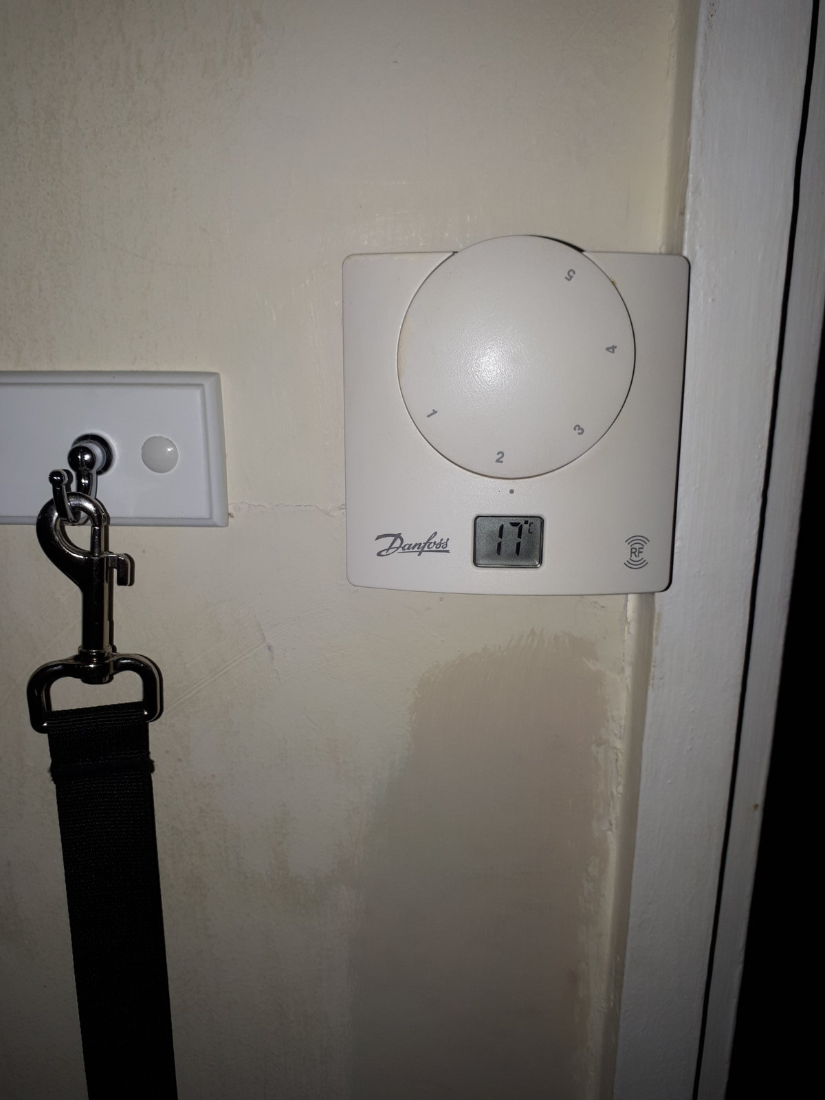

When you are calling for heat ( you do not say what thermostat you have), the red light should light on RX1 to run boiler. Green light only blinks when receiving Rf signal
I don't know the thermostat so I've taken photo. Turned off and turned on again.
Pressed ch1 red light come on above the button Boiler did nothing.
If iTurn off and on then press ch1 then plus 1hour on left hand panel. Boiler started up and temp started rising on the front of the boiler with a little flame and rad icon( vaillant) and rad got bit warmer then the boiler stopped and the icon disappeared After couple of mins. I think it an issues with control panel?
