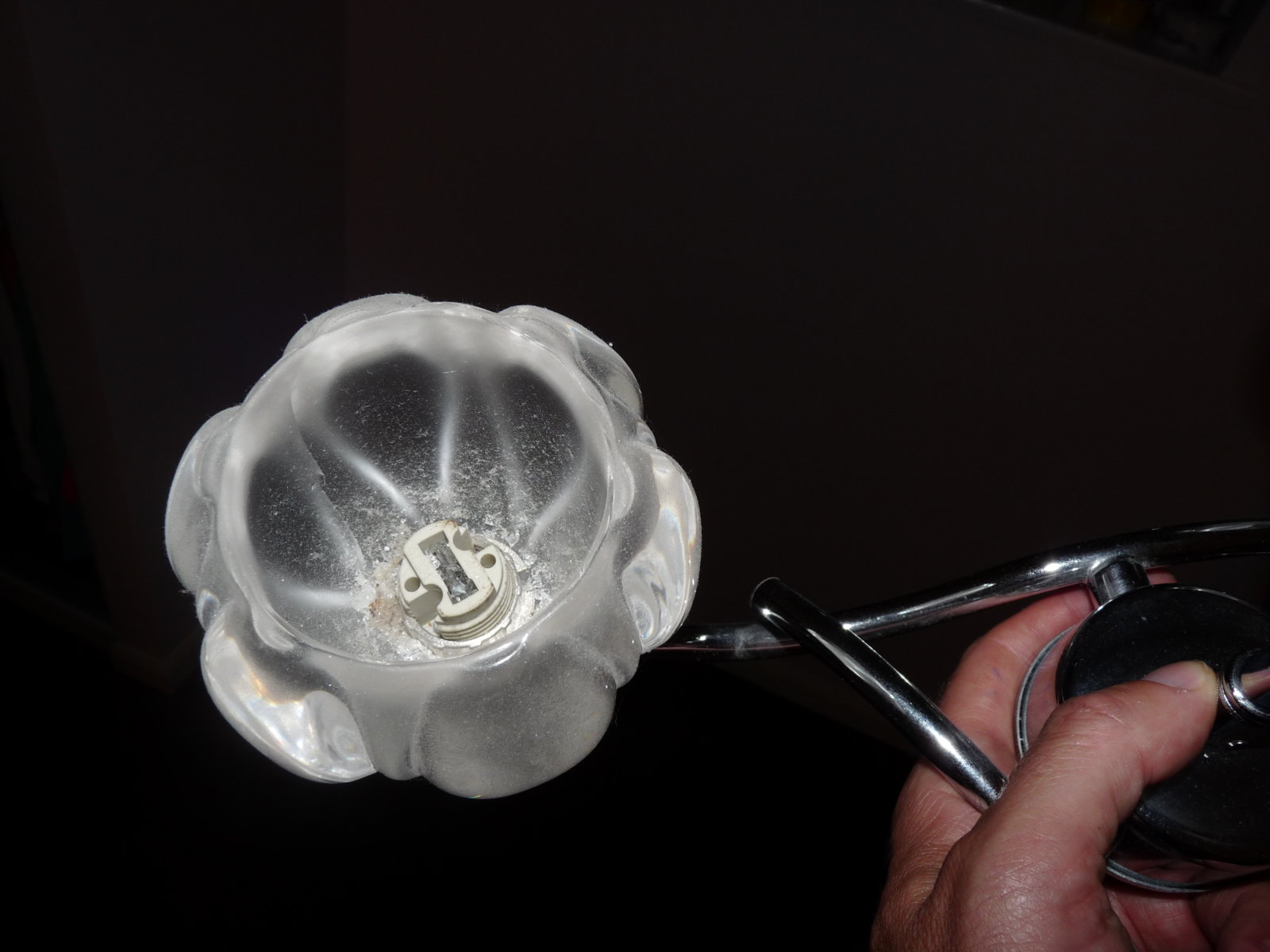

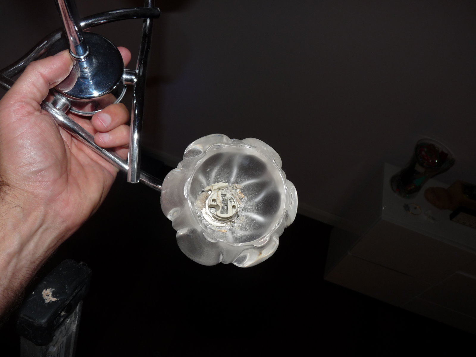

Just checked up on the mess. One blown bulbs has destroyed its fitting. The other is almost embedded (what is left of it). P1050016.JPG P1050015.JPG
60 watt are excessive and run too hot and if the rooms cold that tends to make them fail, though rarely shatter, put in ones about 30 watt, I have never seen smaller wattage ones shatter and fail less.
If not on a dimmer then get G9 led
Its unlikely you will get the wires out with pliers as with A G9 the glass base will be wedged in, usuallly you have to dig it out with a screwdriver without cracking the base
