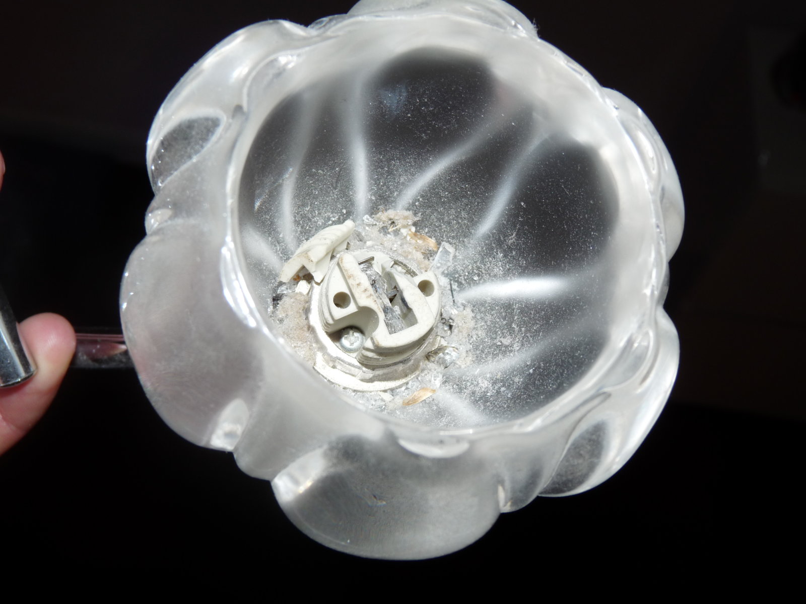

Dangerous fitting or dangerous bulbs?
the base in the second photo has been broken (by the blown bulb).
A mini disaster. I have two of these chandeliers and will now have to peace both of them

There only small fittings just fit new holders, you can get ones with 300mm leads like these, though I cant vouch for these there just an example.
Hard to tell by your pic what you have so check how there fitted, its usually 2 screws.
Buy ceramic ones not the plastic ones and avoid chinese cheap ones
Change all 3 if different height to existing

I can see how the glass does with the fitting in question protect the user from the black UV light, however if it was mine I would not want G9 bulbs. It was not my mistake assuming you were using adaptors you called it a (G9 ES 42w = 60w equivalent) and I simply googled what you wrote.
Thanks 333rocky333 - I didn't realise I could change the base. Here's another photo - do you think they would fit?
I will then buy some LEDs (safer?) - this whole experience has put me right off G9s (that are not somehow enclosed in a fitting)
You would have to dismantle the fitting, in the round base are the connections, the lampholders would need to come with wire long enough to reach there, they are precrimped, if the wire looks hard to thread through the arms then tie a drawwire onto the old one before removing it.
As said some vary in height so if thats a problem get dumpier ones or change all 3 to match, though carefull as Led are longer and you dont want them higher than the shade, Led might look crap with them shades as decent leds only light at the top and the lower half may be a bit darker
To be honest if you get the glass out, them holders will likely be ok, you could glue the ceramic bit back on proberly, it looks away from the electrical contact
