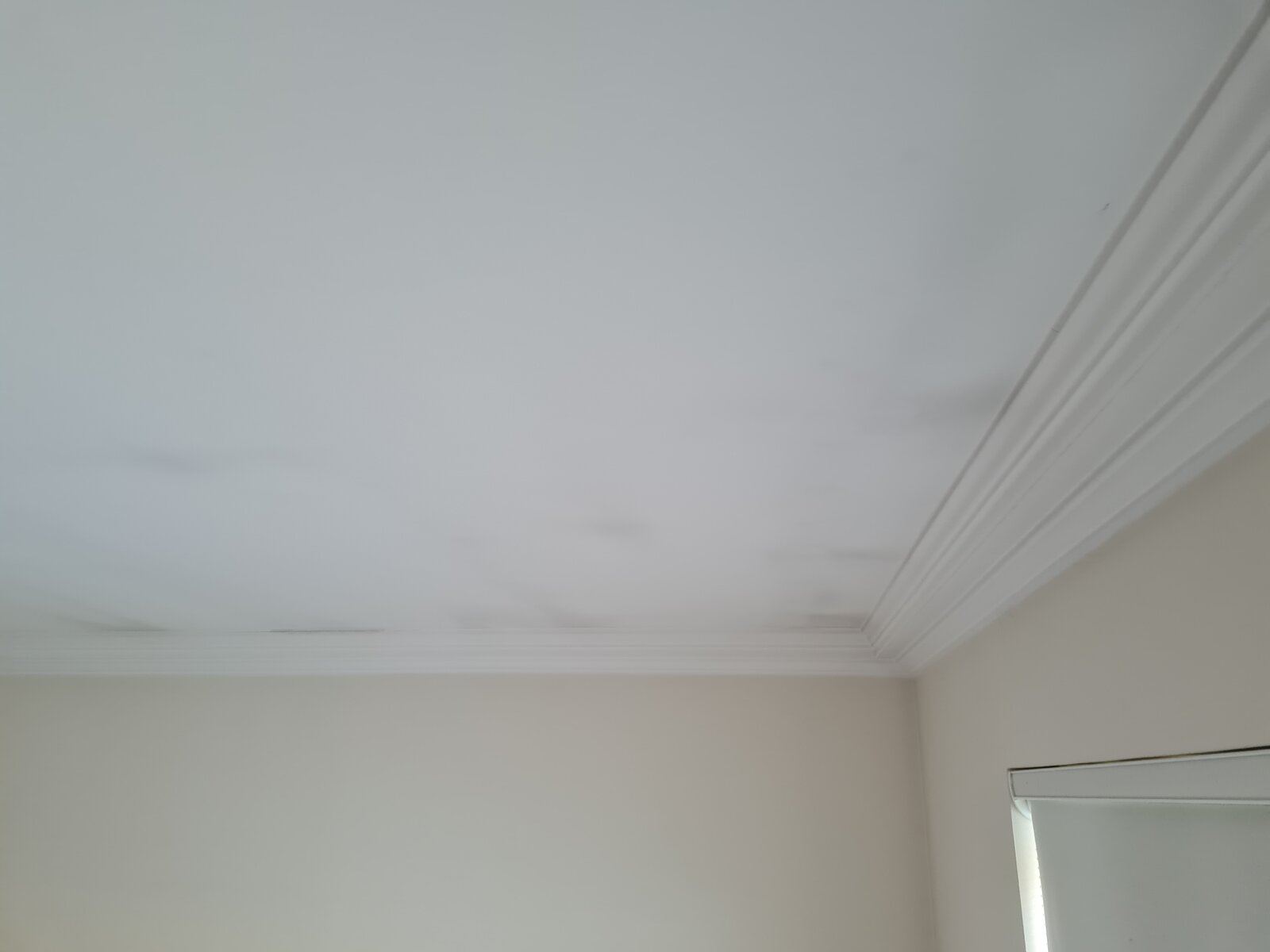

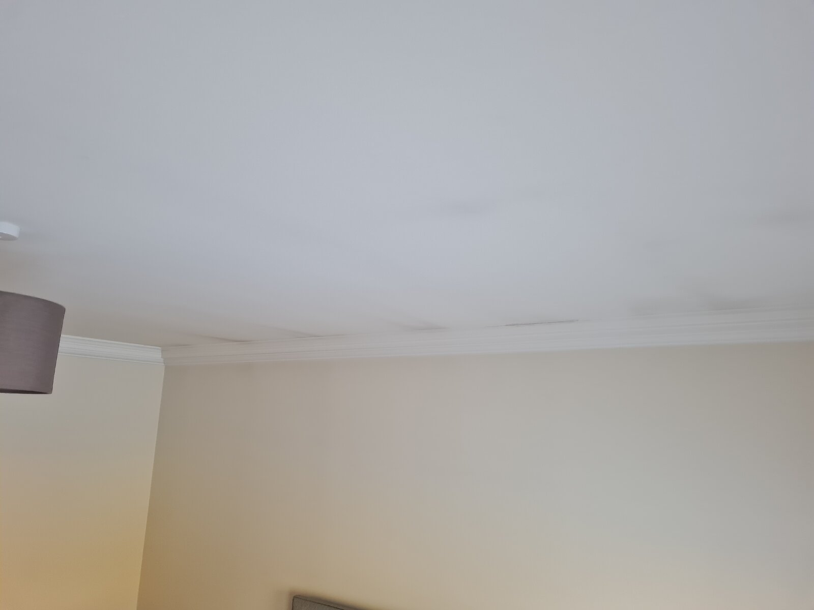

Hi, I live in a 4 yr old bungalow and noticed last night one of the bedrooms has dark marks on the ceiling mostly along the edges. They seem to have just appeared all of a sudden. It is at the back of the house, doesn't get a lot of sun & has 2 outside walls. Had a look in the loft but couldn't see anything untoward. Any ideas?

Pattern staining from a cold spot caused by the joists or lack of insulation. Dust/dirt is attracted to the cold spot. Add more insulation above
Thanks Woody. Haven't any experience of insulation. Should we put more on covering the whole room or just the sides? Any recommendations & will paint cover the marks?
I think the entire attic probably already has the recommended level as the house is only 4 yrs old. What would you recommend as a top up?
But is lit laid properly? What's the cover over the timber, any gaps around the edges?
Hard to tell tbh as difficult to get close enough to check due to sloping roof. Got a roofer coming in Jan to replace some tiles so will ask him to check it out (assuming it would be his line of work rather than a joiner?)
