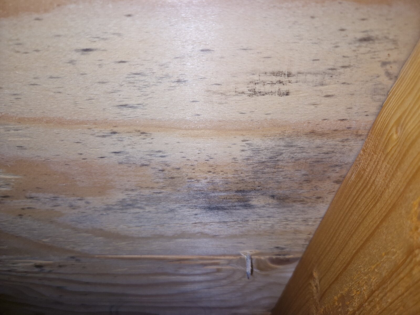

Hi, I've had this dark staining on one of my roof boards in loft for at least a couple of years now. House is 7 yrs old. Its not damp to touch, doesn't wipe off when I touch it and is just a small patch. Is it mould? No signs of dampness in loft and hasn't gotten bigger in the last year (I took a photo back then & compared with this one). Thanks.
Above photo taken today
2nd photo taken 1 year ago.
High moisture causing mould. Air getting trapped.
Watch this and decide how to fix
Thanks Wayners. Roger does make good easy to understand videos. It all makes perfect sense.
