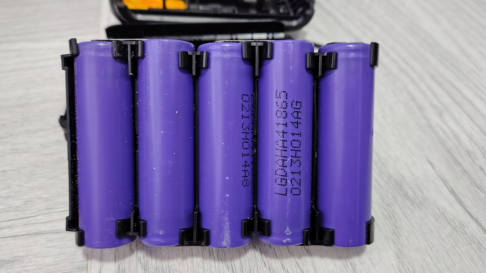

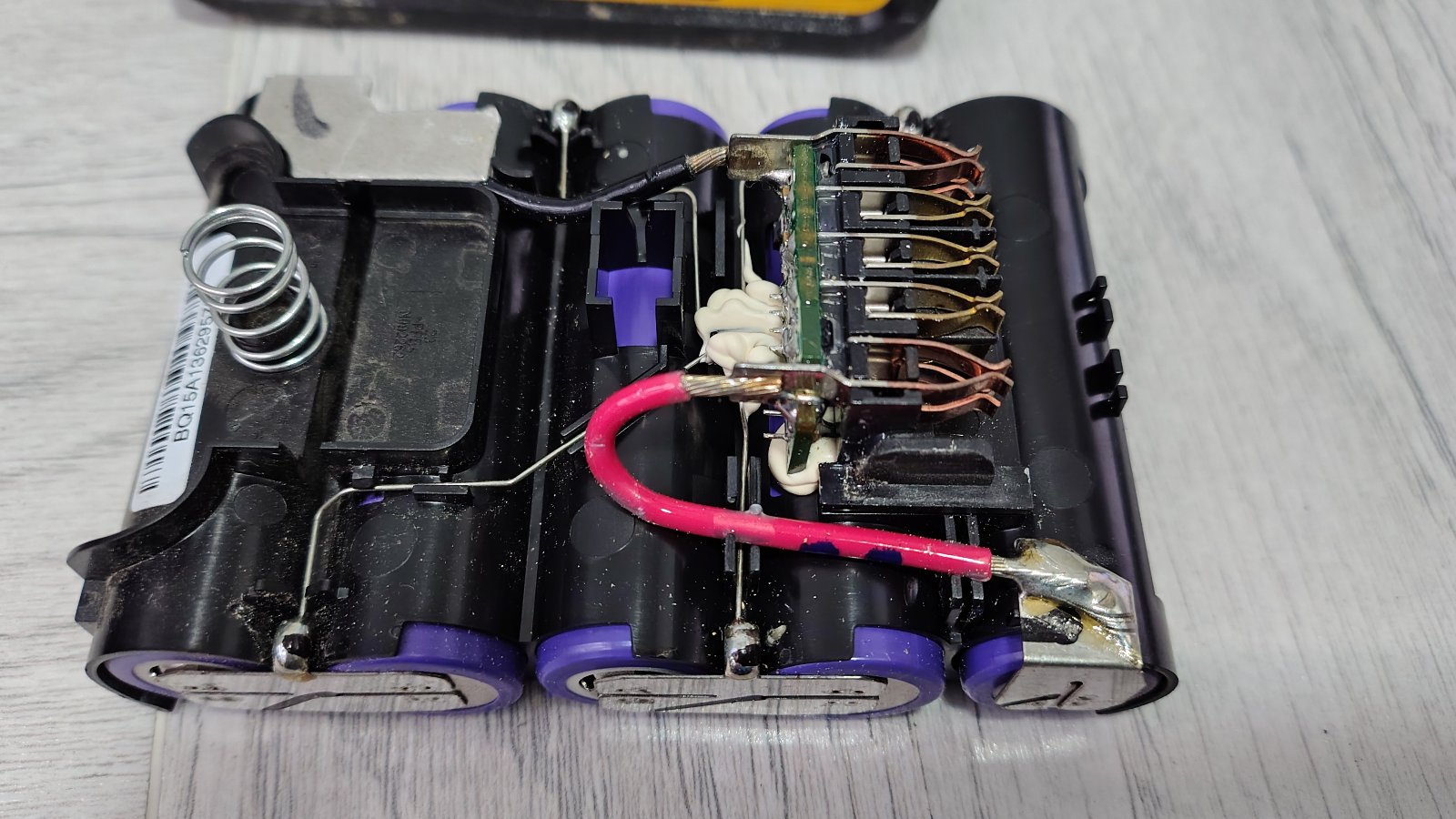

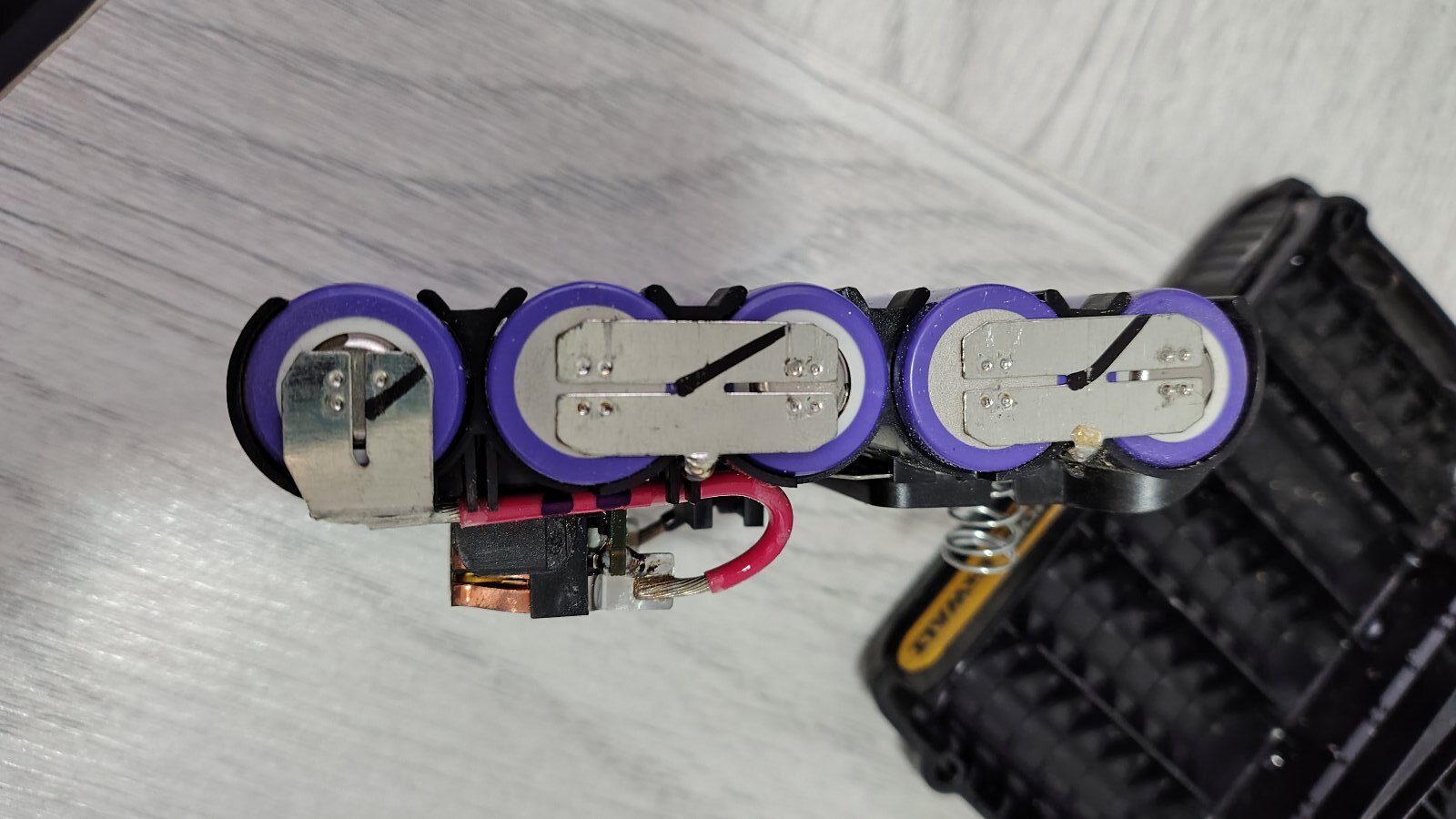

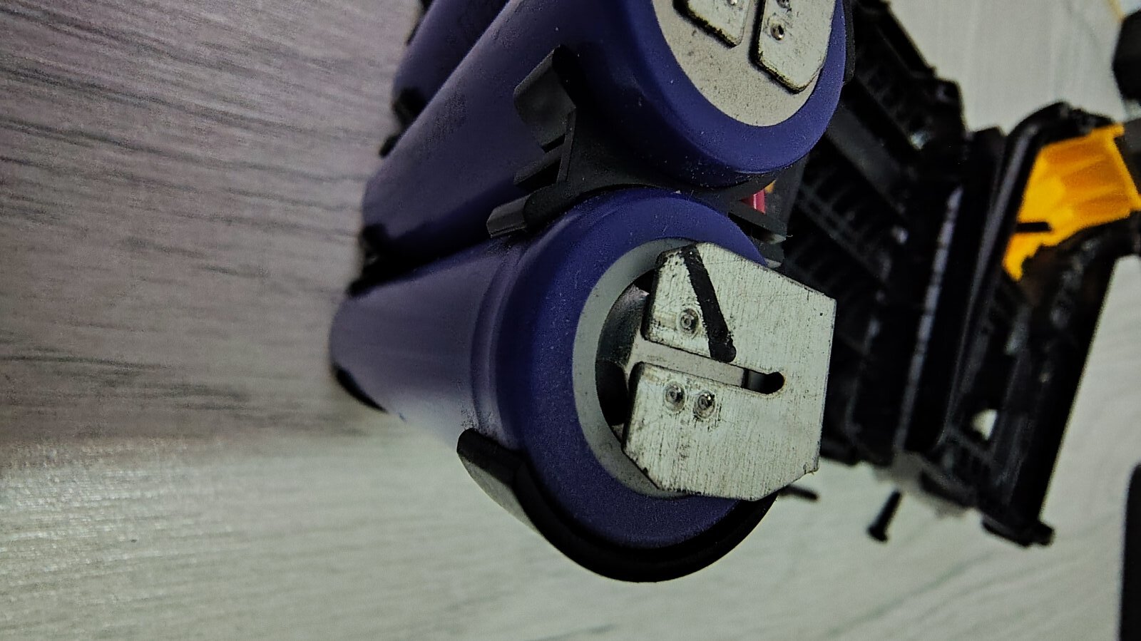

Ok thanks I have taken it apart and can not find any kind of valve, tried pushing down with a screwdriver but just ended up slipping and stabbing the work top
Those cells, are 18650's, a standard cell, and cheaply replaceable, if you are so minded. There is no valve that I am aware of, simply a design weakness in the case, to allow the case to burst under pressure - rather than explode.

I was hoping for a magic hissing valve but could not find one - and now I have a stab mark in my work top

They are wired together, in series, to give to 20v. You can still check the voltage without disconnecting anything, putting your probes across the top and base of each cell in turn.
