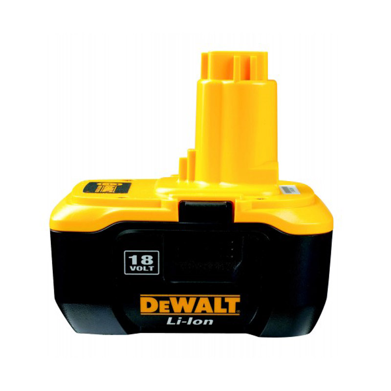

Is your tool the older XRP type or the newer XR, both the tool and battery will have this on. The older XRP tools were backward compatible when dewalt discontinued the old ni-cad XRP battery and briefly introduced an XRP lithium battery, think they called it the 'nano phosphate', this new battery had the same fitment and would power the older ni-cad tools after all a motor is a motor doesn't matter how it's powered. However though to complicate things even more the old ni-cad charger was not forward compatible with the lithium nano battery but a lithium nano charger was backward compatible and could charge an old ni-cad, the technology was within the charger and would sense which battery was on charge, eventually though dewalt changed the way the battery went on, this line of tool was the XR, an old XRP battery whether ni-cad or the lithium nano phosphate will not fit the new XR tool.
Old ni-cad....
Old nano phosphate lithium....
As you can see the fitment is the same so the newer battery would fit the older tool.

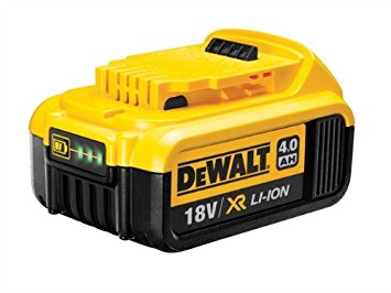

The latest XR battery....
This battery will not fit the older XRP tools, will only fit the latest XR line of tools
Hope this helps!

My drill has xr batteries so same fitting as the grinder I'm after. My concern was the difference between my slide on early xr batteries which are all black and the newer ones like your pic above which are now yellow and have the power meter on them.
And now there is also flex volt to add to confusion!
The black and the black and yellow are all compatible I'm led to believe. The flexvolt 54v/18v will fit to, the battery senses which tool it's in and makes the necessary adjustment between voltages, bloody clever stuff from dewalt at the minute, I have the 54v grinder and it's a beast.
