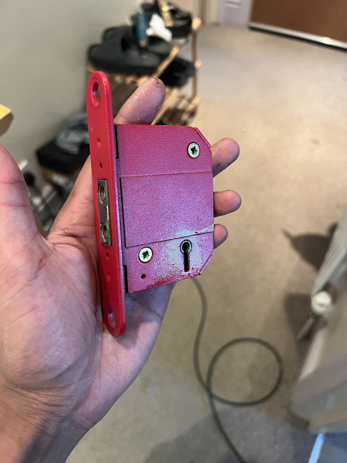

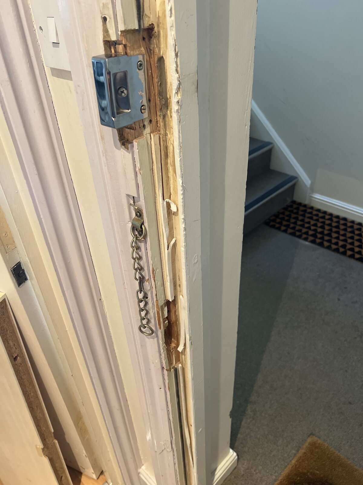

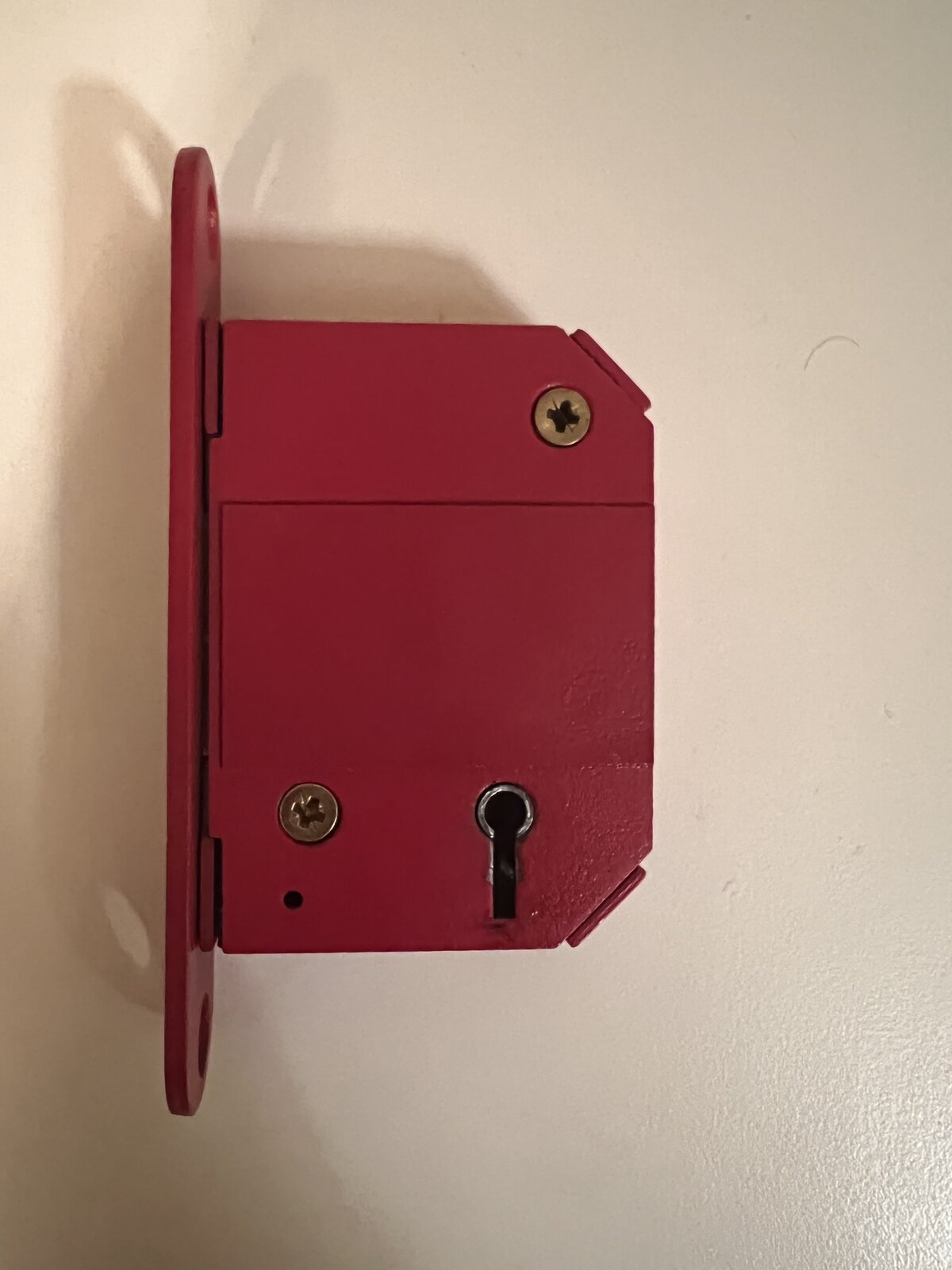

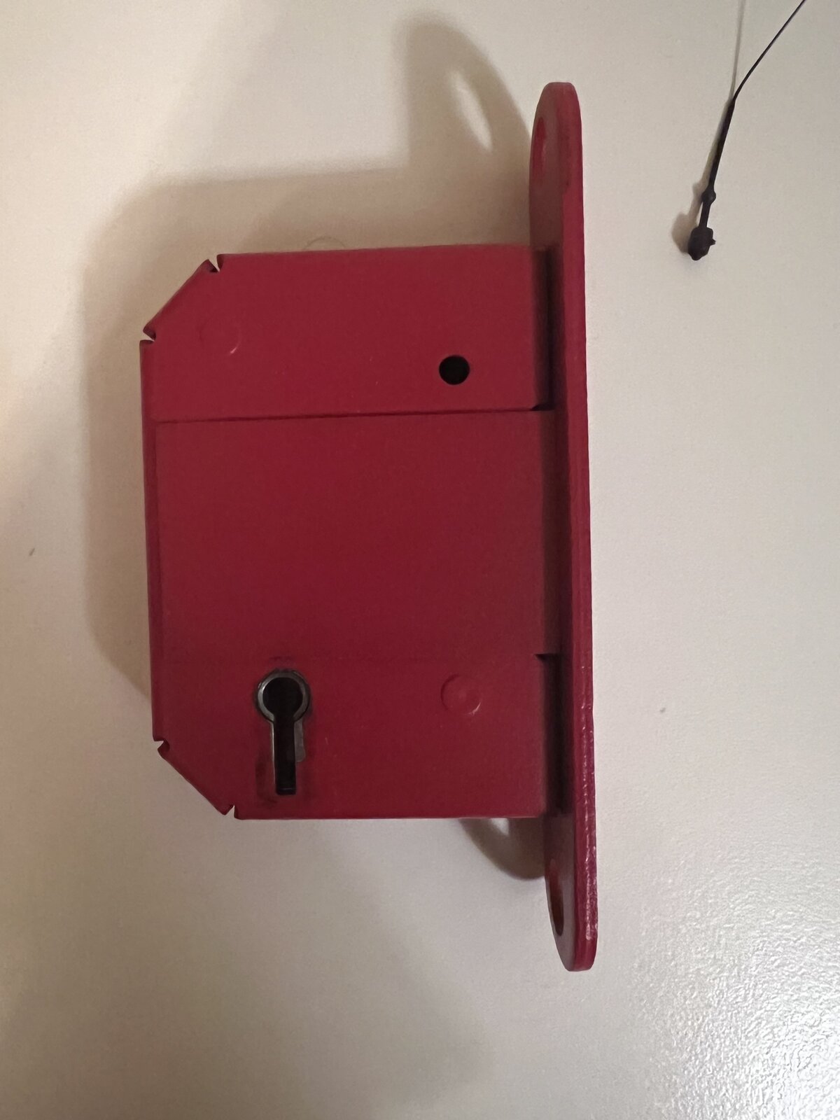

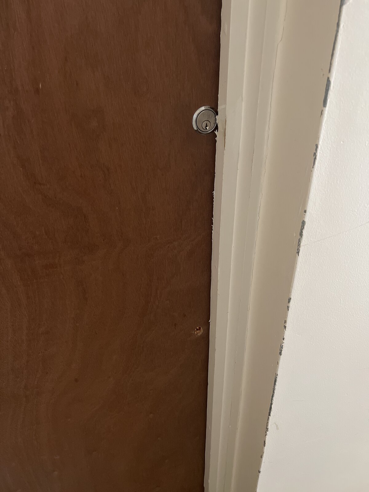

Hi all, I am in a block of flats.
My current flat entrance door is wood (rejected to replace with pvc) and I am using a Deadlocking night latch.
However in the middle I have a 3 lever deadlock that sometimes works (last time was today which resulted in my using WD40 to get the lock to open) - which I am looking to replace, but I can’t find the right replacement. I have gone to screwfix, and what I thought was the replacement was incorrect, as the holes on the door did not match the key entrance on the lock.
Does anyone know where I can buy a like for like? Also Is deadlock the right replacement?
I have attached some pics.
thanks all

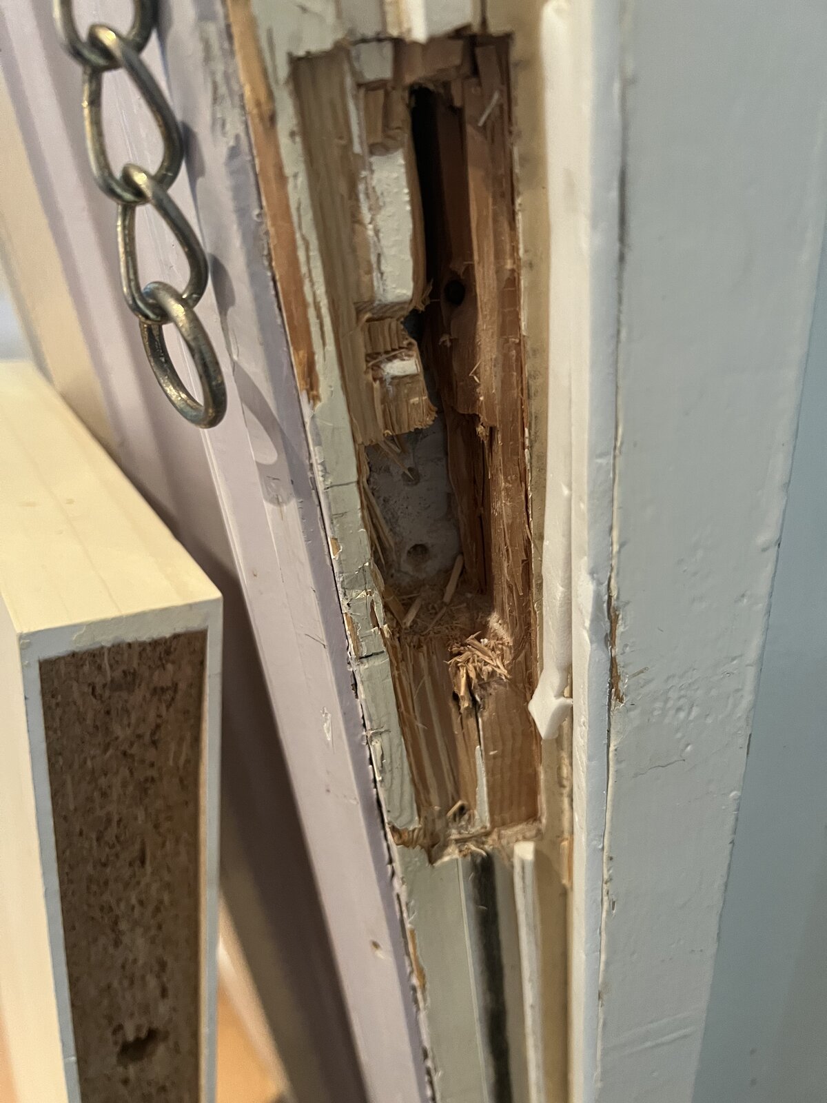

From your photos it would appear the lock face plate is missing. The door lining is badly abused where the bolt enters and could do with repairing or replacing.
To replace the 'Mortise' (dead) lock you need to know the size : measure the distance from the centre of the Keyhole to the faceplate. (typically 1&3/4 or 2&1/2inch). Unless you know the name it is unlikely to find a lock with matching retaining / screw holes.
For insurance purposes you should fit a 5 lever lock.
That door casing is unrepairable. It needs to be replaced. If this was a break-in it needs a Birmingham bar on the back of the door casing when a new one is installed
If you have still got the old lock and key, please post photos of them
Also, please measure (precisely) the width of the old lock case (probably about 2 and a half or 3 inches) and the backset (distance from the front plate to the centre of the keyhole) and the height and thickness of the case and foreend plate.
Old locks will probably measure in inches, to a quarter or eighth inch, modern locks in mm
There is quite a good chance I can identify a match.

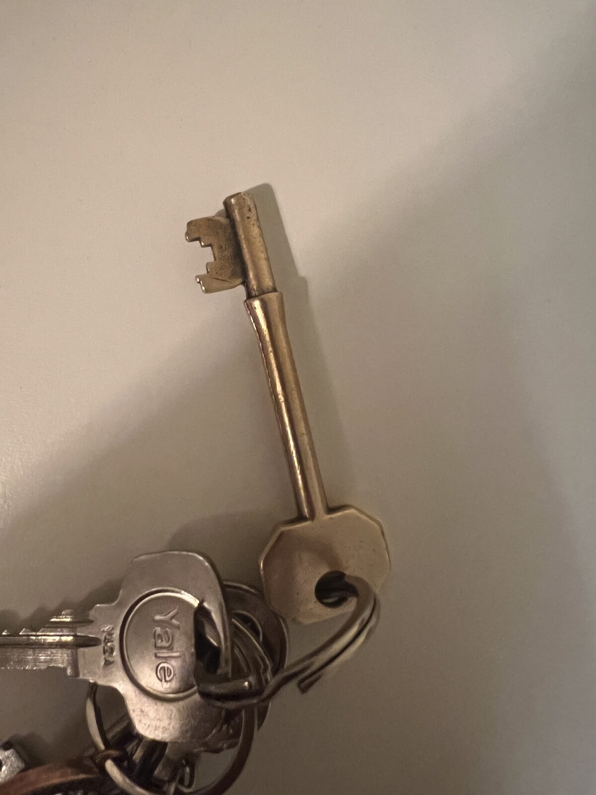

BTW when an old lock becomes difficult to operate, it is often because the key has worn out of spec, or is an ill-fitting copy. With a lever lock you can confirm that by trying the key from the other side of the door. When testing unreliable locks, always do it with the door open in case they jam.

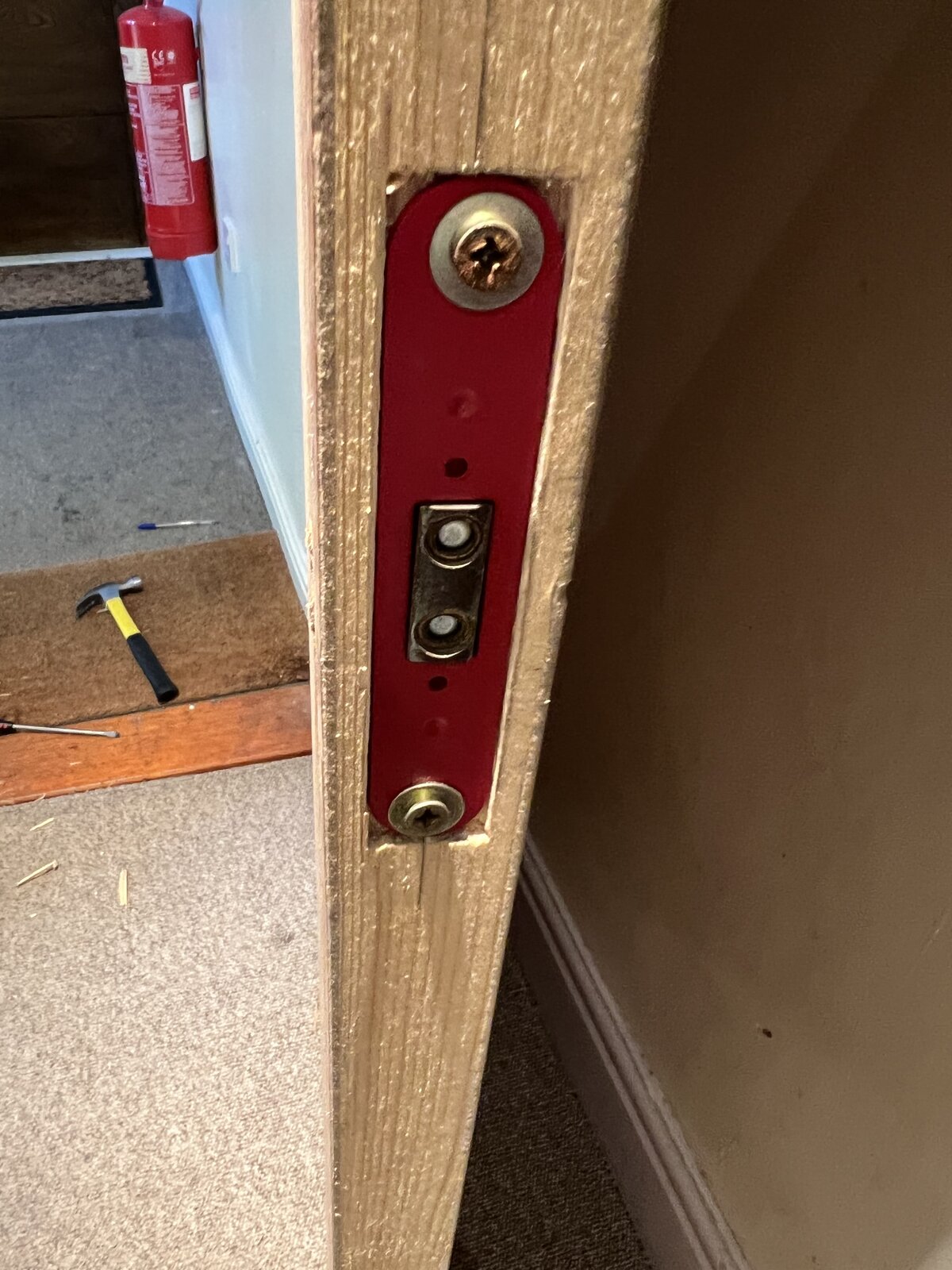

You say you are in a flat. I observe your door lining has the remains of intumescent strip.
You must have a fire-resistant door. Not a plastic one. They need not be very expensive, starting around £80 before Covid. But they are very heavy (enough for a hernia).
If you are going to paint it a moulded one is fine, you do not need costly veneer. Avoid the fake woodgrain, which looks like fake woograin.
Examples https://www.wickes.co.uk/search?q=fd30+fire+door:price-asc:category:1000659&text=fd30+fire+door#
Fitting a door needs skill, experience and sharp tools, so ask around for a competent local carpenter. Ask what he knows about fire door regulations. The rules change quite often so I can't advise here. There are special hinges (I recommend the lift-off type), smoke strips, and pads for the locks and hinges. As they are very thick and solid, they block sound and are quite good at resisting forced entry, with good locks and a good lining sealed to the wall.
A new door lining to match is little extra cost and will give a much better result.
You can temporarily reinforce your old lining with something like
https://www.ebay.co.uk/sch/11700/i.html?_from=R40&_nkw=kickstop&_sop=15&rt=nc&LH_PrefLoc=1
If you can drill holes accurately
But you really need a new one

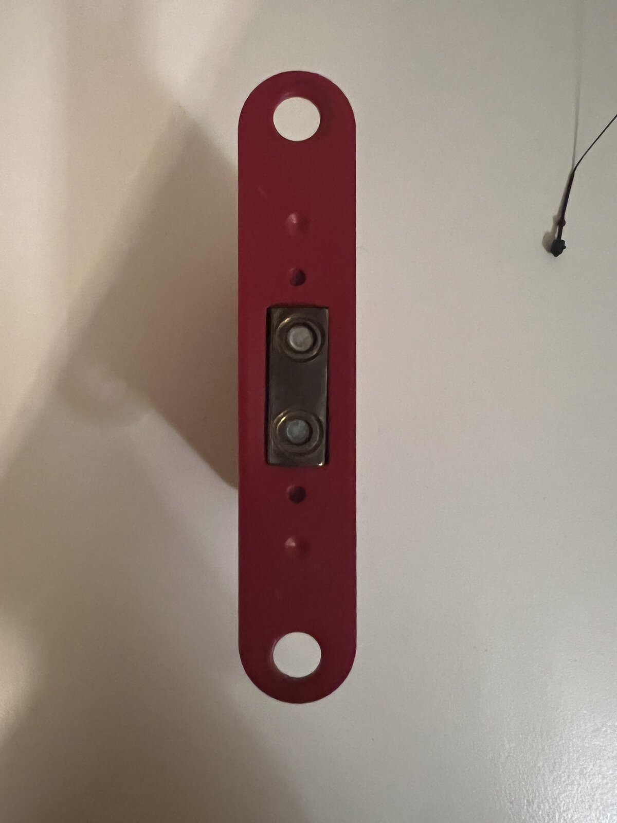

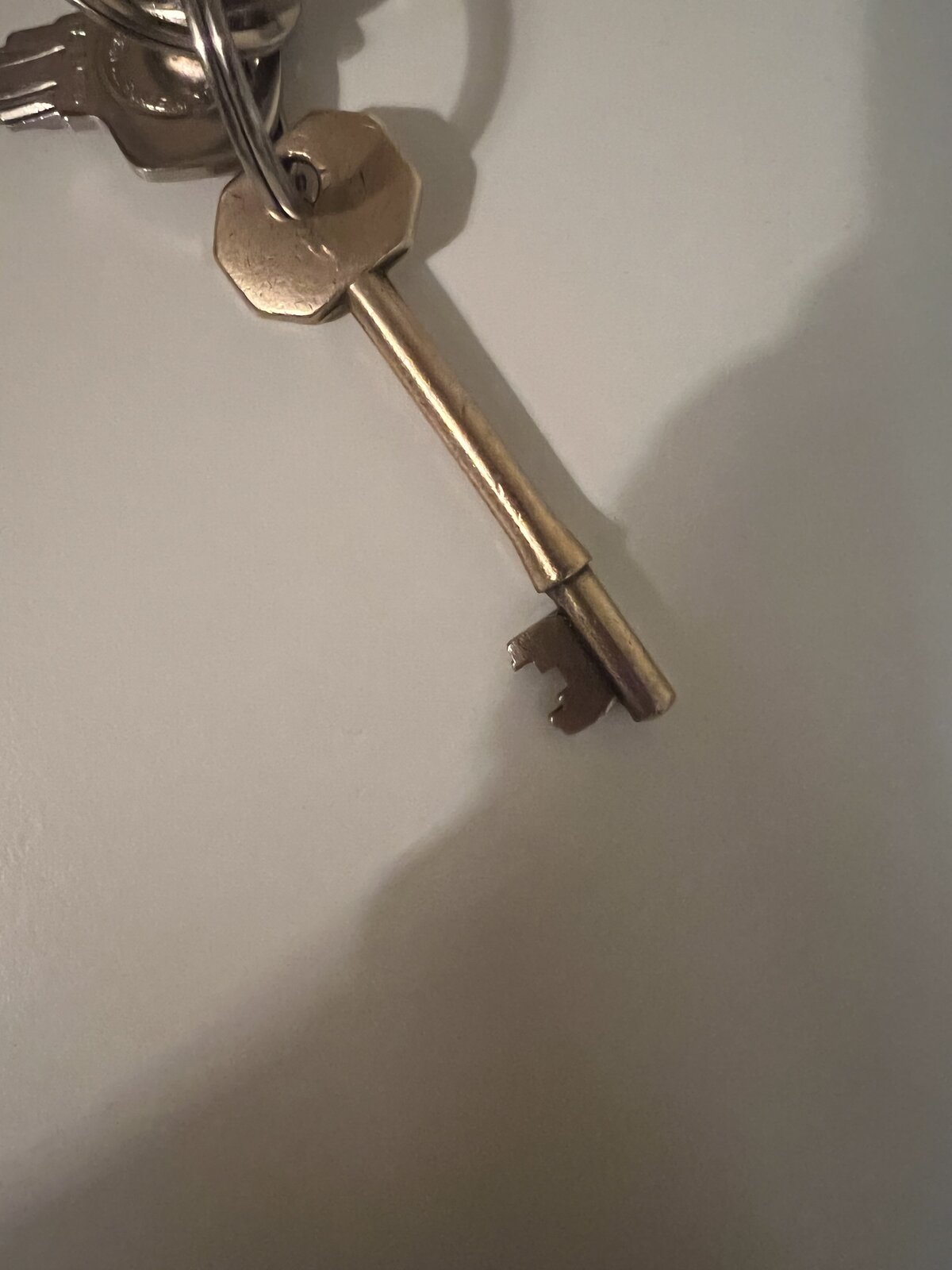

Hi John, thanks for the detailed comment! the images as requested are attached.
Measures are as follows:
Width of the old lock case: 6cm
Basket: 4cm
Height & Thickness: 8.4cm (h) 1.6cm (thickness)

The door installed is a fire door, it was a requirement of the managing agent however the installer did not install an intumescent strip (i will chase)

Yes, your key is worn out. Observe the bits are rounding off. It may work better from the inside of the door than the outside because the key has two sets of bits (observe they are always symmetrical).
The dark red paint colour, and the shape of the key, look like a fairly modern ERA 5-lever. Union are also red but a little brighter and the key shape is different. Though your key might not be original.
There are only two rollers in the bolt, so it is not the current standard, but the case size is probably the same.
Does it measure like
Case size 64x89x17mm with 44mm backset? Be precise.
The similar Union is 68x88x16 with 45 so you must be accurate.
The modern standard has a bigger bolt so the staple (keep) may need the door lining hole made bigger with a very sharp chisel.

John thank you so much! it does measure like the second ERA one, I have reserved and will be picking up shortly I will let you know :)
the strip is incredibly easy to fit yourself and not expensive. A proper lining will have a groove for it, width varies, measure yours before purchase. Unless the door is a very close fit you can use the strip with smoke seal, which is a sort of furry brush that looks (and works) like draught excluder.
It is self adhesive. Fit it AFTER painting and any trimming needed.
For a single door you will need just over 2 strips.

Thanks John, I will look into getting the kickstop and also the strip, also both the Era locks you recommended did the job! I am just having trouble with the box striker :(
yes, the new one will be bigger.
you need a really sharp chisel, to shave away the wood. don't use a hammer or a blunt chisel.
a sharp one will cut it away just with your hand.
about a 3/4" if you need to buy one
