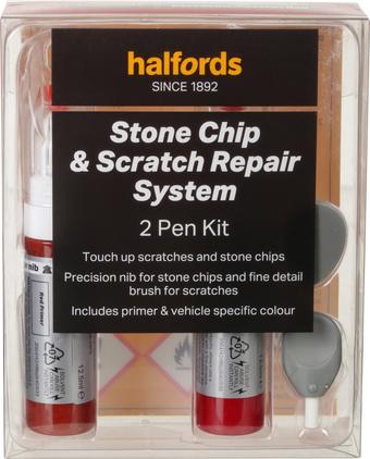

You need to scrape out any rust first, otherwise anything you put over it, will just keep the existing rust nice and warm, but it will carry on, because oxygen can still get through the paint. Maybe post up some photos, so we can see what we're up against? You can buy fibreglass "rust pens". They just have stiff, glass bristles, and are good at grinding loose rust out of small areas. Once you're back to bare (but still slightly brown) metal, put a drop of rust converter on there. Again, places like Halfords sell it. Lost of manufacturers, but basically, all the same stuff. You only need a tiny amount, so one of those "Tip-ex" type bottles would do it.
Then when that's dry, some primer and paint. Again, if it's a relatively common car, Halfords might well have a double-ended, touch-up pen, thing with primer in one end and the right coloured paint in the other. You might also need some clear lacquer to go over the lot, depending on the paint finish for your car.

For small spots or scratches, I find a tiny dot of paint with a fine artists paintbrush is less eye catching than a larger repair.
P.s.
The brushes in Halfords and similar paint kits are awful.
