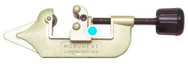

I was an apprentice plumber before pipe slices were invented and we all used these
The pointy end was to deburr, which only needed a few turns in the end because these cutters, if used without excessive twisting on the knob, don't round the pipe and hardly leave any burr. Now we have these pipe slices and there is no way that point would deburr what the pipe slice leaves.

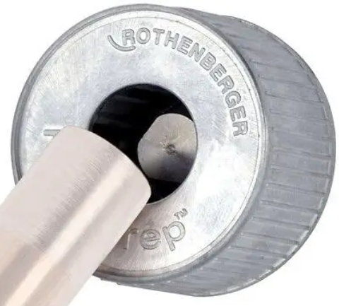

They round off the pipe so much thats it practically impossible to deburr fully without losing a few mm from the pipe length and creating a razor sharp end to the pipe. You're not just trying to take off a burr but removing the bent inwards bit of pipe. I got one of these to try - Pipe Prep, supposed to push out the Burr rather than cut it off.
It doesn't work even on pipe cut carefully with the old style cutter but no way would it push out the rounded pipe from using a pipe slice

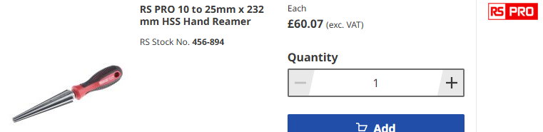

But I wouldn't be surprised to find this type with the shallow angle is good as well, if not better
