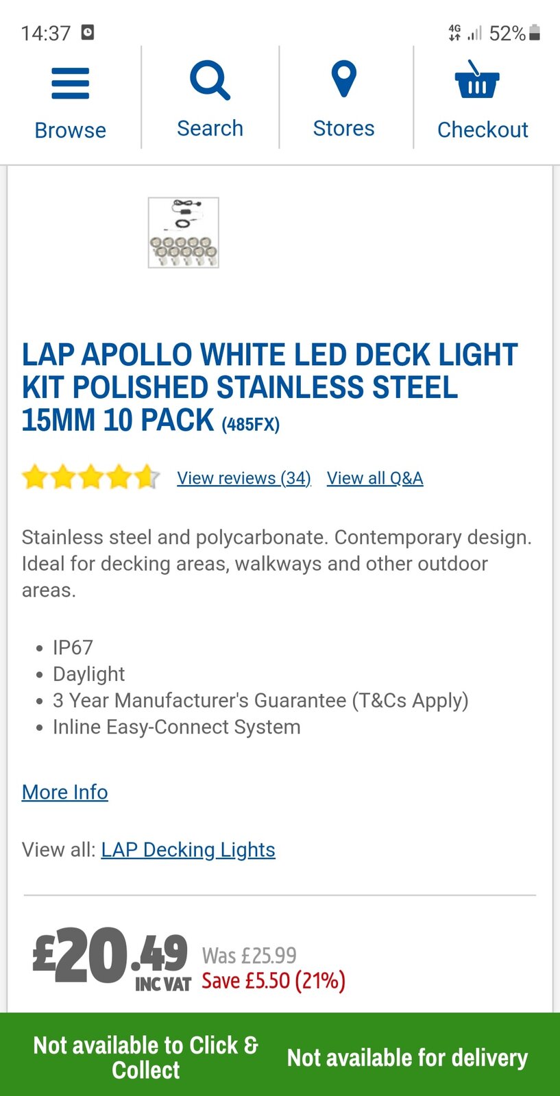

Hello does anyone no if i can buy 3 lots of these decking lights and keep connecting them together as this 10 pack is not enough to go round the garden

In a word no. They would all need to be plugged in (or terminated ) in a water proof enclosure. You can not just 'daisy chain' them.
It that was what I wanted to do, I would have a junction and split one set left and right of it along with a cable to another junction/socket to a third location for the third set. Since the power supply is separate from the plug, I would chop off the plug and just use waterproof housings for the connections.
Each pack of these lights comes with 1 plug, 1 transformer and 10 lights. You can have a maximum number of 12 lights per plug/transformer, so you can add 2 extra lights per kit. Anymore than this and you risk overloading and damaging your transformer.

No, not using a single supplied voltage supply as it does not provide enough power (Watts).
The lights are 12V DC.
As 10 lights need 2.6W then
for 30 lights you need a 'LED 12V power supply providing 2.6W X 3 = 10W or more (the extra is to stop it overheating and maximize its life).

Sfk so if someone wants 30 or more lights around there garden what can one do?
You would buy three kits.
Each kit comes with a driver.
Every driver you have will serve 10 lights.
You would provide a 240v supply to feed each driver.
Surprised no one else has mentioned this.
You can use a LED 12V dc power supply providing 10Watt or more power. And then all 30 connected together on after another. (Far ones might be dimmer)
Issue is that you have to be capable to put it in a waterproof box and wire it to a 240V plug.
