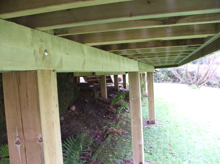

Hi all
Just starting to plan a new bit of raised decking at the bottom of my sloping garden.
The slope is such that at the bottom of the garden, the deck will be around 5ft off the ground with the top end level with the ground (not connected to the house though).
I am after some advice for post spacing and joist spacing please. The deck will be around 6.5m wide by 3.5m deep. It is the 3.5m dimension that will span the slope. I was going to have a double bearer at the bottom end to allow the joists to overhang at that end.
So:
1. What support post sizes and spacing would you use?
2. Would you concrete these in (how deep?) or make a concrete base and surface mount?
3. What joist size and spacing would you use?
I've got some ideas from the attached pictures but any advice welcome for this planning out stage.

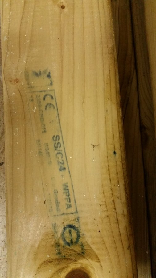

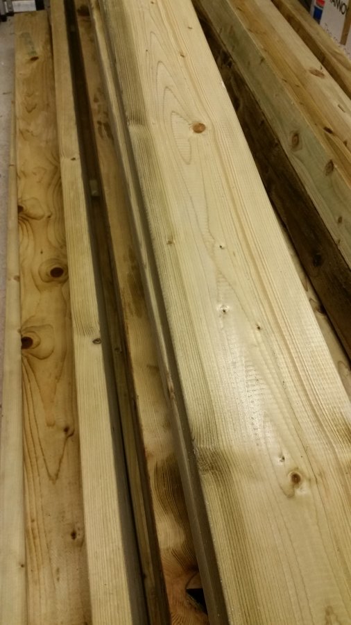

Does this wood look pressure treated for external use to you?
hard to know in a dark photo like that. Although very rarely do i see grading stamps on treated timber but that may just be a regional thing. You can get vac vac treated stuff which is treated for use in sub floors etc indoors which is a yellowish colour rather than greenish and it would be graded.

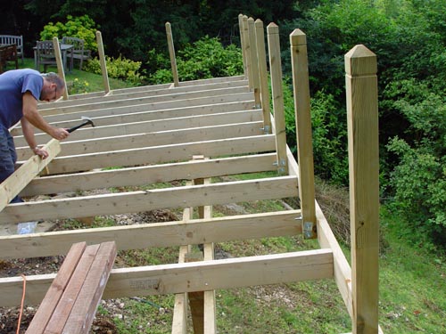

Subframe finally built.
Im after some advice regarding fitting the newel posts to the sub....
Do these really need to be notched to the subframe? What are the advantages to this rather than just fitting with a few coach bolts?
Seems a lot of work, whats the best method?
They dont have to be notched. They are usually notched so that they are brought into the desired edge line rather than having them inside the joists and therefore inside the edge of the deck.
