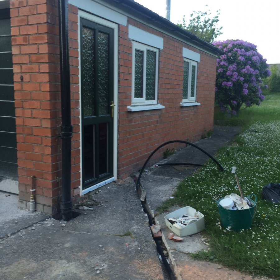

I'm looking for some advice - photo attached. What should I use to best fill in this track in the concrete out my back?
Track currently holding electrical cables for garage.
Would Post Crete be the best thing?
Thanks -
C
Mix your own sand and cement, mate.....postcrete goes off at the speed of light and it's bloody awful to trowel. Add some small pea gravel to your mix if you like.
